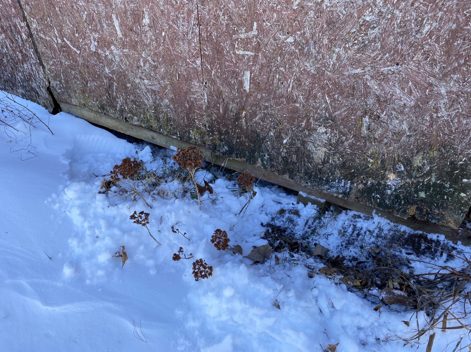

I want to move my 12x16 shed on my land. Unfortunately I did not build it with skids under it. I’m debating on ways to put skids under it so I can drag it.
I also need to remove a back lean-to shed from it first.
I put skids under an existing building by lifting 1 side at a time and sliding 4x6 skids underneath. I used lag bolts from the floor inside to secure in place. I also cut the end at a 45 halfway on the ends of the 4x6 to make it easier to drag. I drilled holes in the ends to drag by the skids instead of destroying building.
Worked well and not a big job.
   / moving a building #46
That’s my thinking. But first I have to unattach a lean-to off the back.
I believe I used 12 ft 4x4s front to back every2 ft. The back is raised up on blocks, think I can easily slide a skid under back side.
I think I put two 8 ft 4x6s longways the 16 ft direction, that the 4x4s sit on. These are back and middle If I had used a 16 ft one instead it would have skids.
I need to look for pictures when I built it.

So much stuff to unload from shed, with no place to put it.
Ground hogs live under shed, so the clear space will be blocked with dirt.
If I get it moved, I will reside it. The 24 yo OSB is rotten at bottom.
