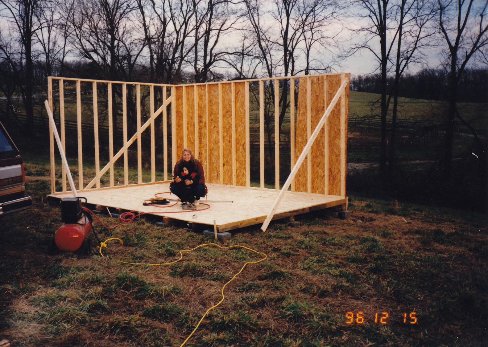

Shed was started in late 1996 as I was waiting for my building permit for my house.
Unfortunately, I did not put skids under it. It has pt 4x4s floor joists running every 2 ft apart in the 12 ft direction. Those sit on blocks in the front. In the middle and back there are two 8 ft pt 4x6s running the 16 ft direction, on blocks to support the floor joists. If I had used a solid 16 ft here, it would be a skid. I believe I can push or pull a 16 ft 6x6 skid under the back side, and lift the front side to put a skid under it.

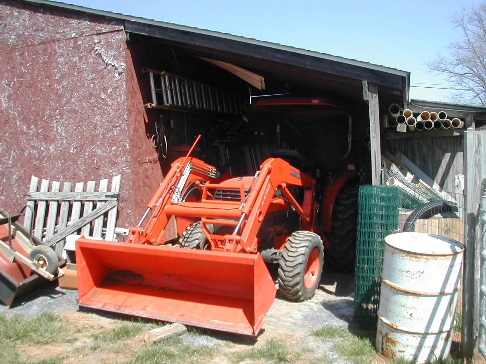

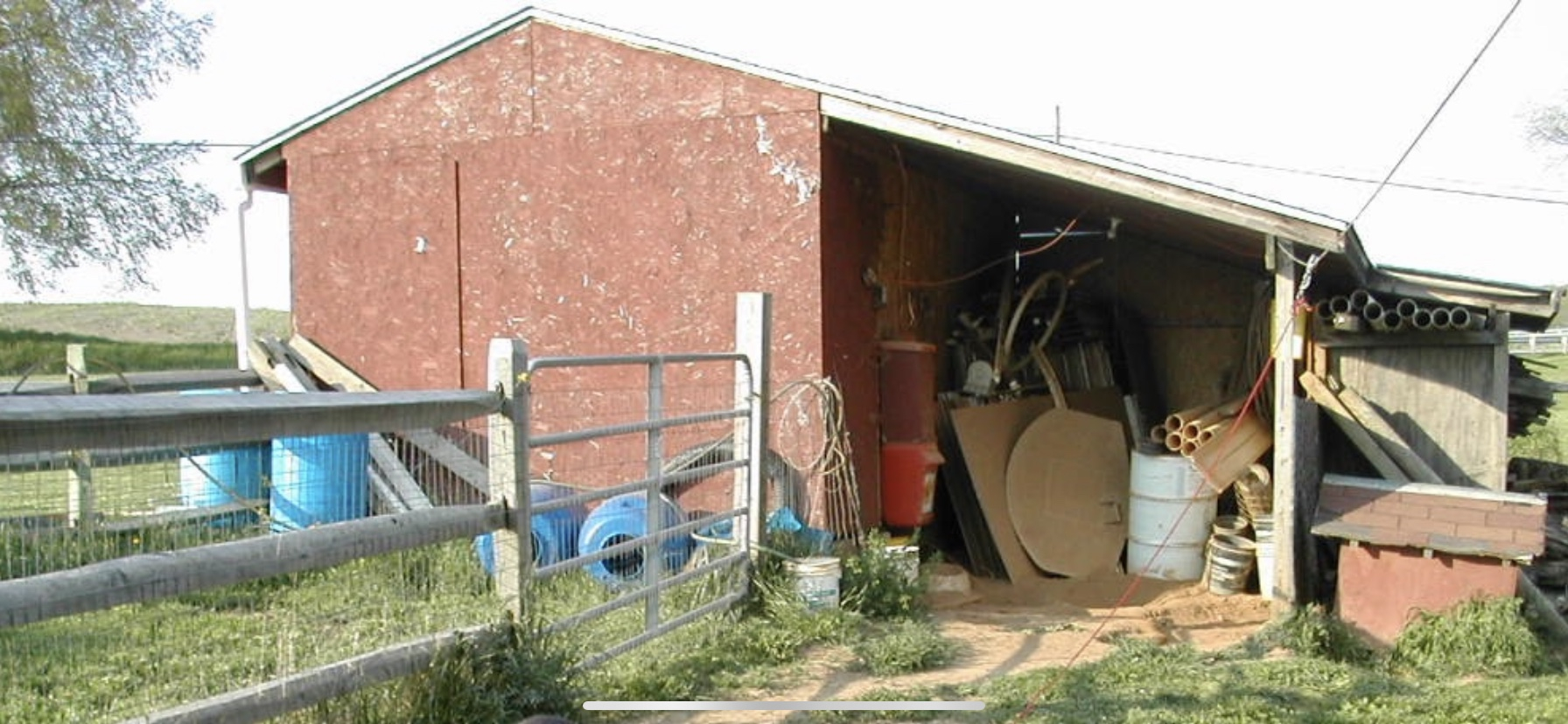

As seen in the first picture, I added a 16 ft long by 10ft? Wide lean to off the back of the shed. To move the shed, the lean to has to be unattached.
Before I built my barn, I dug enough dirt out from under the lean to so I could park my former L3130 tractor under it.
I used to park my little Massey tractor in the shed, and might again.

Been lamenting how to remove the back lean to. It’s a nice shingled roof. I can cut across the shingles where the roof needs to separate, put a header and posts under the high side. Once separated from the shed and with runners under the shed, pull the shed away from the lean to.
Tonight I had the idea to build a new shed floor and walls under the lean to roof , and make a 2nd shed from it.
The reason to move the shed, I want to extend my barn, and the shed would be in the way.

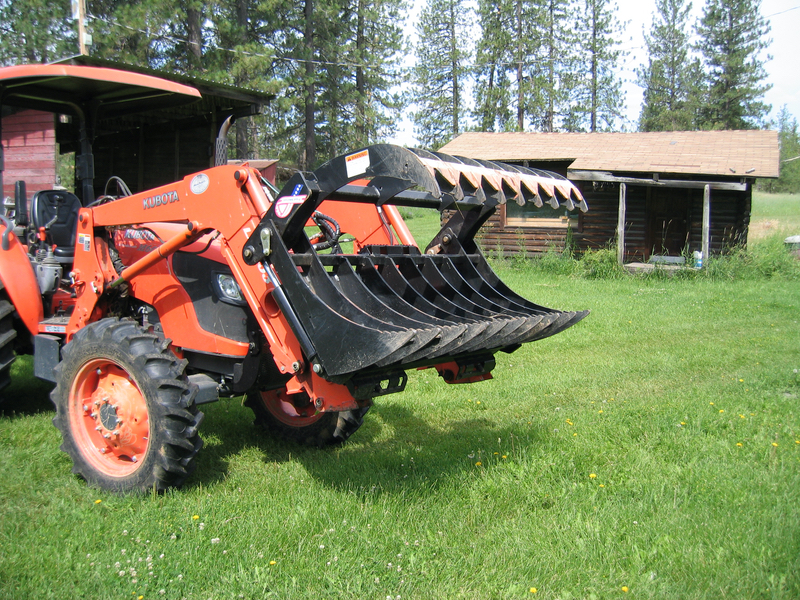

I have a 15' by 20' log cabin that was down at the far end of my little lake. I tried moving it by sliding skid underneath. I turned out to be too heavy - even for my neighbors big 400 hp tractor. Probably for the best anyhow. It would have been a long move ( 1500 feet ) and over some pretty rough terrain.
SO ........ I numbered each log - disassembled - moved the logs, many loads - reassembled at the new location. It took longer but worked out fine.
Behind the tractor. My little log cabin in its final resting place.
