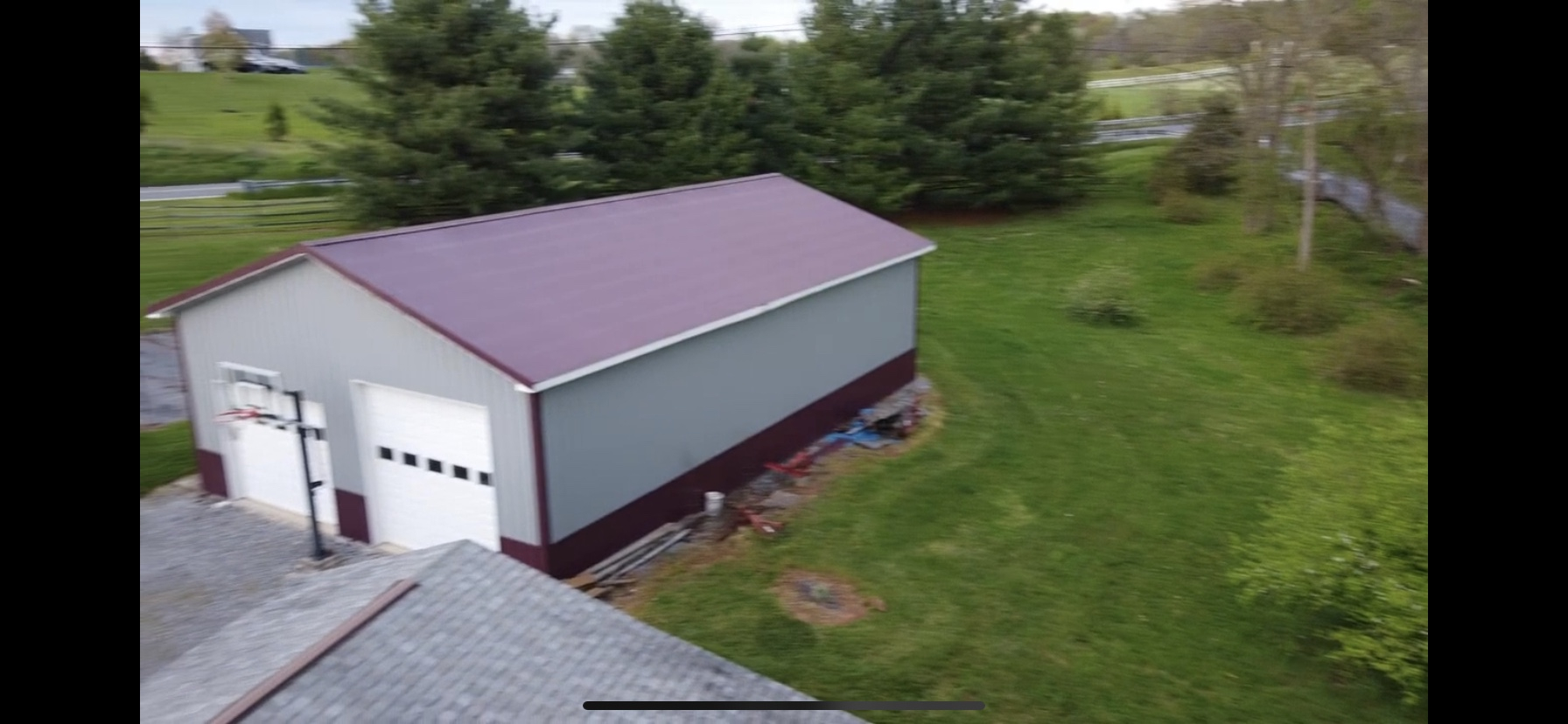

Thinking of putting shed at the backside of my barn. This will take the least amount of dirt work, will have to dig some out and put gravel down. Wherever it goes, it’s going to be blocked so groundhogs don’t go under it.
Barn is 10 ft from edge of door to corner. Will probably stick edge of shed about 3 ft out from edge of barn. Put matching gray siding on after it’s moved.
Did find this drone shot.
Not sure I can build a lean to off of barn high enough for camper though.
how wide do you think a lean to should be to back a camper into it?

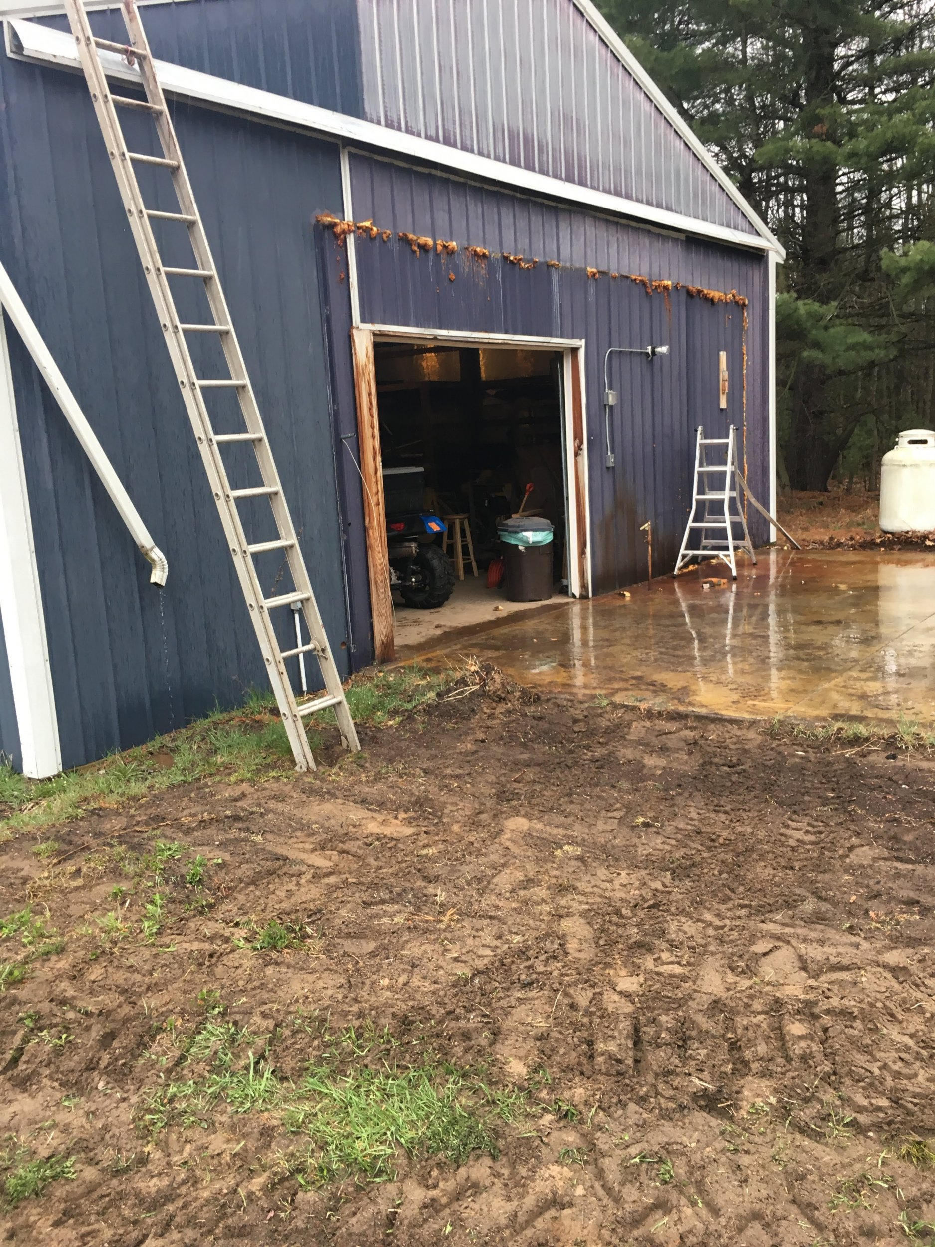

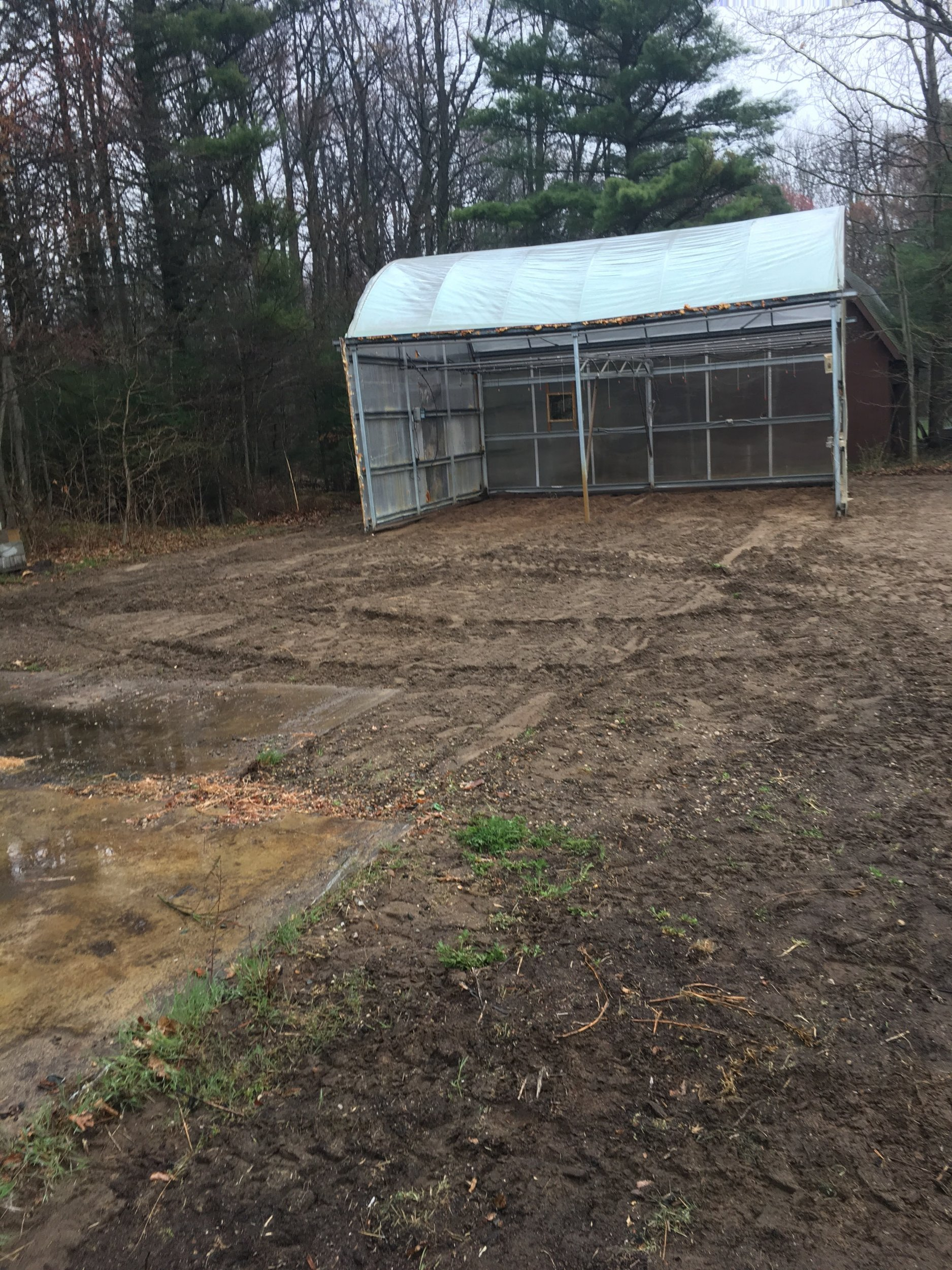

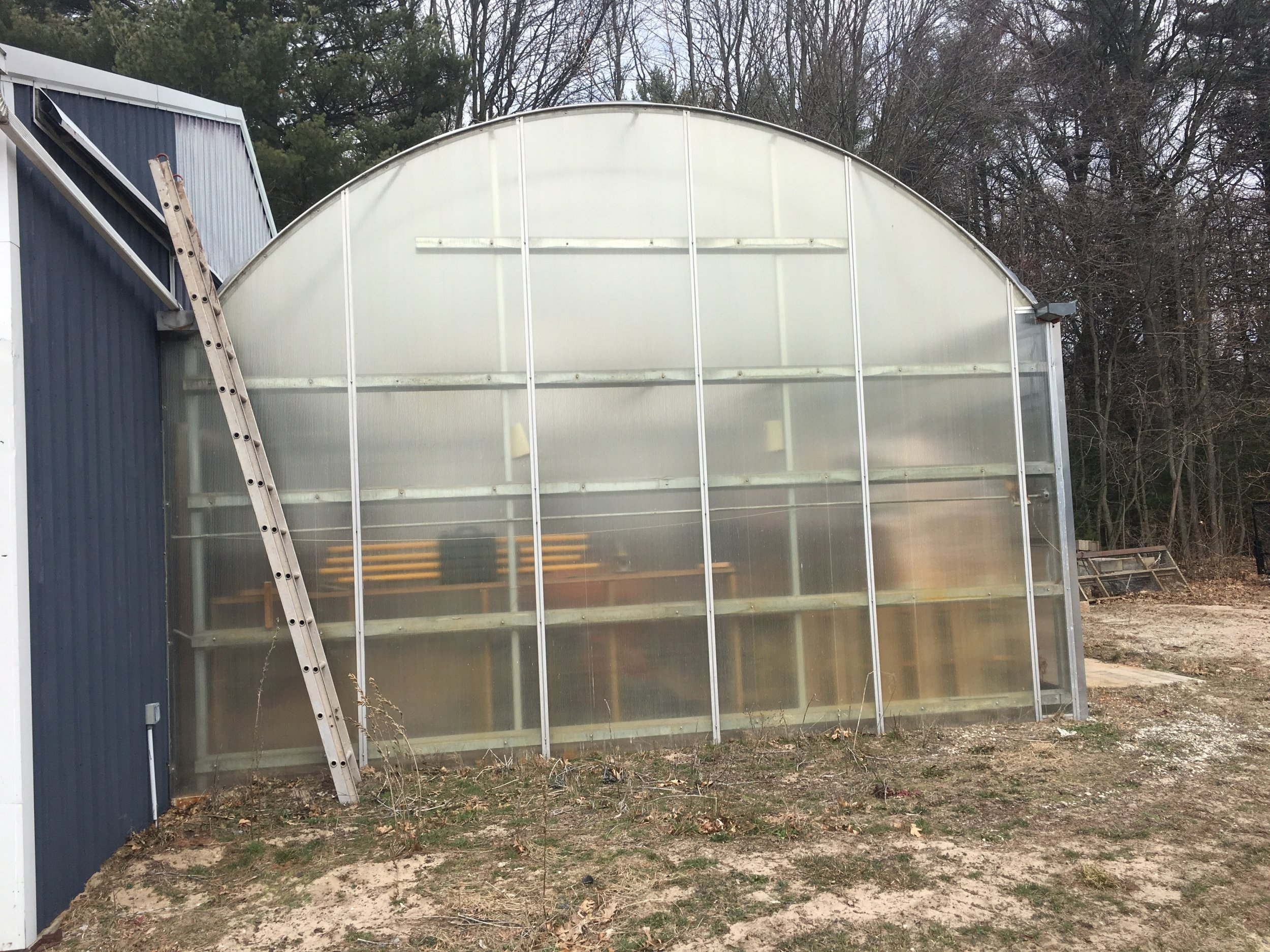

You look at metal carport companies? they can build you a decent free standing lean to off your existing shop in a day. I have several I Like them and have the room, including a 26 long by 24 wide 10' high walls I think its a 3 pitch roof so the center heights like 13' on a 24' wide. I store my boat and class c MH under. These are really quite easy to move around when you have equipment on hand. My 22x12 carport at my cabin survived winters with 3' of snow on the roof no problems I've had for almost 10 yrs now. When I went with these they were less expensive than building something with wood even If I was doing the work myself. unsure on prices now.

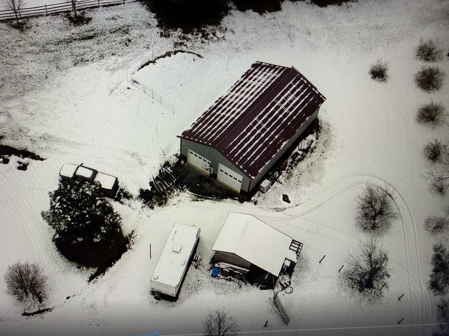

I set my house 43 ft steel I beam using my truck, a come along, and 1 buddy. Didn’t even have a tractor at the time.
25 years ago yesterday. Look at that nice shed back there.
