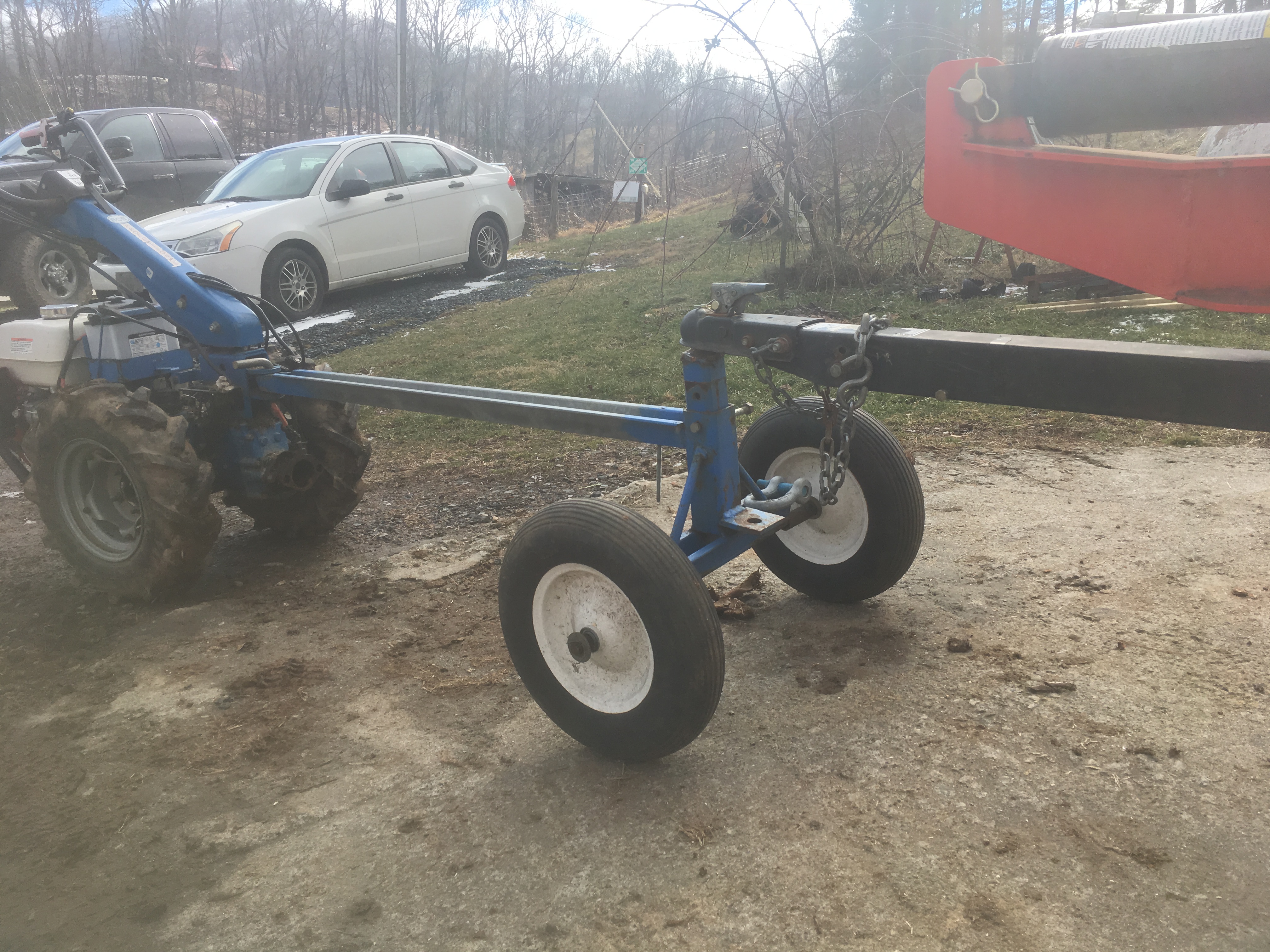

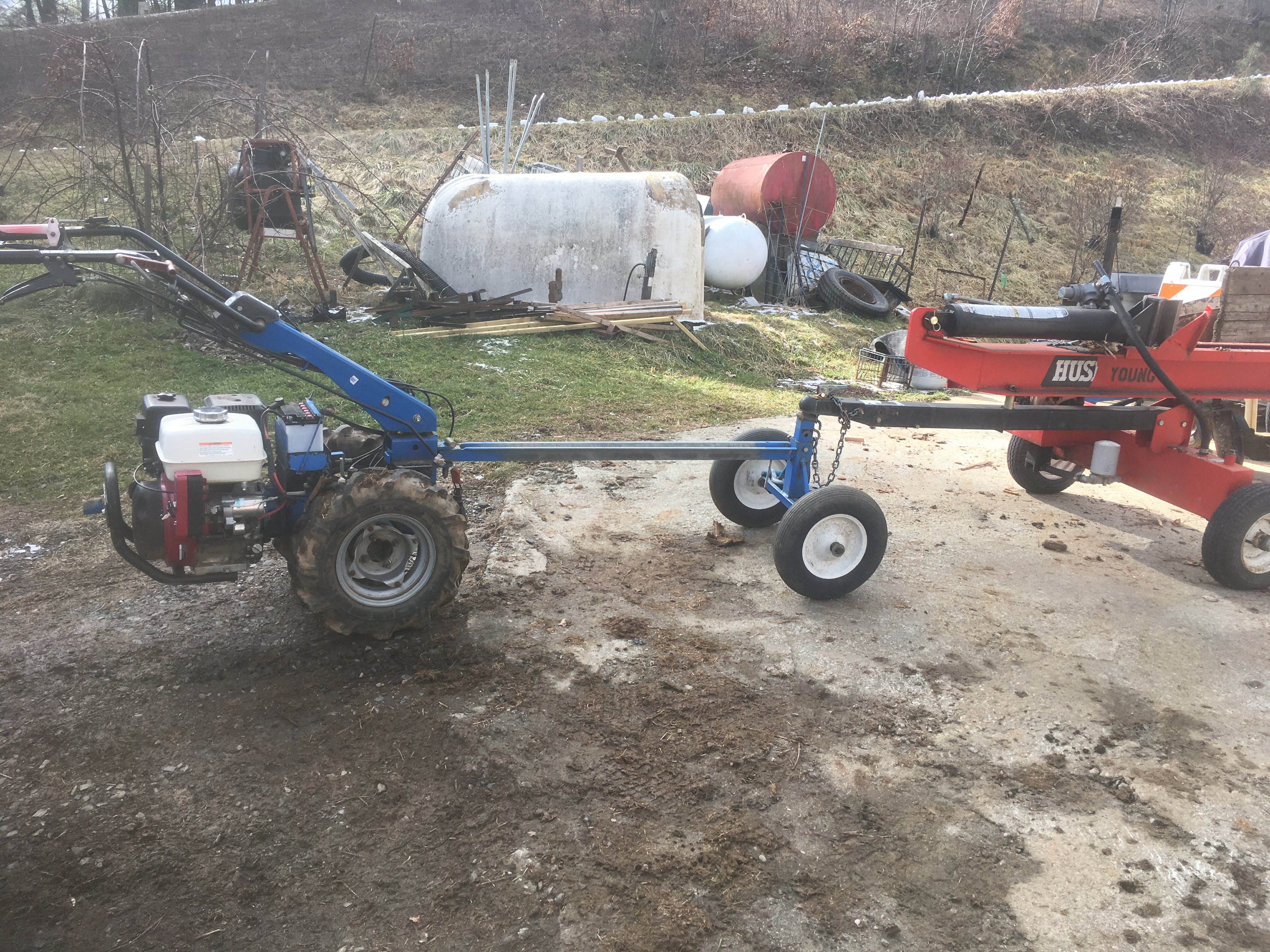

I thought I had some pictures but I can't find any. It's -15 degrees this morning and a foot of snow so I'm not going to get any new pictures, but the link I posted to Earth tools has some that will give you ideas. There are a couple pictures and a few paragraphs describing the tow coupler and pipe on that page I posted, and a couple pictures of small trailers/carts with the coupler here: Earth Tools

On that small trailer I talked about above, it had a ball coupler for regular road use. I originally bought the trailer to haul my BCS to a couple locations for tilling and it worked fine. Funny that years later the roles were reversed and the BCS now hauls the trailer. Since I hauled quite a few heavy loads and when I sit on the front of the trailer (bench seat along front wall) it adds that much more weight to the tongue and was beginning to bow the original u-channel. Last year I upgraded the trailer by removing the tongue and replacing it with a length of square tube going all the way to the back. The tube is sized to accept standard 2" trailer hitches and I can add one to the rear to pull an additional cart, wagon, or wood splitter behind the trailer. I left the ball coupler off the front of the tongue and added a 1' piece of 1 1/4" pipe for my BCS coupler. I can also add a trailer hitch to the front of the tongue and attach that behind my sulky or larger tractor. It looks like a train when the BCS is pulling the sulky, which is pulling the trailer, which is pulling the large gorilla wagon. For most heavy hauling I just connect the trailer directly to the BCS coupler.
