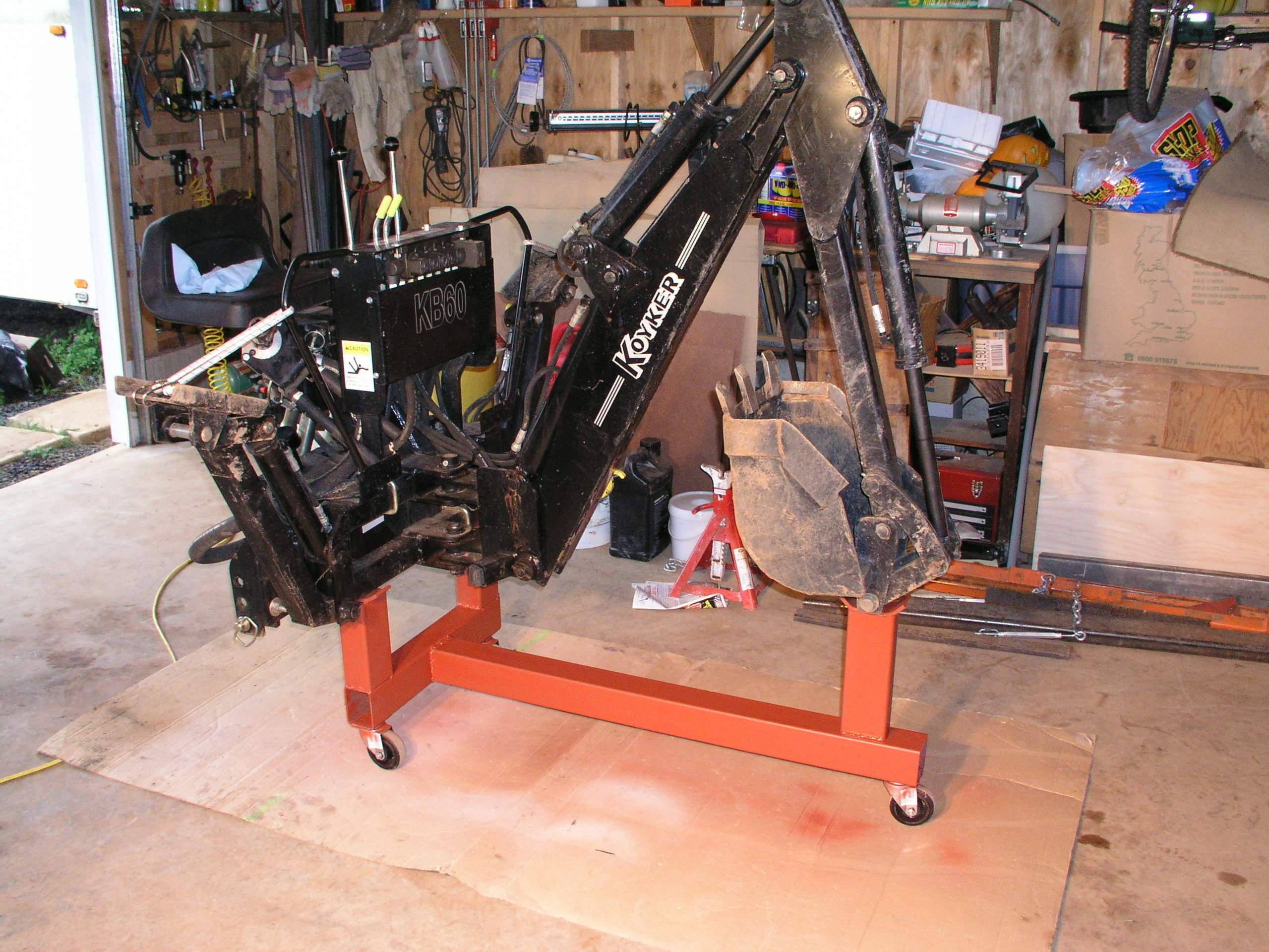

Here's what I built to store my small 3-point backhoe on. Having all the wheels swiveling allows for a very fast hookup. I later added some smaller swivel wheels on the side so I could stand this stand on its edge and move it around when it wasn't carrying the backhoe.

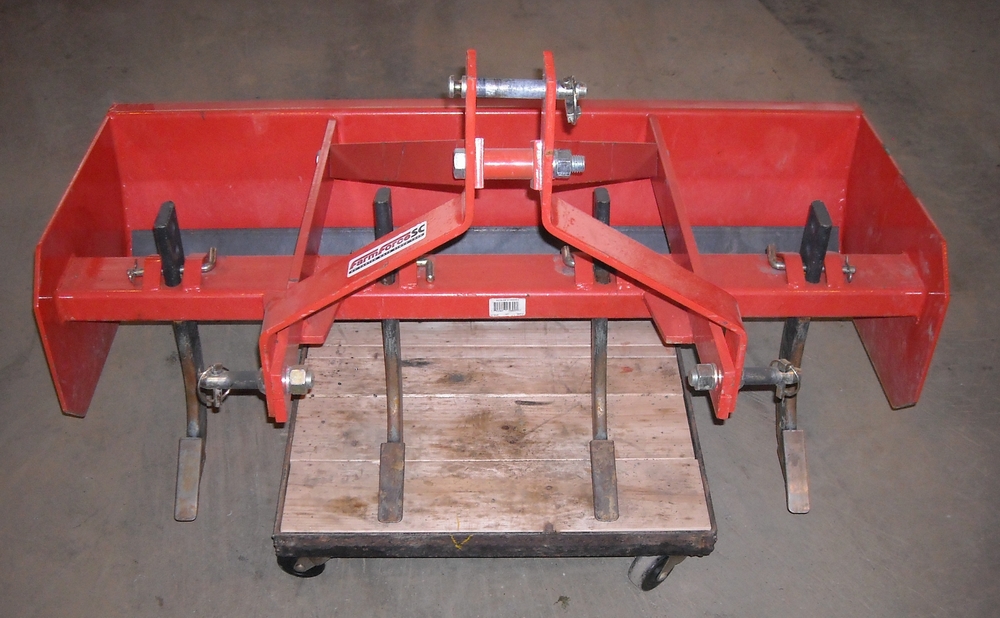

I saw a problem the first time I unhooked the loader in the garage and then realized I should have placed it a couple feet over to get the car in beside it.
Just using what I had laying around, I made a 2 foot x 2 foot platform by welding 2x2 angle and heavy duty swivel casters and inserted 2x6 planks. Use that for boxblade or ballast box. Made another 4 foot by 4 foot for loader or snow blower. Sure is nice to be able to jockey stuff around with just one hand.

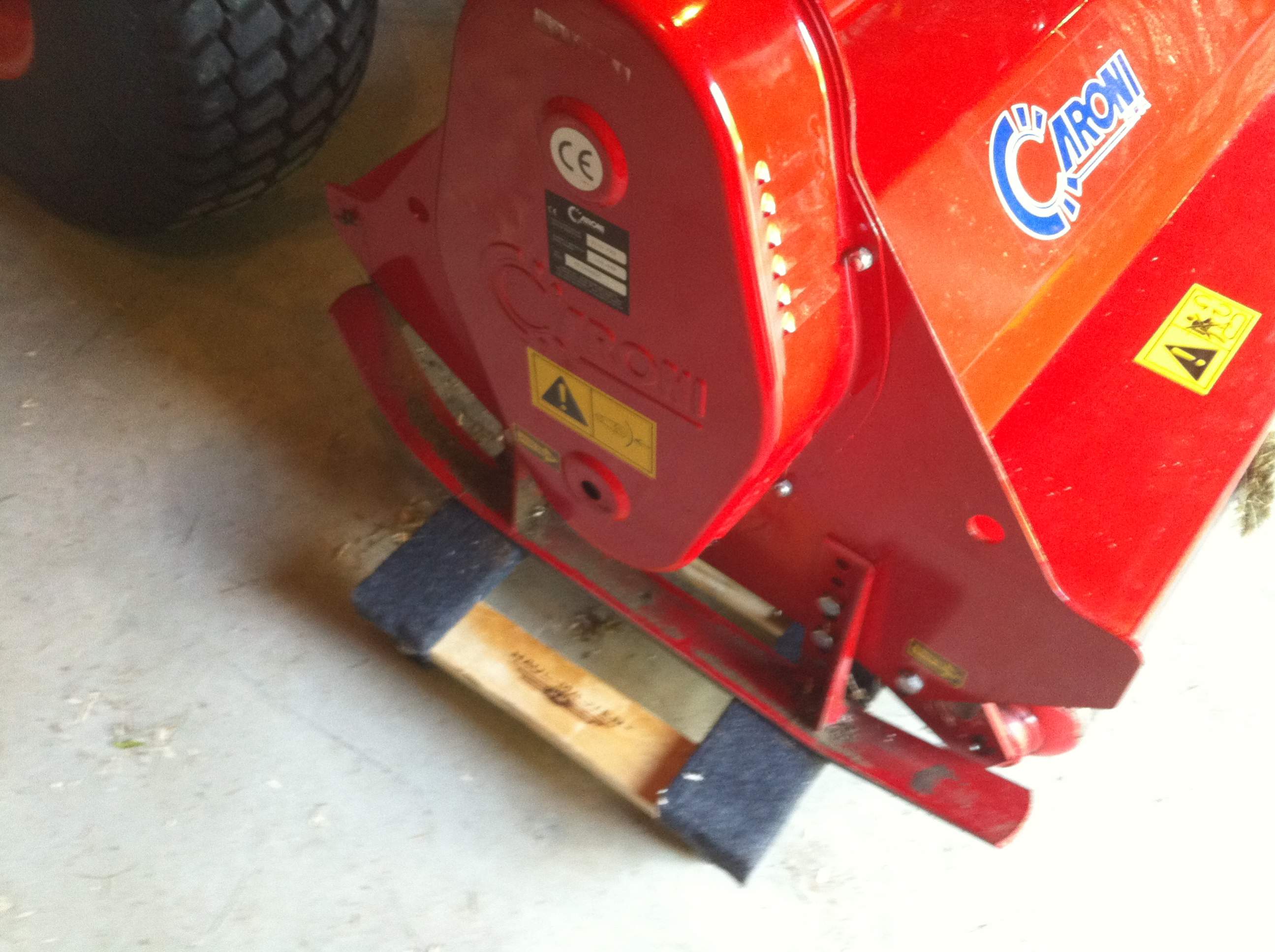

   / Moving Implements #48
Thanks for the heads up on the HF dollies. I bought a couple of them yesterday @ $7.99, and they're under the flail mower now.
