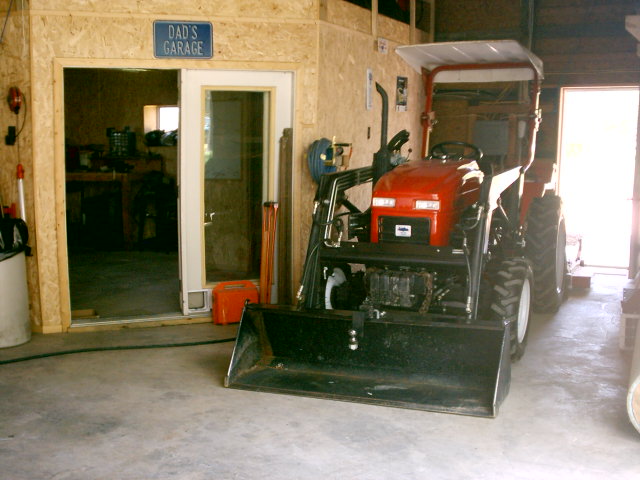

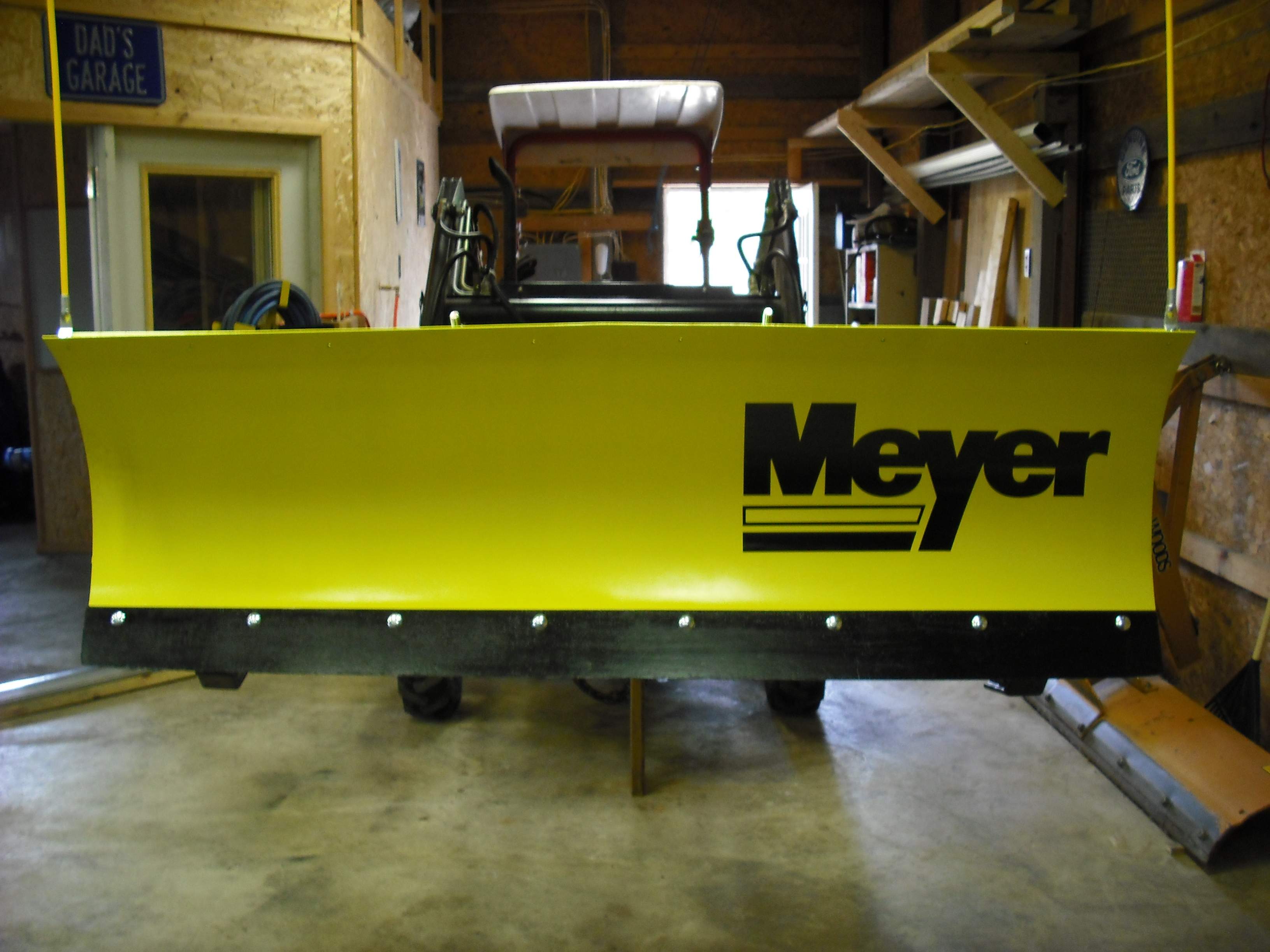

I am with you guys. I even store my trailer in the barn. If I need more room I will build on. I built a shop in my barn that is 20x16. I made the ceiling joist out of 12" engineered lumber and 3/4" plywood. I now just lift up seldom used items up there with the forks or the FEL boom pole.
In the first pic you can see the shop. There is a rail around the whole thing and a gate that opens above the door so you have a clear shot at it with the tractor. You can see the stairs in the 3rd pic along with the log splitter I built. The 2nd pic is of the dolly I made out of steel for my FEL Meyer snow plow. 4th pic shows the shop and plow.
Chris

WOW! Nice wood working!
I'll have to build something like that for my chipper that is on it's way here.
I will no longer be able to store and back up to all the implements I have in my barn anymore once it arrives. I was thinking "how am I going to do this?"
And bingo you present pictures of my solution! THANKS!

Please note the Walleinstein BX42 chipper/dolly photo. The chipper is attached to two 4x4 PT posts with through bolts-I am 6'-4" tall so the added height works out well and keeps the metal bottom rails off of the dirt.
