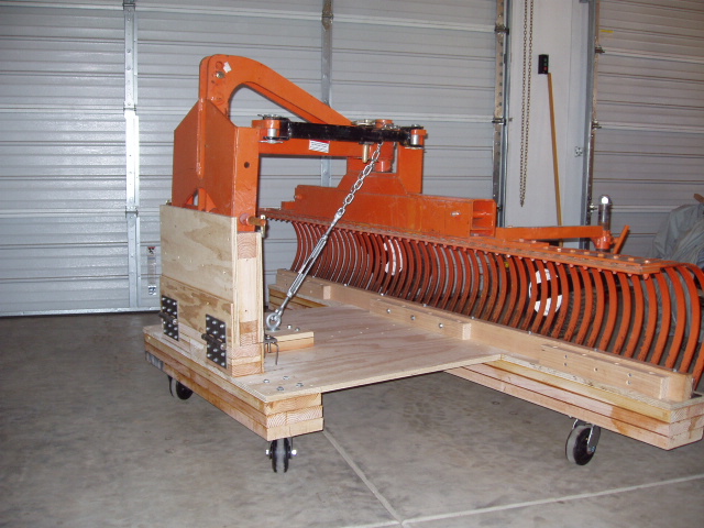

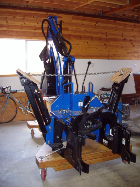

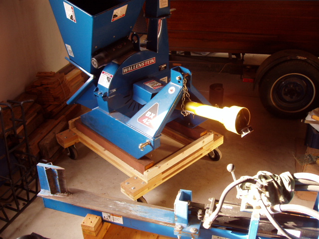

You didn't mention what your floor surface is. If it is concrete then dolly wheels will work. I use HF wheels on my Backhoe, wood chipper, landscape rake and wood splitter dollies. Just be sure and don't build the platform too tall as to interfer with the attach/removal process.

Nickel Plate---
Those are awesome looking dollies!

Geezzz!! Nickle Plate's shed is cleaner then my house!
I picked up a refrigerator dolly for my Ballast Box. About $15 from Harbor Freight and rated to about 1000 lbs. Works great.
/ Moving Implements #11
WOW! Nice wood working!
I'll have to build something like that for my chipper that is on it's way here.
I will no longer be able to store and back up to all the implements I have in my barn anymore once it arrives. I was thinking "how am I going to do this?"
And bingo you present pictures of my solution! THANKS!
