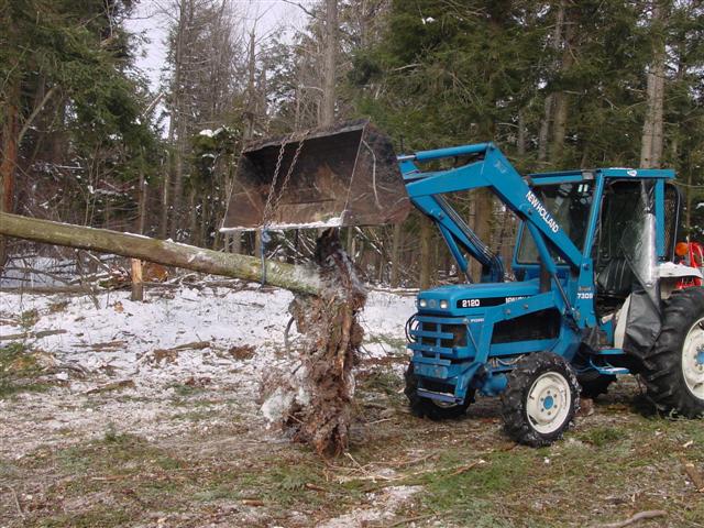

Nicely put MP. Leaving blow downs on the ground actually help in the generation of new hardwood growth by protecting the new seedlings that are just strting to sprout. The blow downs give them a protection from the deer and other animals that like to nibble on new growth. When you strt dragging out all the brush you are actually uprooting a lot of unseen growth to the naked eye of future hardwood trees etc.. Just my thoughts....
