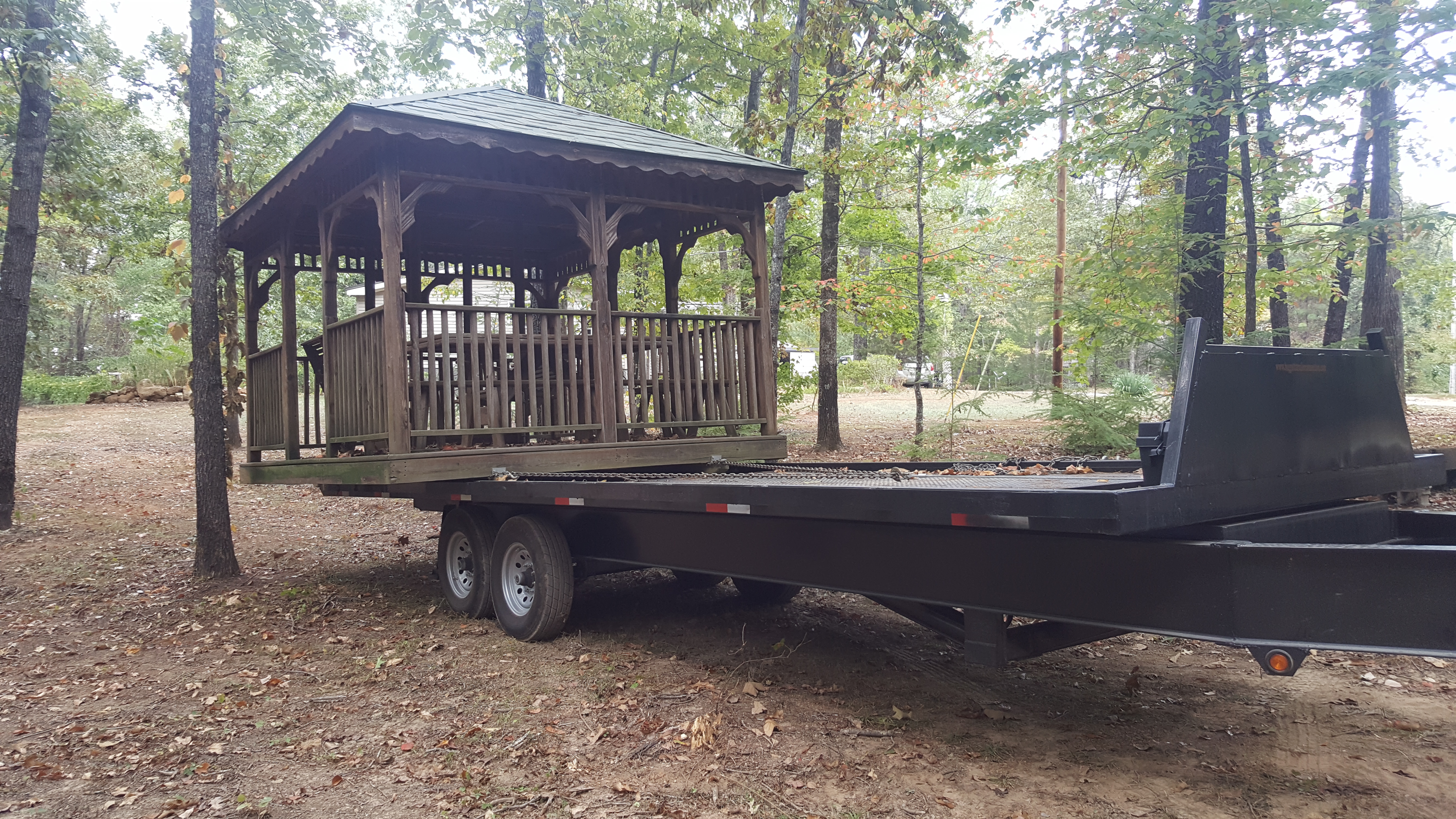

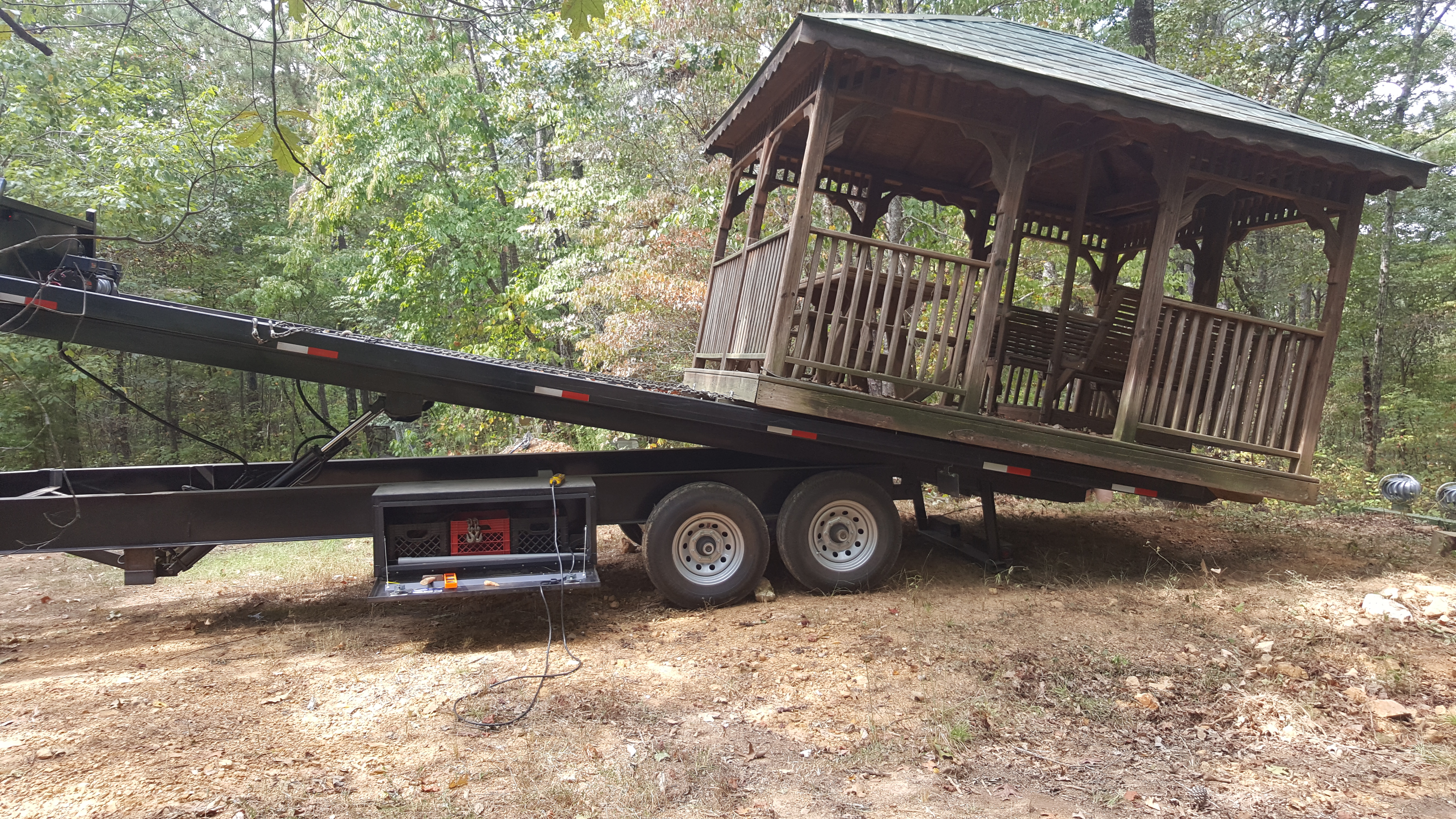

that is one of the reasons I bought the trailer I did.

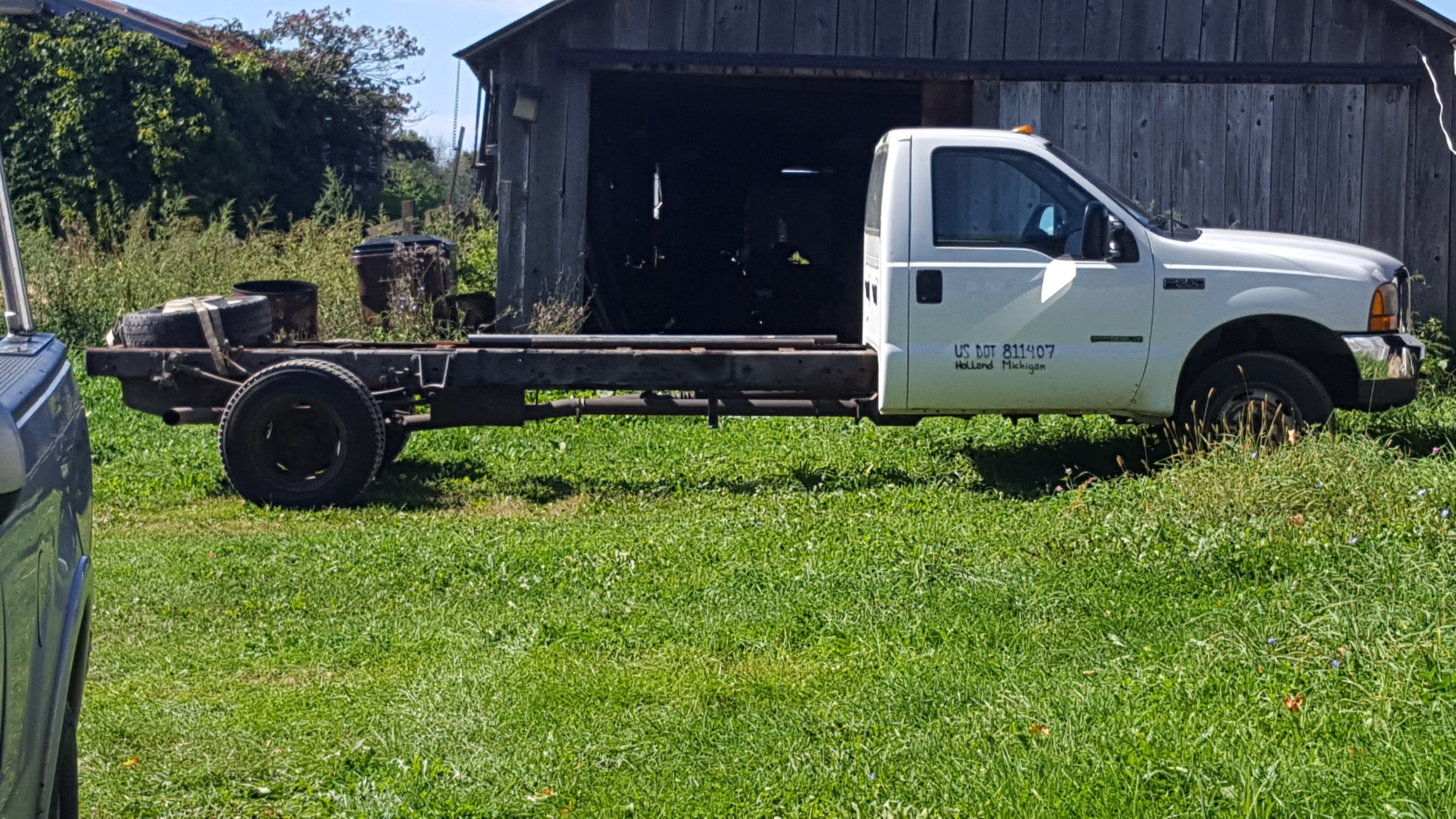

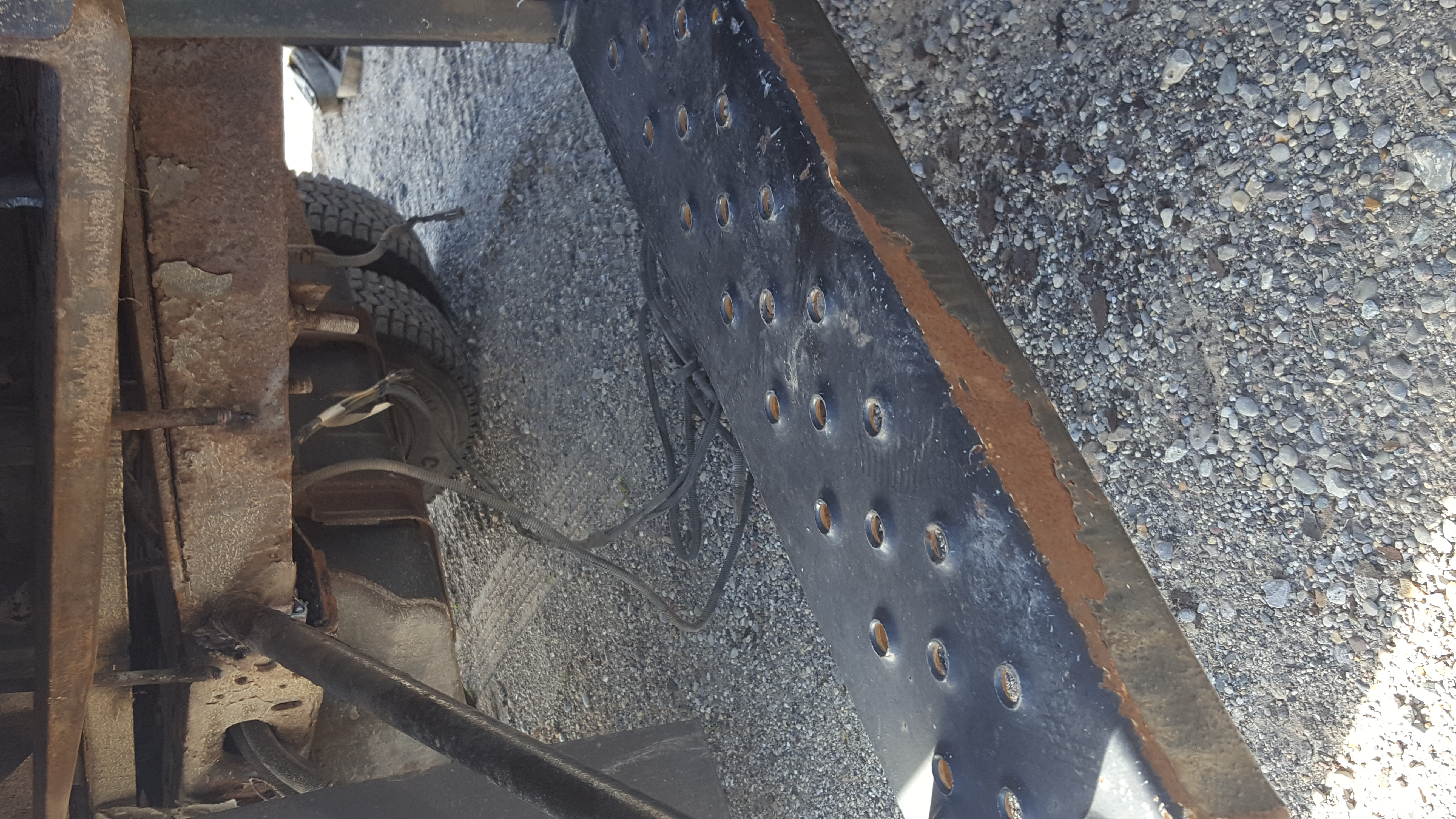

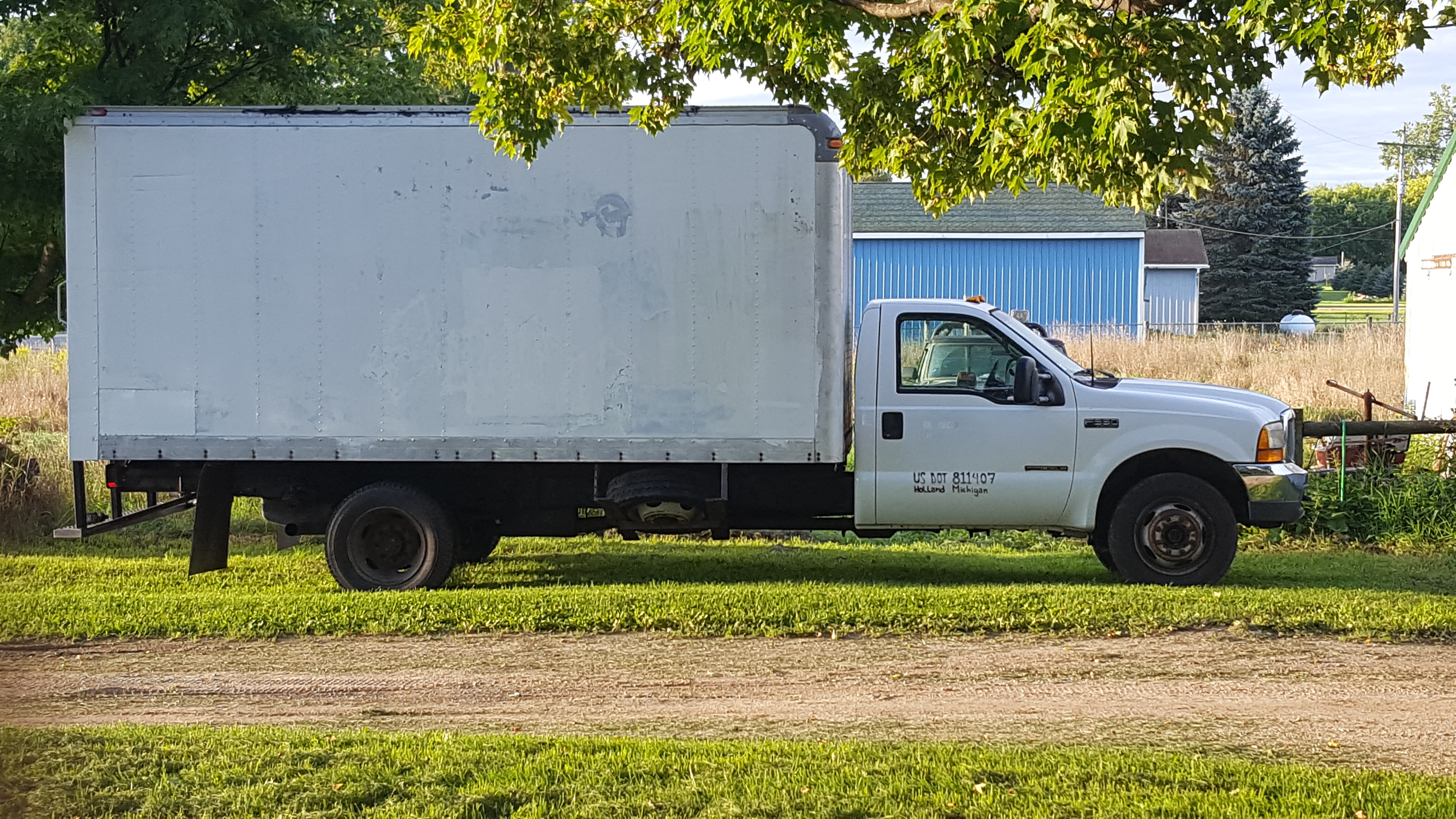

Didn't really read through the whole thread but just unloaded a 16ft box a few weeks ago. Anchored it to a big skidsteer and lifted one end then put pipes under it as rollers and backed up the skidsteer. Got to the end send set the rear down and moved the skidsteer to the front and lifted it and pulled the truck out. Was about a hr total but went very well1476183561354.jpg1476183575168.jpg1476183595098.jpg1476183604618.jpg
