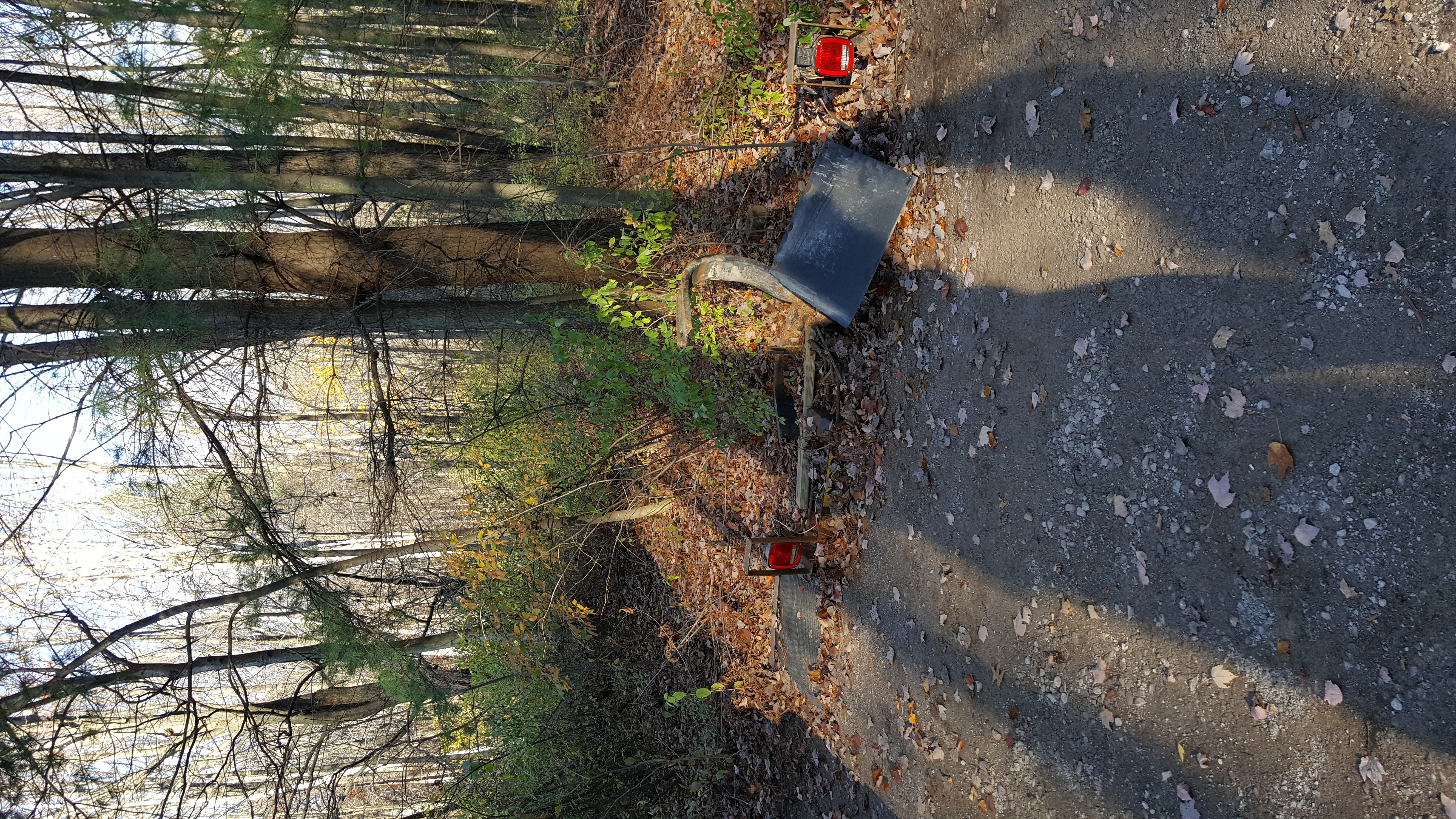

Once I get the OK from my boss, we are going to use a wrecker service with a flat bed truck. I will post pictures when it happens. :dance1:
   / Moving Old Truck 20' Cargo Box - Safely
#23
Got the OK, site is prepared - going to get the truck here tomorrow ......

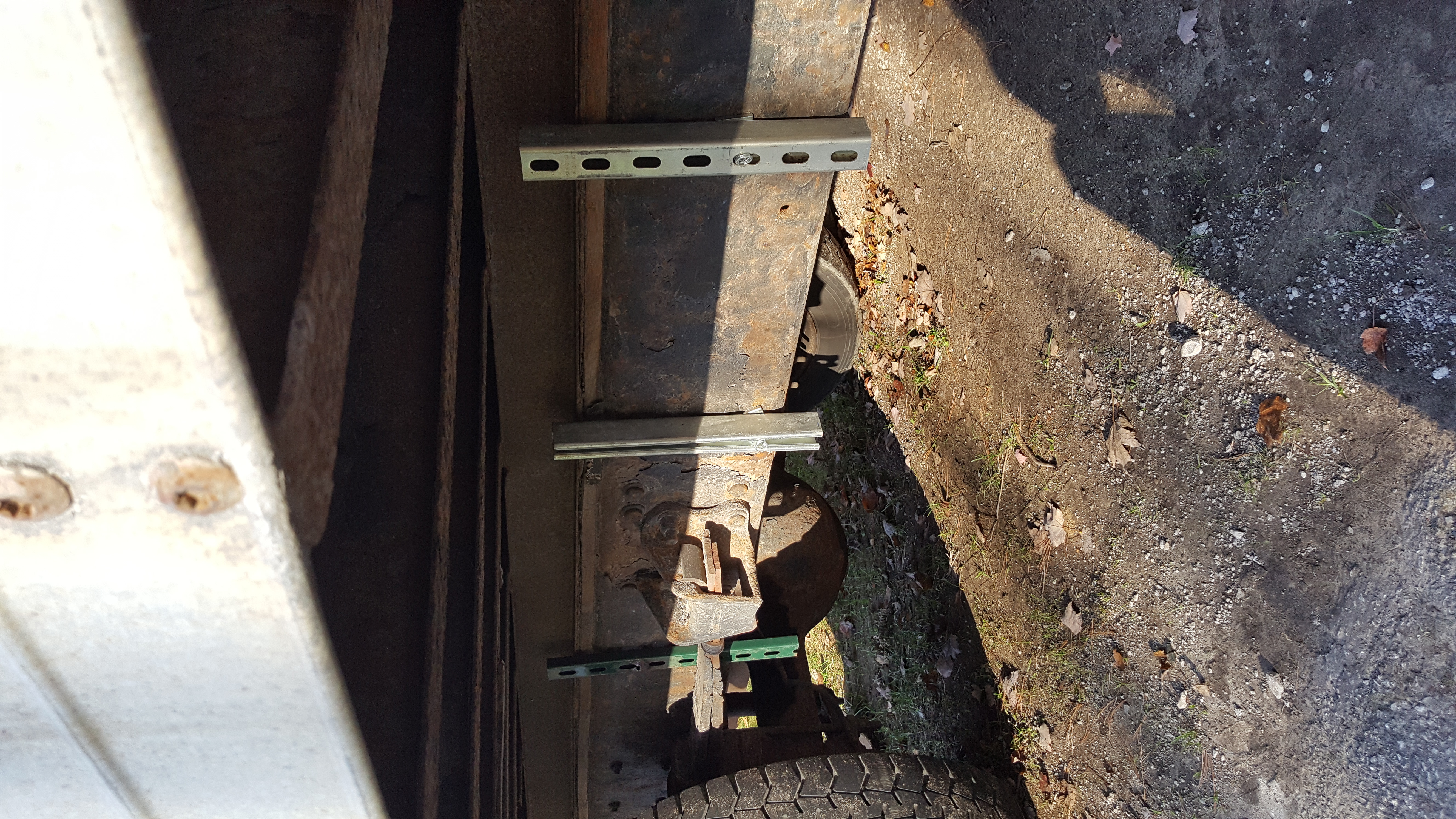

Problems that I observed:
A truck 'box' is built on a steel rail that sits on the truck frame. That is 2" wide sitting on 2" frame so rolling or sliding the box off won't work as for sure the 'rail' will fall off of the frame.\I did consider welding side tabs to guide the slide off procedure but moving the distance I needed was also a problem.
What I ended up doing was to wrap a chain about mid point and jurry rigging a spreader bar at the roof level to prevent squishing the roof.
It just so happened that a decent sized excavator was handy and I hooked the chain on his bucket and he lifted and moved it to the desired (prepared) site.
The move took about 15 mins with absolutely no damage.
I had tied a rope so that I could steer and swing the box while moving it suspended from the excavator bucket.

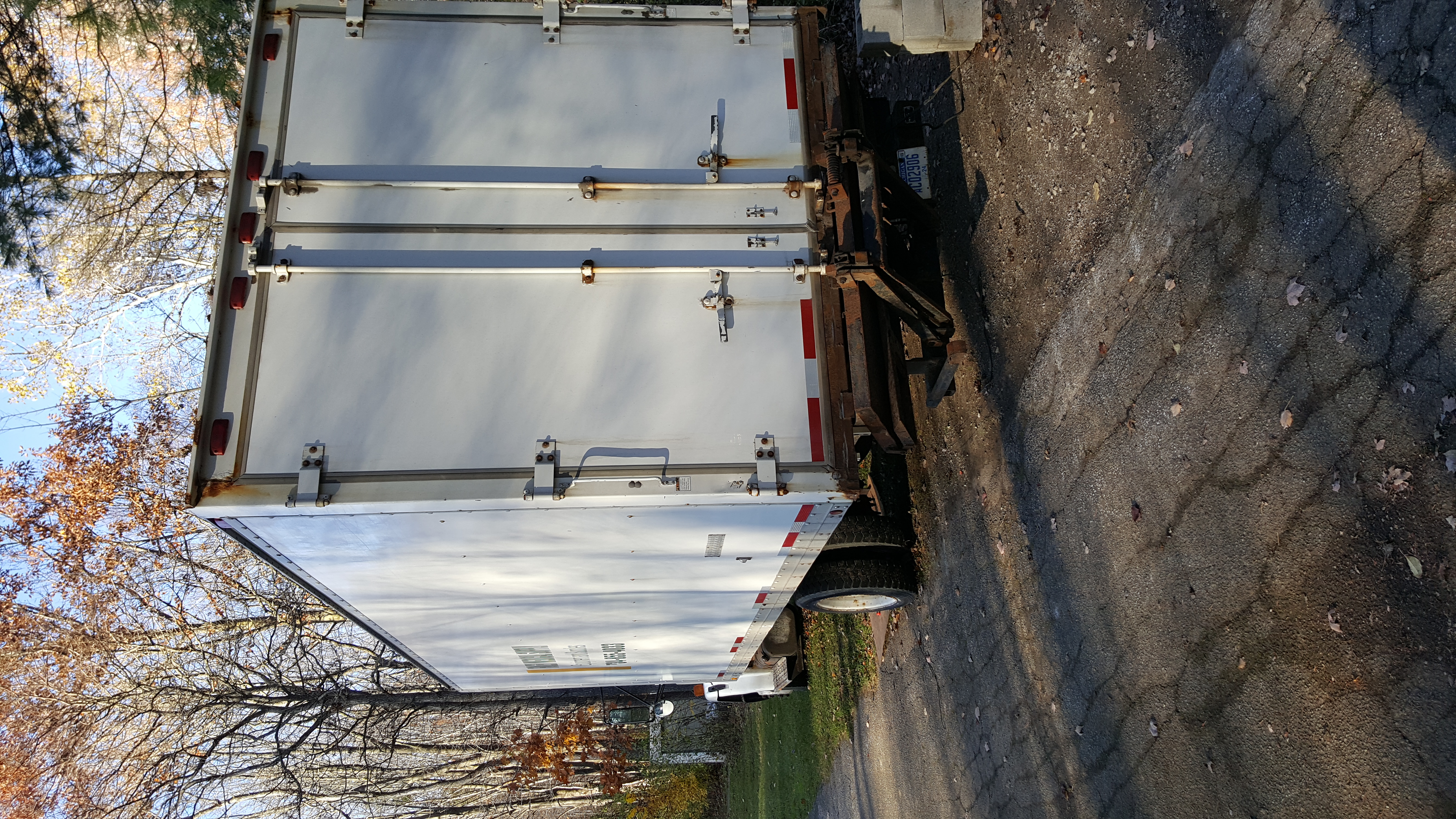

Got working on this - cutting the bolts was a little sketch, they where under tension. I have 2 left to remove, those I have loosened up. Thanks to PILOON for the suggestion about the rails(see photos). I am trying to get this done next week. I think I have everything in order. Any other suggestions let me know.
Thanks for all the input

Got it DONE:cool2:
200$ and 30$ tip to the workers - Nice to have it on the ground safely - thanks to everyones input
