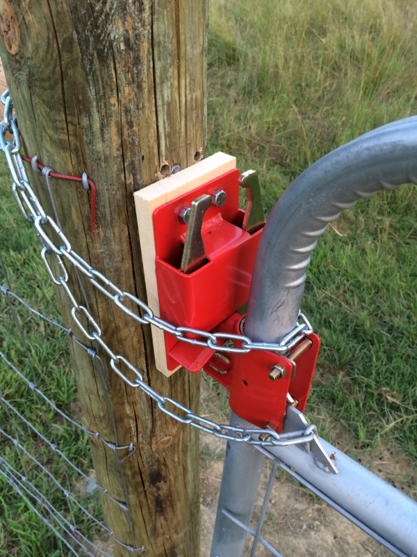

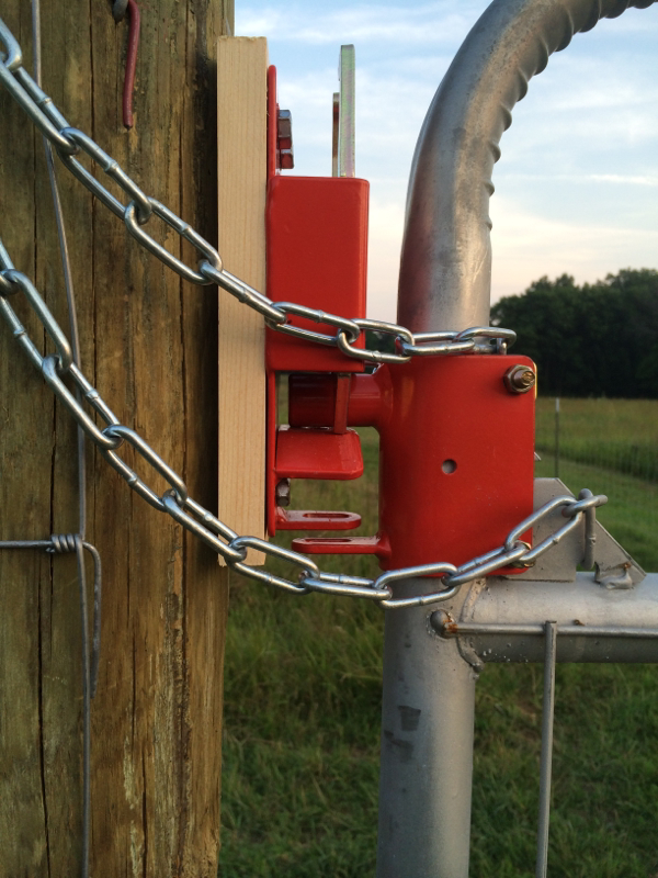

Shimmed one of the gate latches tonight. It works much better now.

Latch plus chains, you are not taking any chances!!
Good thing I didn't. The posts settled more than I thought they would and the latch came undone. Won't be a problem now that I have shimmed the latch, but old habits die hard.

The extra hole in the latch on the gate is to run a bolt through the gate. Take a 1/4" drill bit and drill from both sides bolt slips right in. Think you need a 2 1/2" bolt with lock nut. It will keep the latch from spinning on the gate if slammed.
Makes sense. Thanks.
