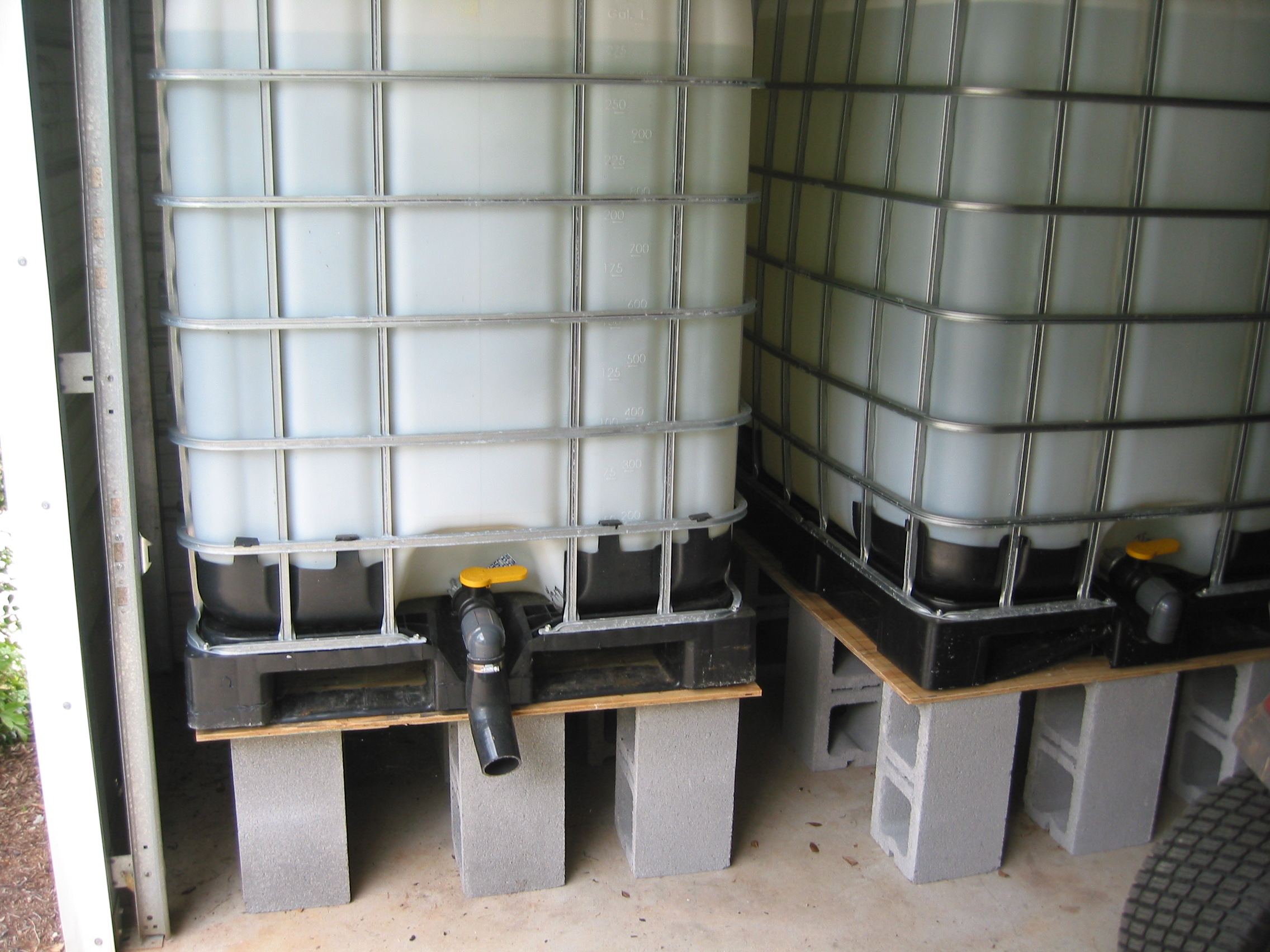

Gem,
Do you have a picture of your cement block stand? I was going to do that as well but on dirt so I am wondering if I put a solid block down first and then a couple courses of cement blocks. Thoughts?
   / Moving to the Farm #312
The totes come with a metal wire frame and an attached plastic pallet, so stability won't be a problem. They should do just fine on dirt, cement, or whatever. The reason I added the blocks was because I needed the height to allow a bucket to slide under the gate valves that came already on the totes, and hopefully to give me some gravity feed once I have found a hose bib.
I used 9 blocks per tote to be sure to not have a disaster considering each tote filled will run about 3,000 pounds.

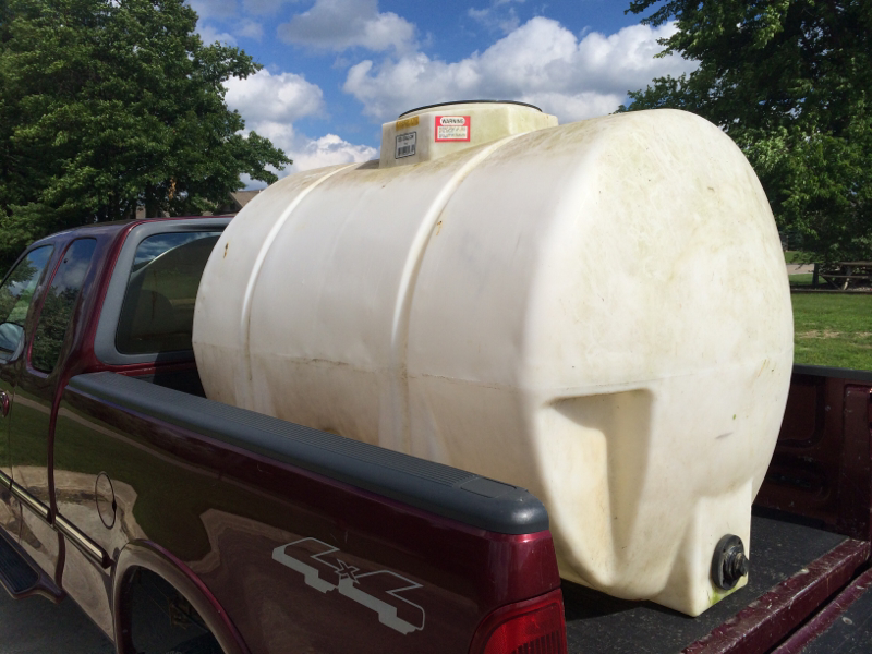

The tank I have is not a tote, although I may get some of those too. I also want to get them up off the ground to make them easier to use for filling things. Our tank looks like this.
   / Moving to the Farm #314
Your tank is called a leg tank. You need bands for the tank or it won't hold it's shape if loaded for very long and will eventually crack. You need a band at each groove. Which looks like two. Plus they need to be bolted down or they will also spread. As they are usually made of galvanized pipe.
Also it probably has a 2" outlet and a valve and a cam lock banjo fitting will set you up.
