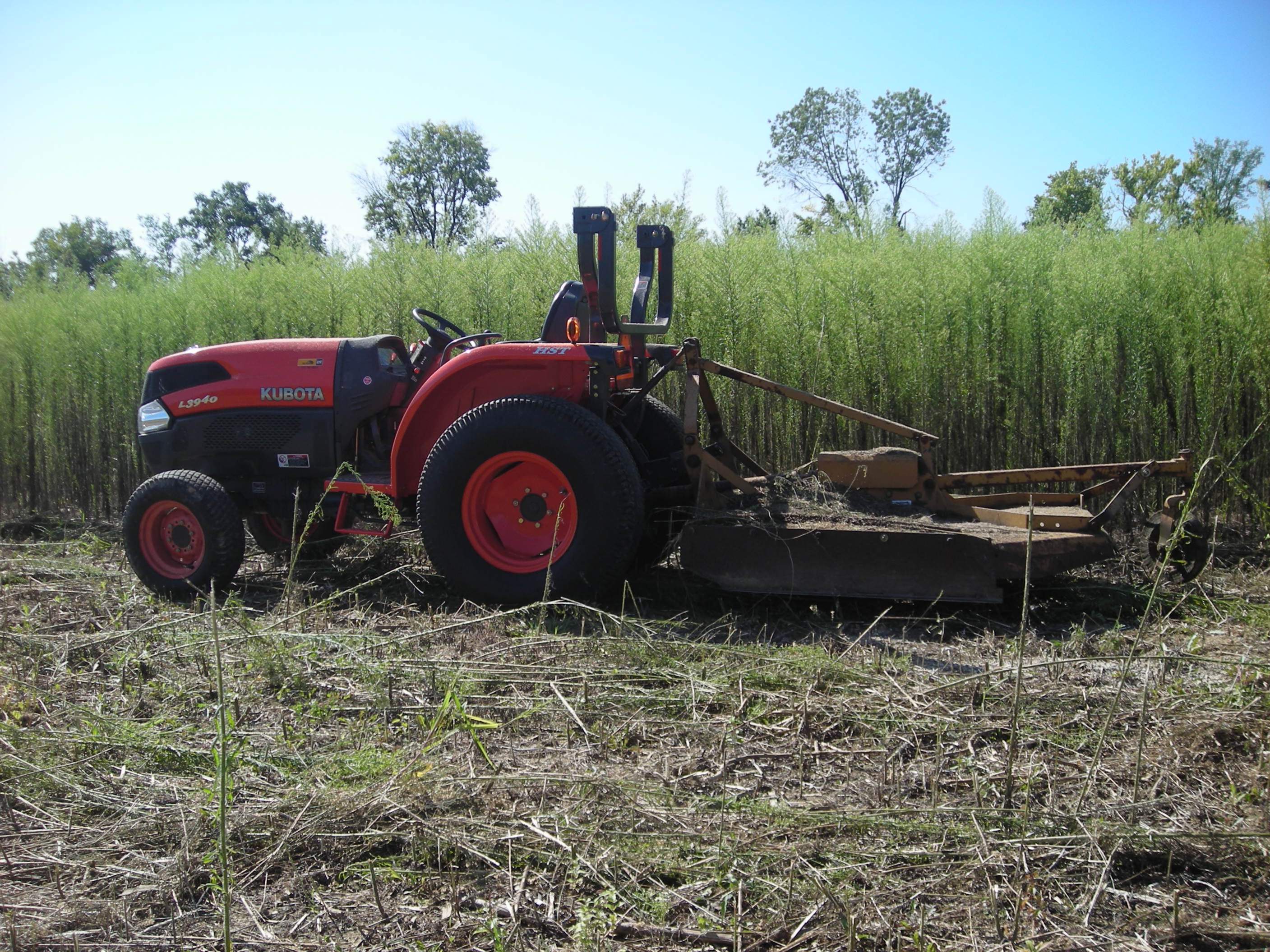

I used a five ft.shedder on my L3130 and it was a good fit,also use it on my L4240..I could use a six ft. but until this one breaks beyond repair I will continue to use it.The four won't cover your tracks (with a L3240) but would be useable I would think.
