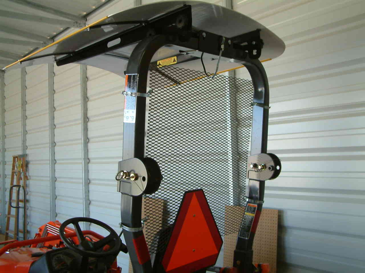

But, IMHO, your setup is as dangerous as ****. The last thing I want is a brush hog spinning at 600 rpm hanging on an FEL at eye level with nothing between my face/chest and flying debris.
You've been lucky so far. At the very least I would recommend that you install an expanded metal screen between the hog and the driver's seat. Why risk an accident. I don't think that tilting the hog gives adequate protection.
I have one attached to the ROPS on my B7510HST that I install when I run my 4-ft KK hog on the 3pt.
Just my $0.02 worth.

The minimum protection I would install is an expanded metal screen attached to the FEL arms with hose clamps.
This FEL/hog configuration, IMHO, is better suited to a skid steer machine that has an enclosed cage with built in ROPS.

Flusher: The blades are actually spinning at 1,037 rpm because of the 1.92:1 overdrive ratio in the gear box. Intuitively it does seem dangerous, but in practice that has not proven true since I started using it in 2005. The expanded metal screen radiator guard I made for the front of the tractor extends far enough to mask virtually all of the mower width. Things look different from the tractor seat than from the ground.
Of course it does produce the flying debris of all rotary mowers so I don't mow when anyone is close by.
