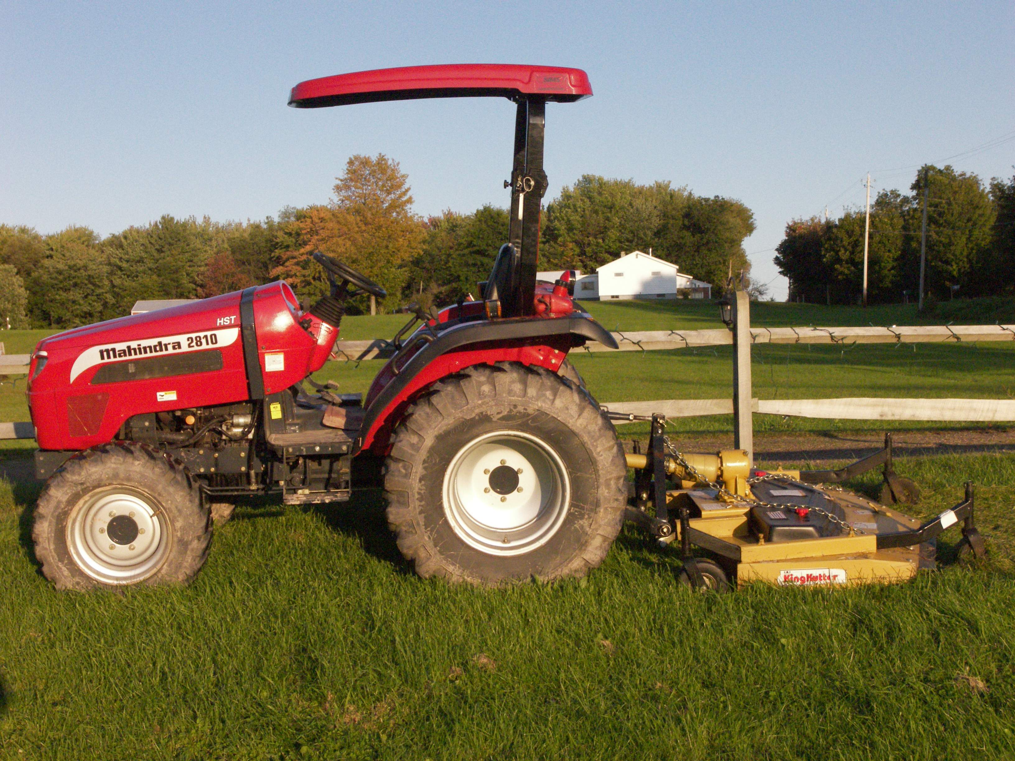

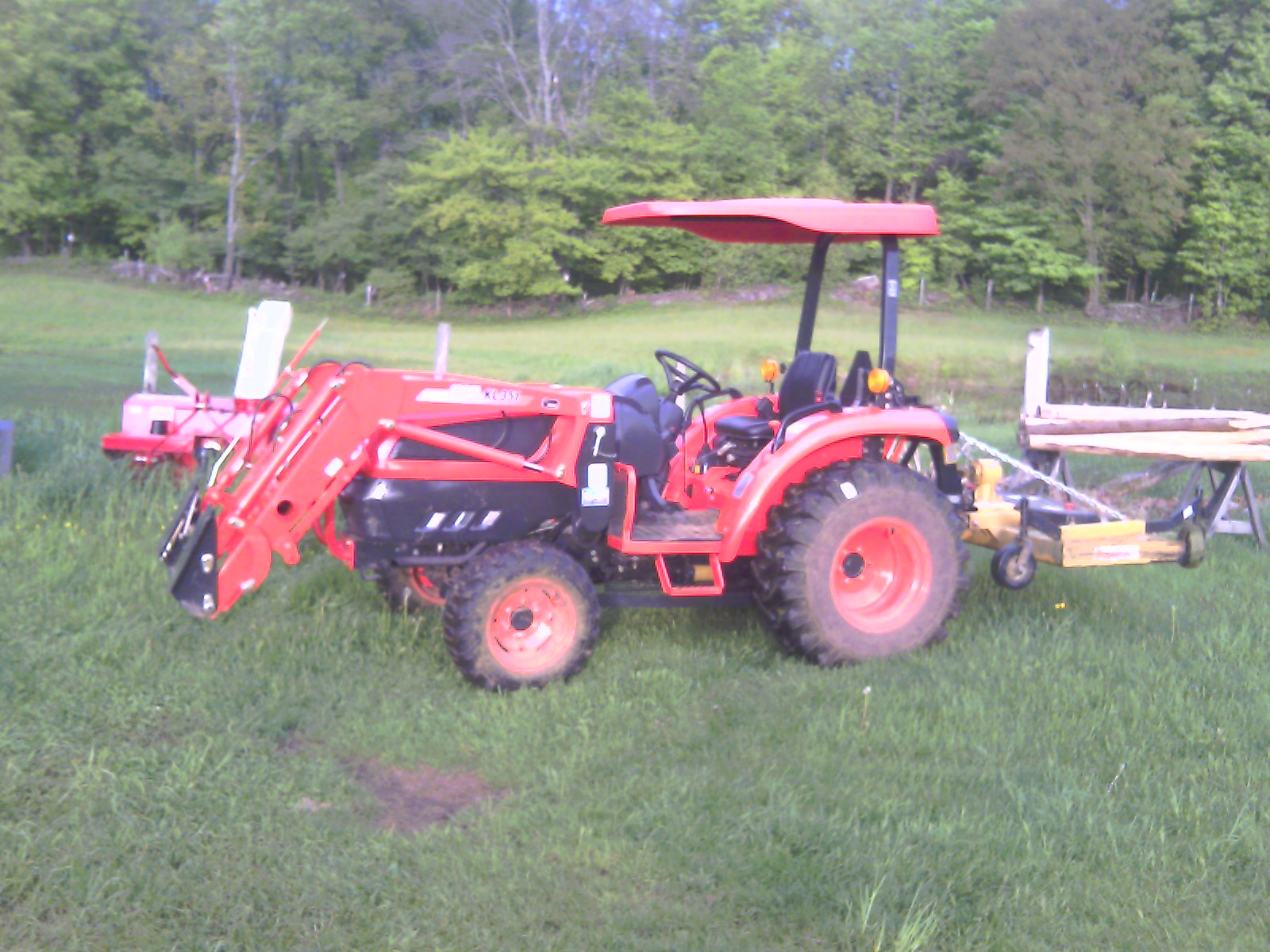

At my place i mow a lot in reverse sometimes, the only problem i have run into is things i have backed over, IE: bushes, shrubs ya know stuff your suspose to mow around. They work nice for shrubs and bushes and small trees that are in the way or are not wanted anyore if you get my drift . . .John
