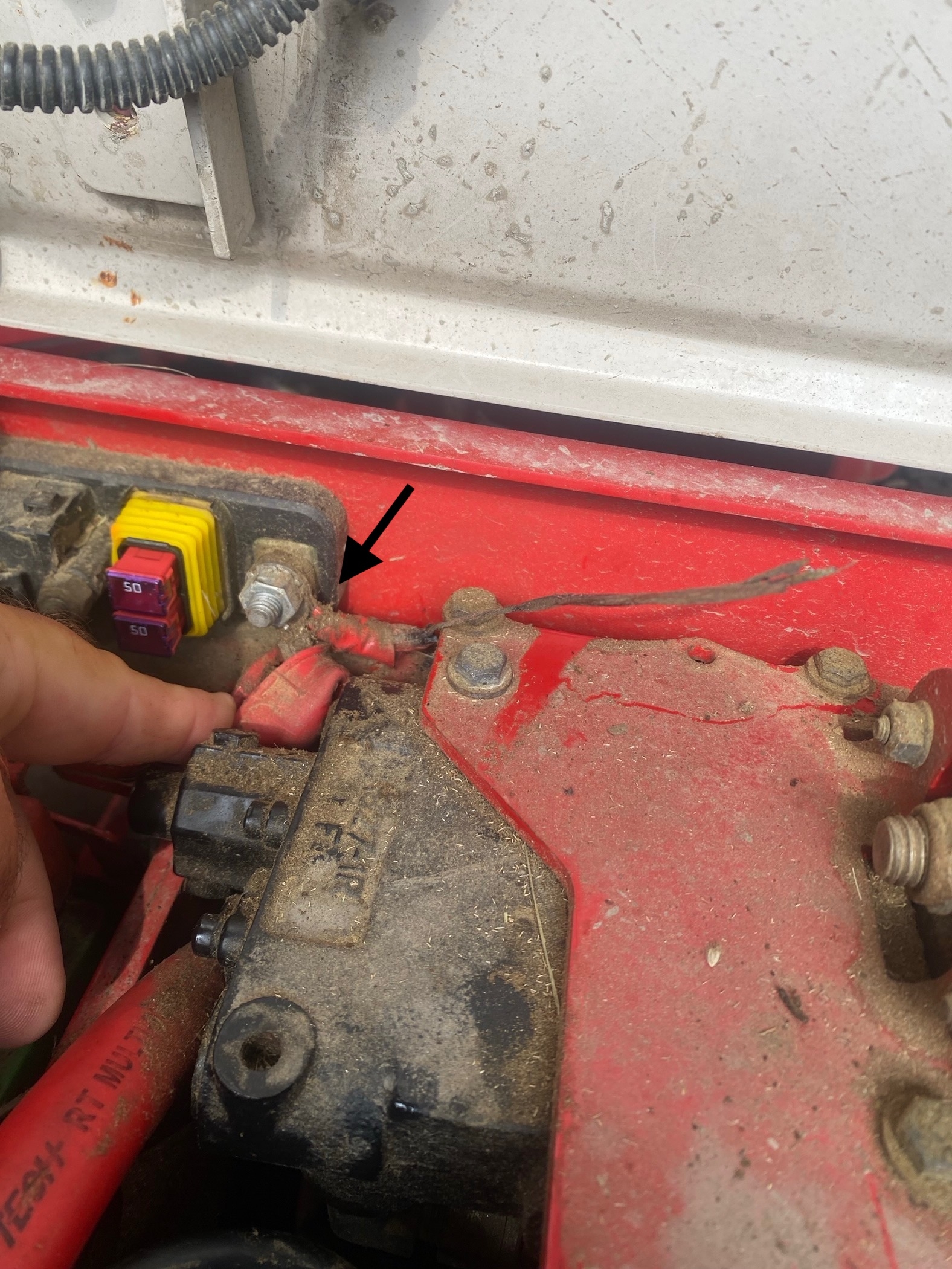

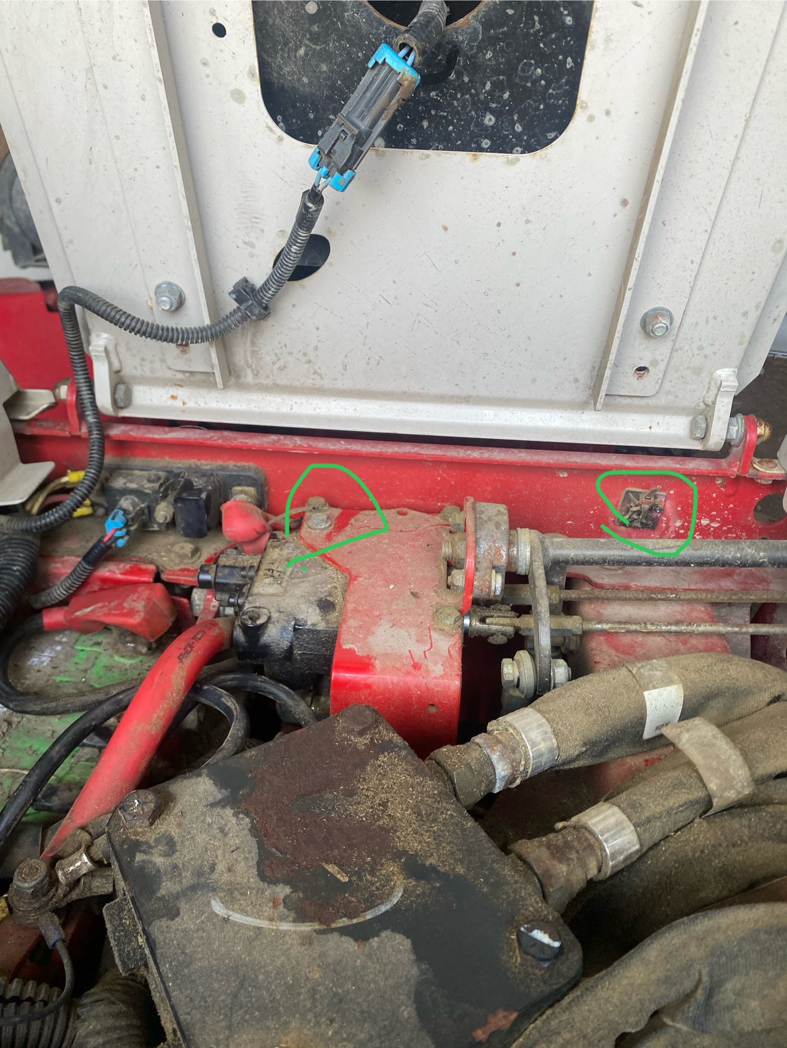

After fumbling quite a bit I get it on the trailer and back into a shop I can work on it but no luck with moving forward diagnosing the issue. Battery was down at 5.5, I pulled it and charged back up to 12.4, and no response. No lights on gauge or cluster come on when key is turned to run and TCM is only showing power light in the bottom corner.
There is this wire coming off the relay box near battery that seems to have been damaged.. could this be the culprit?

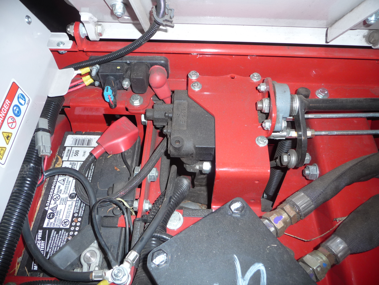

Not the “Start” position, but when the key is turned to the “On” or "Run" position, what LEDs on the TCM light up other than the “POWER” LED? If there are none, then I suggest to check the condition of the fuse that supplies power to the TCM (“A” in the graphic below).
I took a photo of the battery area of my 4500P and the wire(s) that you’re asking about do not exist.

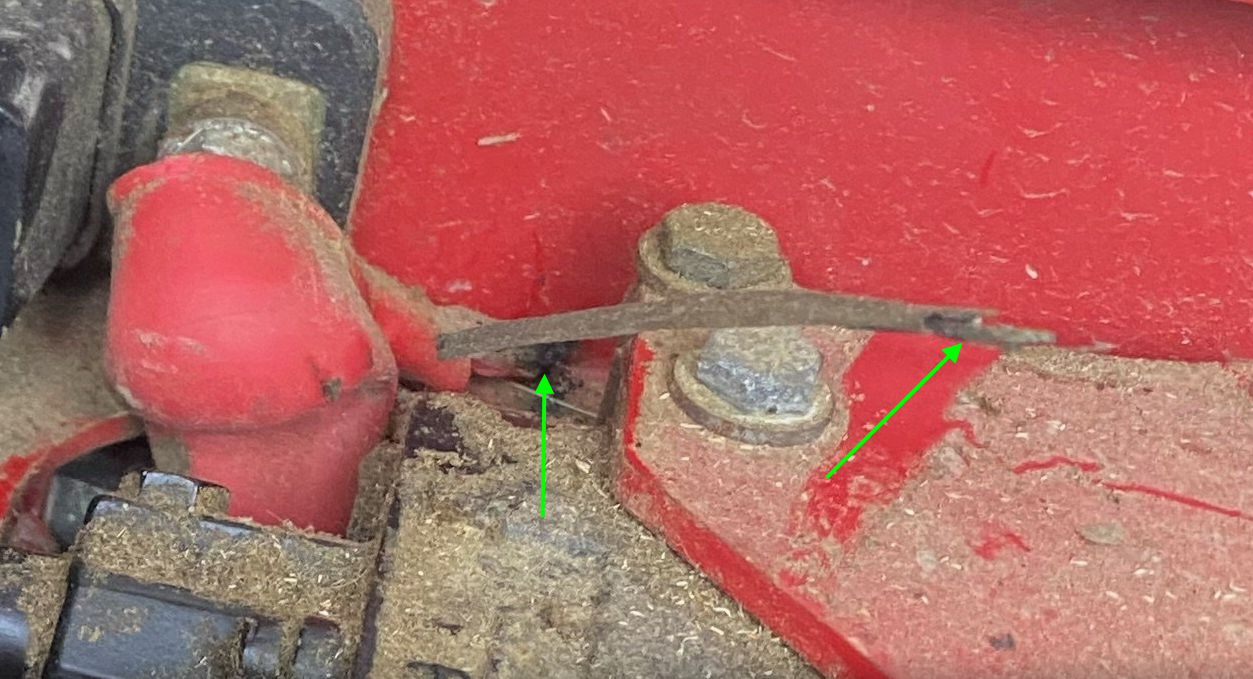

It’s not very clear, but your photos seem to show two wires with potentially charred ends (see green arrows below). Is that the case?

Thanks for the reply! No other lights come on TCM when turning key all the way, I just did continuity and resistance test on the to fuse (A) and it is good.
The charred wire is stacked on the stud behind the larger feed from the battery and seems to have run across this metal panel. Its very thin but you can see the black charring on the rubber insulator near the stud.

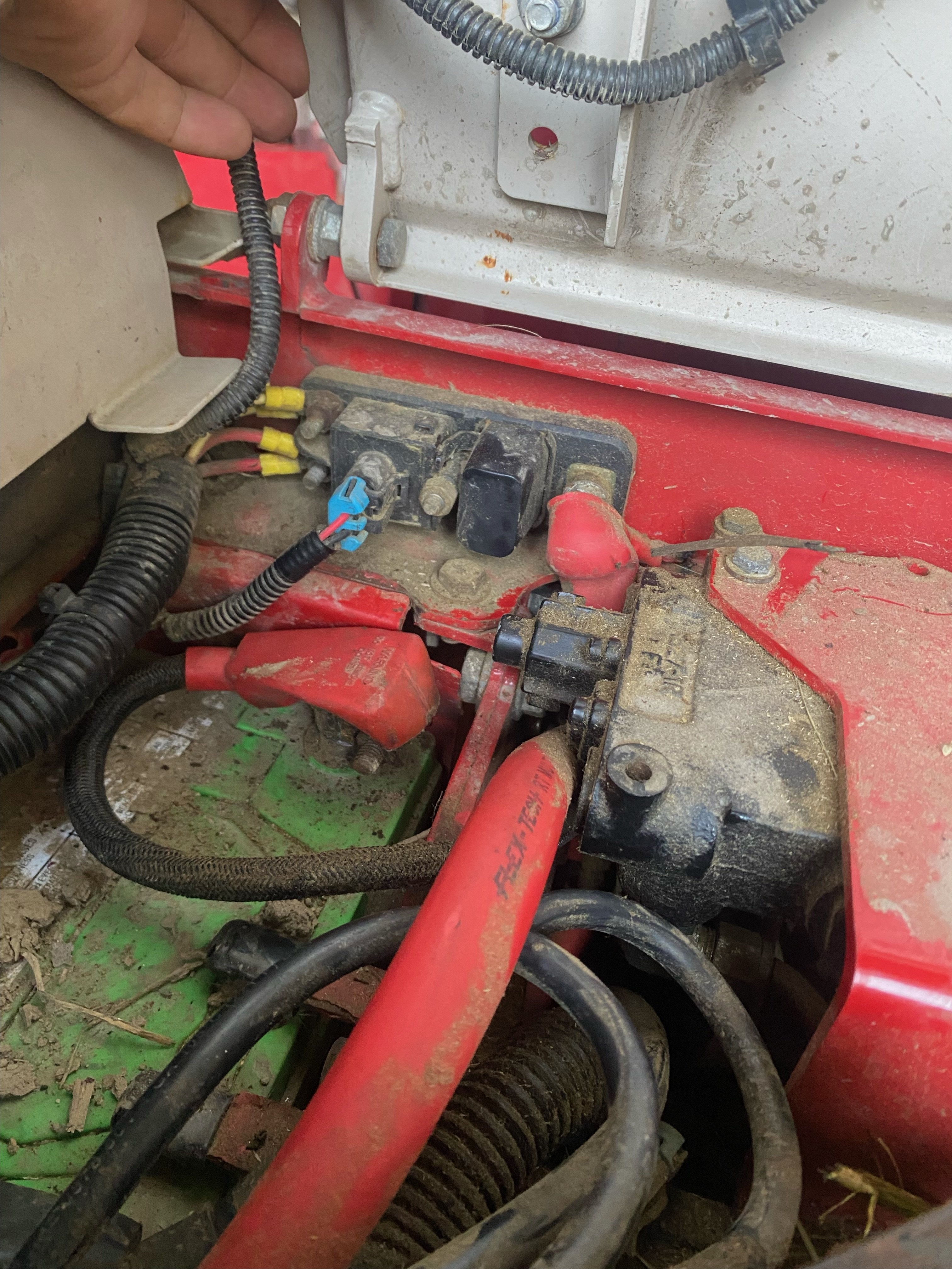

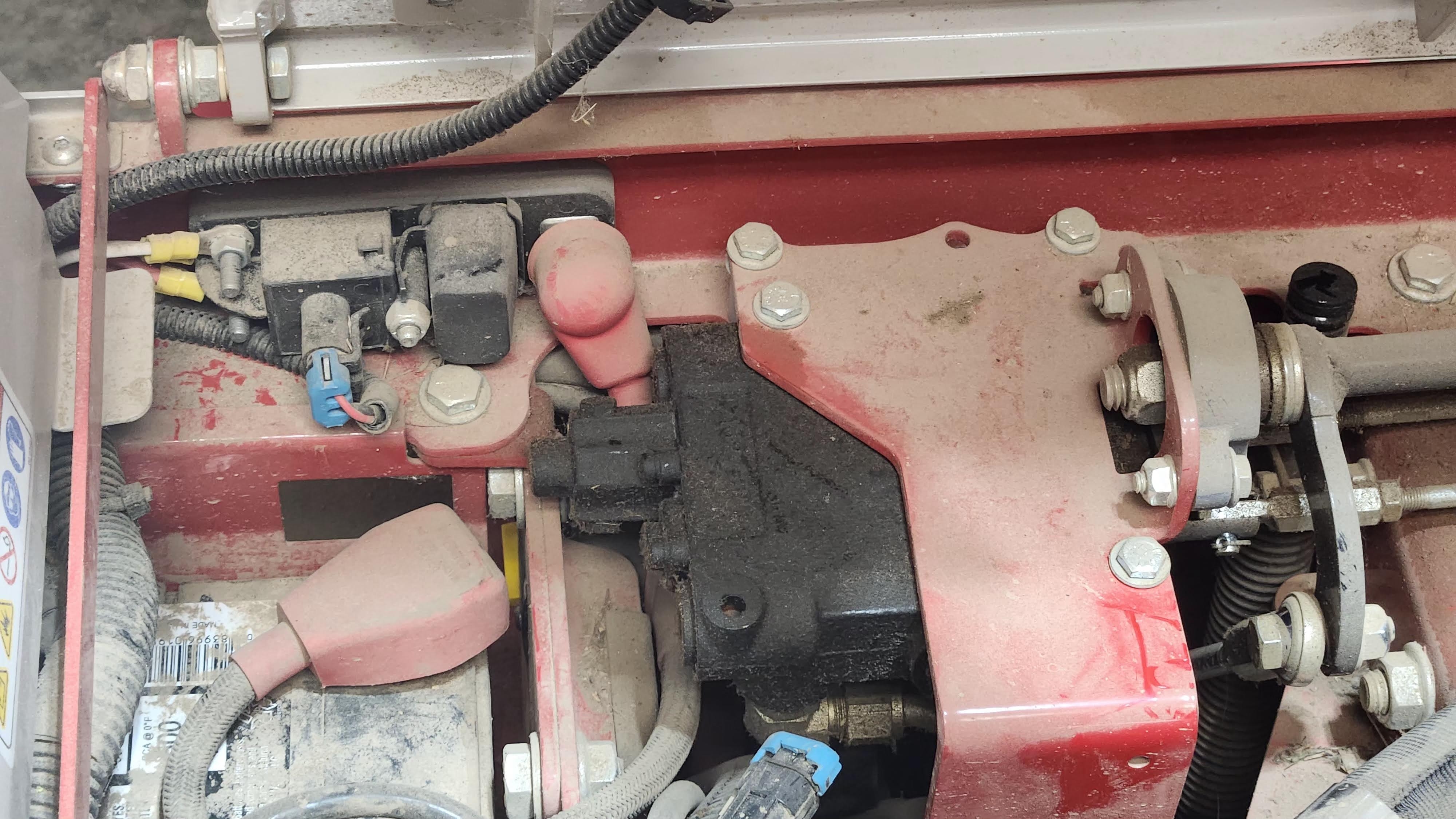

I also have the 4500p and that mystery wire is not on my relay control module either. According to the wiring diagram that I have, there should be only one wire to this terminal. This single one big wire is the direct power feed to the entire tractor.
This relay control module that the one feed wire is bolted to exists to fuse and protect and distribute power to the remaining tractor harness from the hundreds of amps of power that the battery can provide in the event of a direct electrical short.
I'm very concerned that what has happened here is someone has added an unfused power tap from this battery connection terminal. Then while you were mowing, something in the front harness shorted to ground, allowing hundreds of amps to fry this wire into oblivion.⚡ An unfused direct short to the battery is extremely dangerous.
What is most concerning now is the no power situation to your front harness. This makes be think that the wire that is originally supposed to feed the front harness from the factory was damaged or cut or chewed through and the previous owner bypassed the damaged wire with this new wire that he ran from this unfused terminal location to feed the front harness. If this is what has happened, it is a very reckless and dangerous thing to do.
So what to do? I would take it to the dealer. If you tried to replace this wire, you would be risking the same situation to occur with potentially a worse outcome. Batteries exploding on direct short are rare, but they can and do happen. Also, that foreign wire could have damaged other wires as it became a red hot molten pile of liquid metal. The overload could have also burned up other components if the short was down line from that component.
I suppose if it were me, I would try and trace down where the melted wire ran to and maybe calculate current draw and properly inline fuse and size a replacement wire, but even then I would have strong hesitation. There could very well be other severe damage from the overload and other components may need to be replaced.
Maybe contact the original owner and ask about this mystery wire? That may give you more insight as well.

You mentioned earlier that the mystery wire was "very thin". Is that because it was burned up so that little is left? If the wire really was thin to begin with it seems unlikely that a previous owner would have used it as a bypass around a damaged OEM main feed from the battery. I had thought that it might have been used for a battery maintainer, although that would have only worked if the disconnect switch wasn't used.
/ Ventrac 4500P wont start
#11
You mentioned earlier that the mystery wire was "very thin". Is that because it was burned up so that little is left? If the wire really was thin to begin with it seems unlikely that a previous owner would have used it as a bypass around a damaged OEM main feed from the battery wire. I had thought that it might have been used for a battery maintainer, although that would have only worked if the disconnect switch wasn't used.
very thin gauge to begin with.. it looks like it fed across the seat plate into where the drive controls are.
there are some buttons and switches on the handle that have never worked, maybe it was an add on there, not sure?
