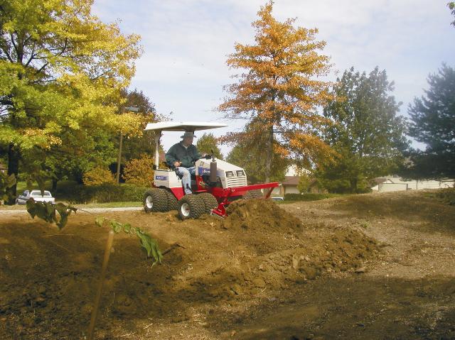

As I have indicated several times before on this forum, I believe the Ventrac was conceived to excel at turf operations on steep slopes with secondary consideration given to loader operations while the PT is just the opposite.
Given that, the VT is capable of impressive performance in small scale dirt work. For example, see the photos of the recent demo of the loader and excavator at the Louisville EXPO which I posted a couple of weeks ago.
One key for using the Slip Scoop for excavation is to set both Weight Transfer Springs to maximum. This increases breakout capacity dramatically.
See attached photo of me grading and reshaping a clay bank. Although not visible, there is a tooth bar attached. I had it made to improve digging and ripping capability. I remove it for finish grading. A closeup of the toothbar is shown in the following reply.
JackIL

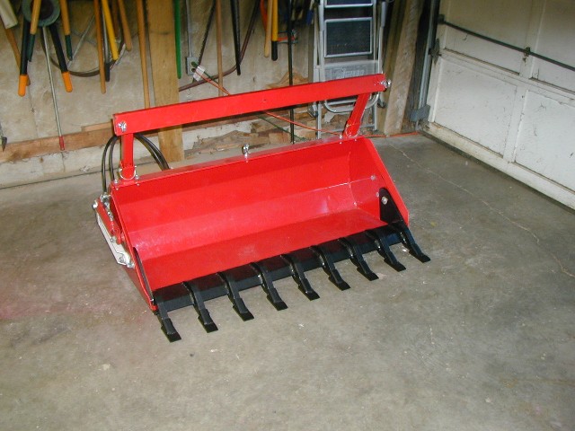

Toothbar fabricated for Ventrac Slip Scoop
