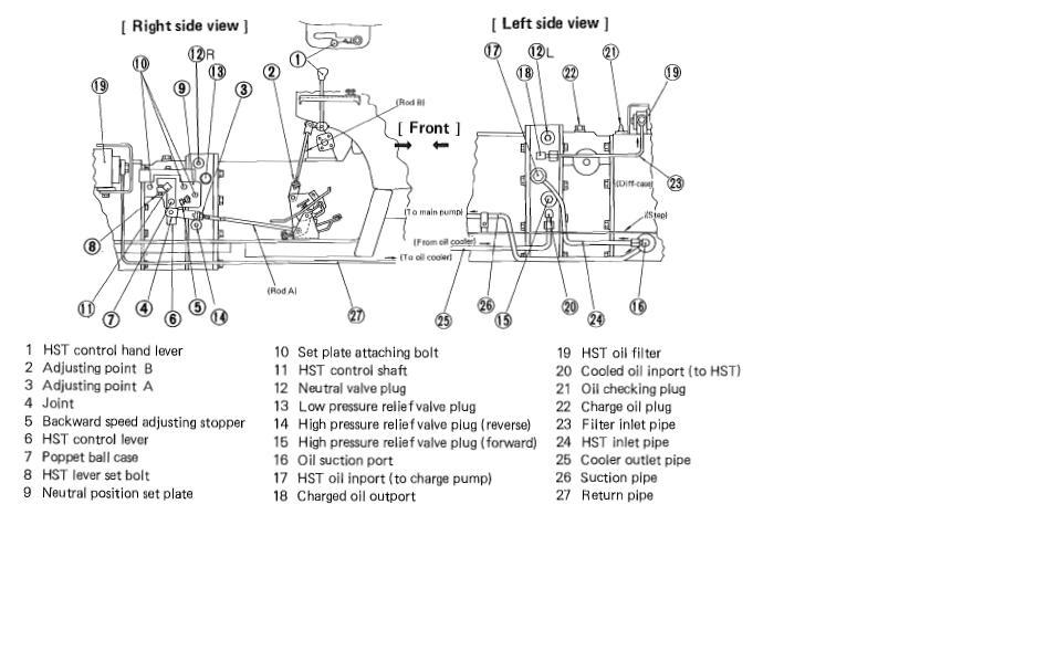

Here's a picture of the HST. You can see the canister filter, a thumb screw cap and a big square plug.
The thumb screw is where you check the reservoir oil level. The big square plug is where the swash plate
moves back and forth.

I took off a guard around the spin-on oil filter and found that the lines I was following
crossed under the cover.While it didn't give any better results, it cleared some things up.
The oil filter is fed by the "charged output" port of the HST. After the filter oil flows to the cooler
and then back into the HST. This external filter in no way affects the 3PH or the charge pump lines.
The oil that goes to the 3PH returns to the reservoir somewhere internal to the assembly.
This explains why the 3PH works even though there appears to be no oil in the filter.

oldnslo,
Thank you for the reply.
I'm attaching some pics I hope you can see them in large format.
They will show a label side to side image.
A system schematic, and an oil line routing.
Yes the HST is a closed loop system.
The 3PH is also a closed system, however they share the same reservoir and charge pump.
The oil line routing for the 3PH is exactly the same for the gear type unit as the HST.
Adding HST includes charged lines to the oil filter and the oil cooler.
The HST oil pickup is a shared line with the charge pump.
When I look into the square plug (#22) on the HST I see the piston retainer and pistons
as well as the swash plate.

Oil lines #18, #19, #20 are the charged oil output to filter and cooler.
For whatever reason they are not shown on the oil line routing page of the manual.
I do not believe there is any oil flowing through them unless the wheels are turning.
I cannot confirm that as I can't keep them engaged long enough.

First: The HST charge pump is separate from the main pump and not part of the 3PH. Look at the post of right side and left side views You will see the lines to & from oil cooler. These are the charge pump circuit. On the page labeled Hydraulic system it shows the pressure line from the oil pump running parallel to the cooler line and using the same hold down clamp. This is your 3PH and or auxiliary valve oil supply.
Diagnostic steps based on the schematic posted:
I suspect the HST charge pump is built into the HST pump. This is a common practice on some HST models.
Per the schematic: The charge pump flow goes through the oil cooler, then the filter and then to the check valves (item 5). These check valves direct the oil to the low pressure side of the HST. Item 12 the low pressure relief controls the charge pressure.
Things I would check if possible:
1) Can you access the inlet screen/ strainer for the charge pump. I would guess it may be under item 16. I would suspect you will have to drain the oil to check this. If gutsy or stupid like me, remove line 24 and see if oil comes out freely from item 16. No or slow oil flow would indicate the screen/strainer is plugged. Once you are 100% sure this line is open go to step 2.
2) Do you get oil of the line on the right side of the tractor going to the oil cooler? Remove this line and point it into a bucket. Crank the tractor over for a few seconds to a minute max. Do not see any item numbers for this line. If you get oil flow out of this line go to step three. Reinstall this line and go to step three.
3) remove the outlet line from the cooler (item 25) and place it in the bucket. Operate the tractor again. Do you get flow out of this line? If no the cooler is plugged and blocking the flow. If yes reconnect this line and go to step 4.
4) Remove the oil filter inlet line (item 23) and point it into the bucket. Run the tractor again. Do you get oil out of this line? If no the oil path is blocked in the tranny housing between the cooler return line and the filter inlet line. If yes you will need to obtain a pressure gauge and some fittings so that you can take some pressure readings.
Pressure reading would be need to be taken if possible between the filter and the check valves (item 5) Low or no pressure here would indicate a faulty charge system or a badly worn HST pump or motor or both.
The schematic shows the "neutral valve" as what I believe is a "hot-oil-shuttle" valve. The purpose of the "hot-oil-shuttle" is to dump the excess charge flow from the low pressure side of the HST main circuit at a lower pressure than the low pressure relief (item 2). This keeps a constant flow of cooling oil in the HST and also aids in flushing contaminates from the HST.

oldnslo,
thank you for the time and your reply.
I see now where my mistakes began. The manual which is clearly a foreign writing translated into English,
calls things by several different names throughout.
The "oil pump" or "main pump" that is driven by the engine is also called the "charge pump" in some sections.
Until I re-read your post, and then looked closer at the exploded view, I didn't realize that the real charge pump is in fact inside that HST assembly.
I have a 5000psi guage set but have not made finding fittings a priority.
I'm 95% done with the removal process. Several conclusions led me to take this route rather than further
guessing and assumptions.
1) wire mesh filter in reservoir is clean and particle free.
2) all oil lines and the cooler are clear and open.
3) I ran the engine with low pressure relief valve removed, no oil came out.
4) I ran the engine with neutral valve assembly out, no oil came out.
5) As no oil is coming out of the charged output line, the oil filter is not being filled.
Conclusion.......
The internal charge pump is not pulling in oil and therefore is not providing motor with fluid.
Either because of failure or obstruction of pump or check valves.
