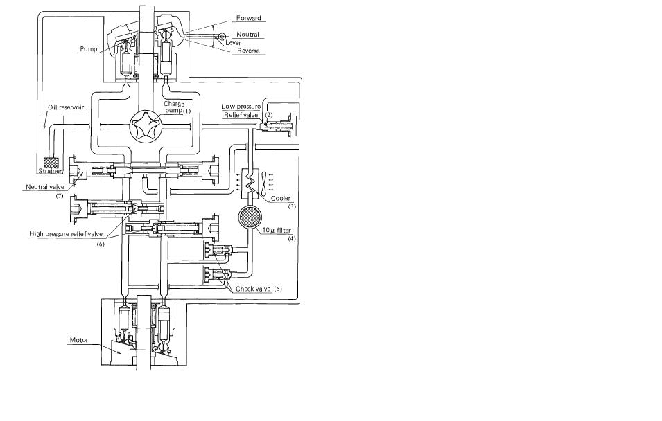

Anyone know how to take 1-2 thousandths off the valve slide without putting it in a lathe?
The one high side relief valve is still too tight for me.
I want to clean it up without leaving any marks.
Not sure how to do that.
thanks

If you don't have a lathe and this has to be a precision fit, I would bite the bullet and take it to a machine shop and have them lathe the .001-2 off. Shouldn't cost much at all and with the scarcity and price of parts there's no way I'd take a chance of jack-legging it at this point. If the "slide" body is not acting as a piston or otherwise an extremely accurate fit, could you chuck it in a drill press and use progressively finer grit emory cloth to take a little off it?

I have a lathe, but it is far from new.
I also didn't want to leave jaw marks on it.
I'm going to try putting it in a drill and holding fine steel wool on it. I think this will leave less marks than emory
cloth; but I really am not sure.
By using a science scope, I have a preliminary dimension drawing of the two parts. I wanted to get some idea
of having the new parts duplicated before installation. Not sure if it's enough because most shops prefer an actual blueprint.
We'll see.....
Plan is to put things back together this weekend. Keeping my fingers crossed.
