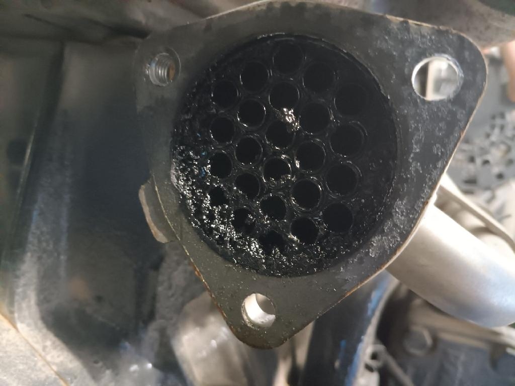

Leaking EGR coolers is a known issue. My dealer has replaced several of them. It can be verified by removing and inspecting the EGR valve. Sometimes they have green coolant in them, and sometimes baked on coolant that looks like black shiny varnish. There should only be dull black soot, not shiny varnish. The DPF can be inspected by removing the ends from the canister. There should only be dull black or dark grey on the surfaces inside. Coolant contamination will cause brown stains and can not be cleaned out by doing a regen. I have a picture of it but can't find it right now. If there is lots of brown in there, the DPF has to be replaced because regens will not remove it. The 5 year emissions warranty will cover it even after the 2 year full warranty is over.
   / MT357 Codes #14
I finally found the picture of the DPF with coolant contamination inside. It should only have dull grey or black in it, brown stains are from coolant. No amount of regens will clean it out, so it tells the ECU that the soot level is still too high after a regen, so it wants to regen again. This one was caused by a leaking EGR cooler which is in the other picture. You can see the shiny varnish from baked on coolant. Sometimes you can see green coolant in there too.
