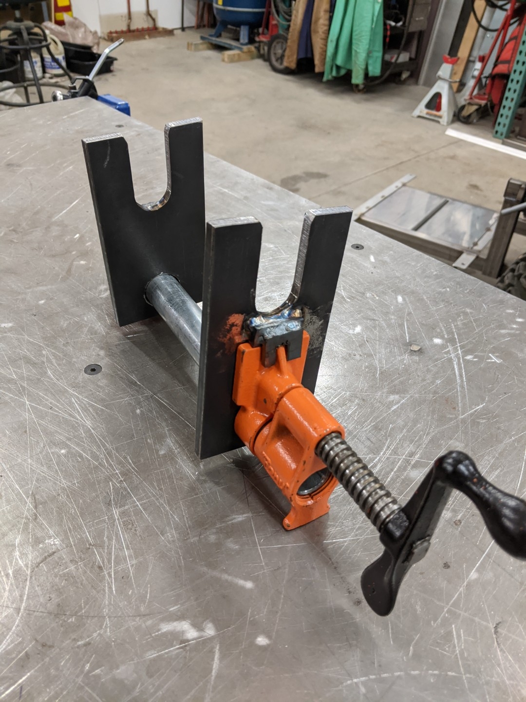

Is there a trick to manipulating the hydraulic connectors with a 3rd function diverter valve?
I find that taking the grapple off & putting it on is iffy with the ag connectors because of the pressure in the grapple lines.
Should I swap to flat faced connectors if this bugs me?

Not sure which ones it is, but mine have a pointed like end. when they are hard to put in I pop the pointed end on the side of the tractor and let some juice loose... Works great for me.

I have the same issue with flat faced connectors. Best way I found to avoid it is to turn off the tractor and cycle the hydraulics several times to bleed off any pressure. Still have to crack a hose on the grapple occasionaly to bleed off pressure.

When I install my grapple, I shut the tractor off and cycle the valve to relieve all system pressure. I always keep the grapple hoses connected to each other when it's off the tractor. I have never had a single issue with connecting the grapple this way.

Hydraulic connectors all seem to suffer from this. I made a bracket for a clamp to help. I can often get one of them to connect or very close and then use the clamp to pull it closed. But I also turn the tractor off and then back on to the first position (electricals on, engine off) and then I cycle the diverter a few times to relieve pressure. When I am fighting a connection, I get the clamp on it, squeeze it a bit, go back and cycle the diverter, go back and add more clamp pressure, repeat until it clicks on. I later found out someone makes a similar tool from a bar clamp that you can buy. It would be better on a bar clamp as the jaws sometimes want to spin on the pipe.
