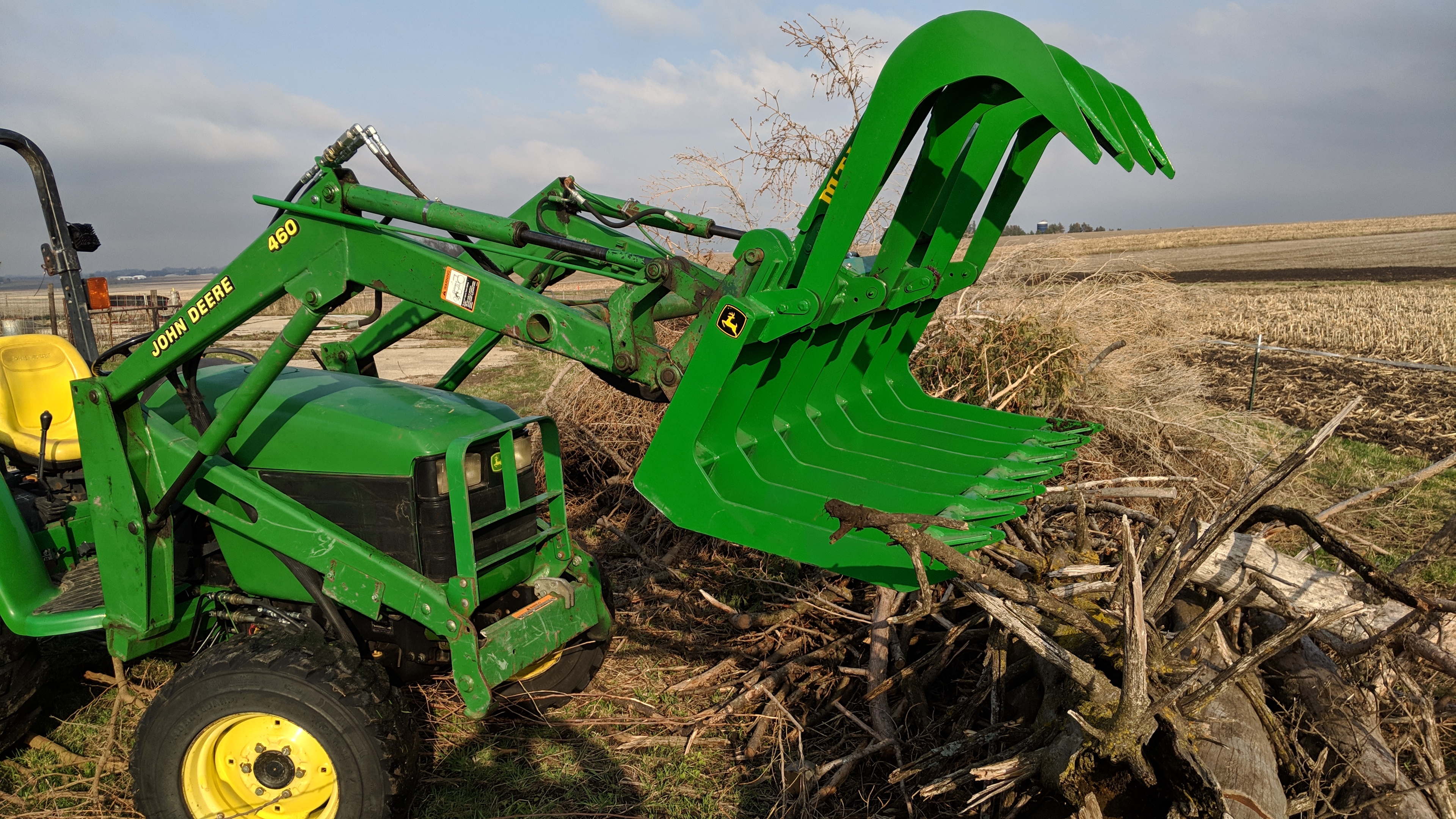

Ordered the 60" root grapple from MTL attachments last week for my JD4600. It should be delivered today. Bill of lading shows 490lbs. I'll be adding a diverter valve to get the 3rd function on the loader too. I'll throw some pictures up later for others that may be interested. I'll put up some pictures of the valve install too.
/ MTL Attachments Root Grapple
Took about a week to process the order, then about three days to ship to Iowa. It was delivered by R&L Carriers. They gave me a window between 10AM-4PM that it would be delivered and the driver gave me about a 30 min heads up. Little difficult when you work away from home, but made it work out. It came wire banded to a regular pallet. Was able to use the loader quicktach to pick it off the semi.
Overall, I'm really impressed for the price. Welds are mostly good, with the exception of the quicktach pins not having full beads, but I don't foresee this being an issue down the road. Paint is ok, could be better as they missed a couple small spots on the bottom. No issues with fitment on the JD loader mounts. I think I'll be happy I went with the 60" version and not anything bigger.

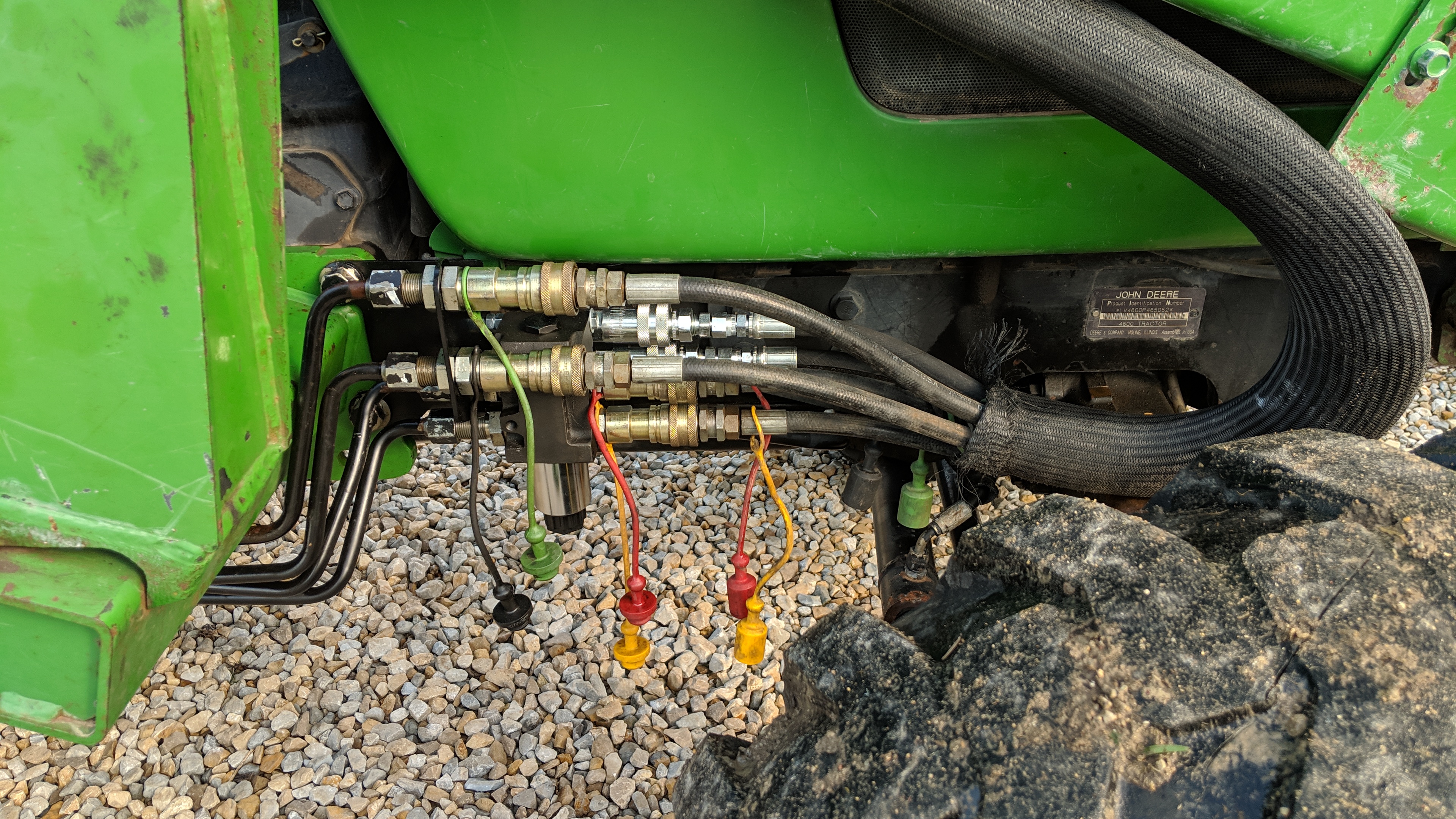

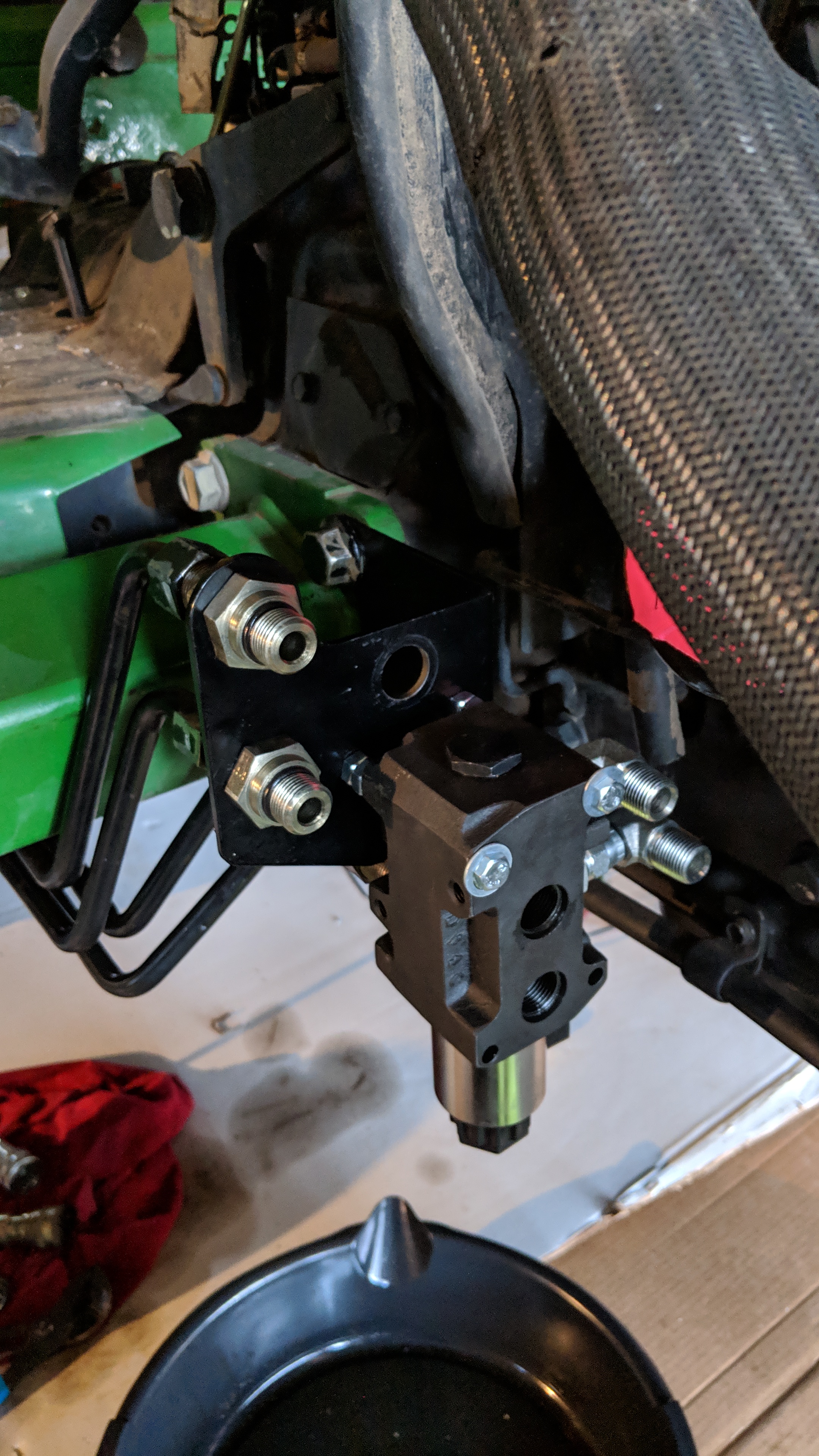

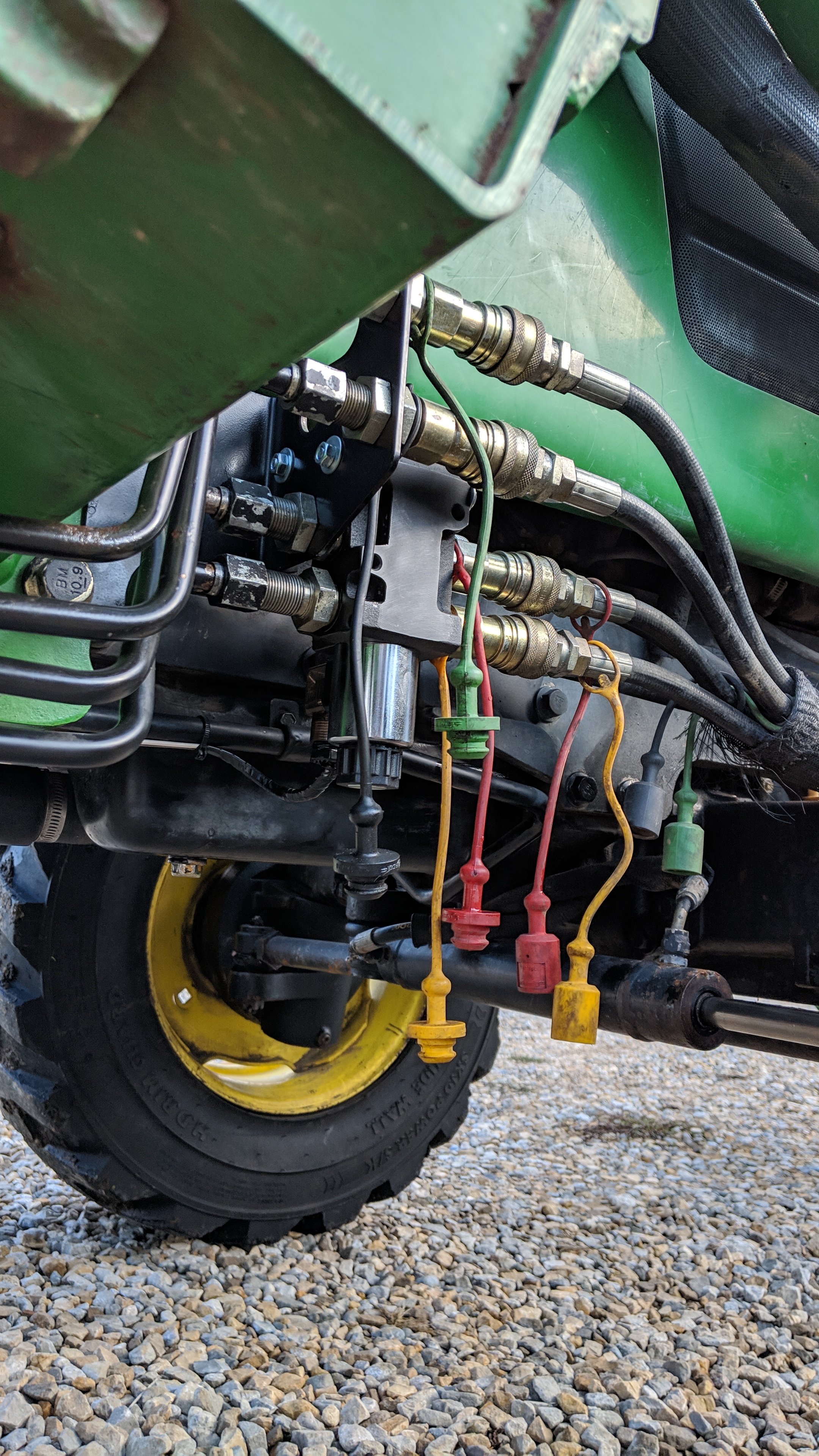

My 4600 has a third SCV already mounted, but doesn't have the lines or cables to actuate it. JD used to sell a kit, but it puts the lever up on the right fender. I would rather have a button on the joystick, so I'm going my own route with a diverter setup. Ended up doing hoses for the loader instead of hardline too. I'll put up a final list later, but think I'll have ~$140 for the valve, ~$140 for fittings/hoses, and another ~$50 or so for the electronic bits.

Hey Spudman - - nice looking unit. Brother - wherever you are - you got NO mountains. First pic - post #3.
/ MTL Attachments Root Grapple #6
... also Pic #1: you may want to get that grill guard filled in a little better before your JD loses an eye! :laughing:
She could use a bath too! Maybe someday soon now that this winter is almost over.

Got to work a little on installing the diverter circuit. Cut up some angle iron to make a bulkhead for quick connects at the end of the loader. Drilled a hole to mount a button in the handle and carefully drilled a small hole to route wires through. Hopefully get around to mounting the valve next week.

Got everything buttoned up tonight. Had to rebend a couple of the hardlines to fit the valve placement. Really happy how the line routing turned out and how the valve is tucked in close to the tractor. I'll need to practice a bit to get a full grab.

Looks real good and you saved a lot of money over some of the Brand X grapples out there to boot. Grapples are fairly basic, no sense spending too much on them. :thumbsup:
