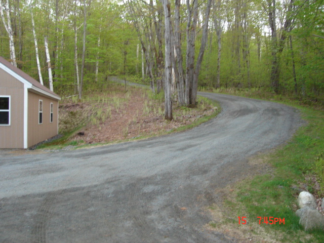

When I built my house, I had a very talented one-eyed (no kidding!) dozer operator do the septic, driveway and major excavation. We were on a limited budget, so when he said that "the driveway was going to cost extra" I flinched but trusted his judgement-- we live on a north-facing slope, with springs uphill from my lot and a layer of clay about 3' below the surface.
What he did was:
1. Cut a drainage ditch into the slope near the top, leading diagonally away from the driveway into the woods (on rt, in photo)
2. Dug the driveway down about 3'
3. Added 350 tons (!!) of 5" stone, followed by 150 tons of "hard-pack." (Driveway is about 200' long.)
I thought it was overkill, but every spring it feels great to get off our muddy road and onto my solid driveway! I've also had to have it touched up only two or three times in 23 years- others in the same area have experienced major washouts. He did not use any fabric.
He also said we needed to put in foundation drains on BOTH the inside AND the outside of the footings, something I hadn't ever heard of... but have always enjoyed a dry cellar.
Bottom line, yes, it cost more, but was well spent money. He also explained, and I'm not sure why, that you can't fix a wet driveway by adding stone when it's wet-- stone will just keep sinking-- but if you do it in the fall, the same amount of stone will stay put. Anybody know why? It has certainly worked....
What he did was:
That is a nice looking driveway. Do you have to groom it often. I'm guessing the excavator isn't around anymore? Mine was not done right the first time and when I win the lottery I plan on tearing it up and starting over.
That's what I'm afraid of - dumping a bunch of crushed stone (and money) an it still being not driveable.
Irving - great looking driveway, it looks like you've got a great location too.
- Marty

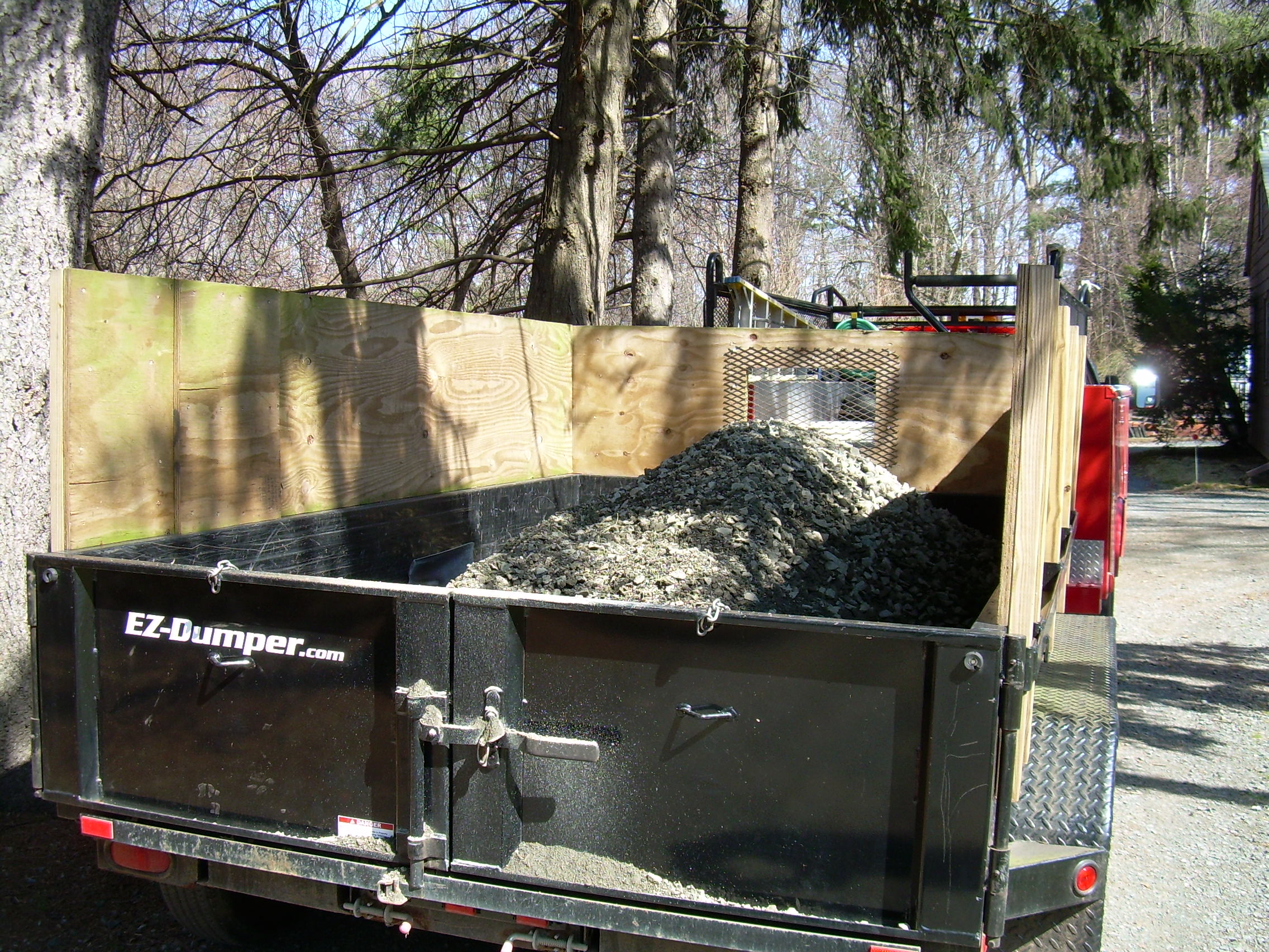

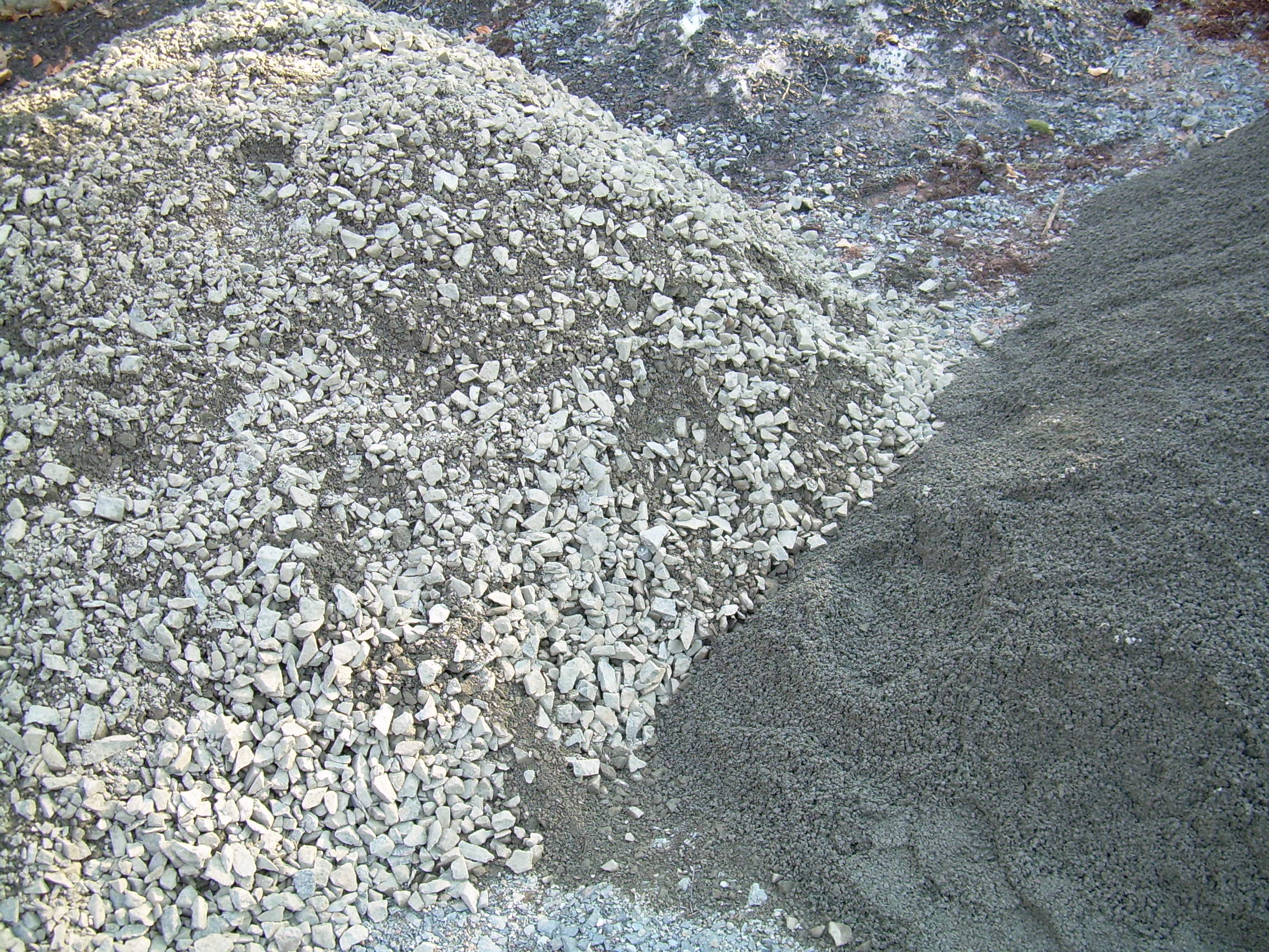

I go through this every spring especially as I'm expanding my gravel drive and parking areas, I add what we call here small process which is 3/4" stone mixed with small size pcs down to dust. packs like a son of a gun, I dig out just the surface mud down maybe 4 inches and lay this stuff in 4-6 inches, if there's still frost down under it, it will take a while to firm up but next year you wont have a problem in that same spot.
I just got about 8.5 tons of process yesterday and 4 tons of dust to finish the top, the dust or screenings when packed down and sealing the top of the process will not even scrape up with snow plow.
We have the highest quality Basalt trap rock around here, the process costs $12. a ton and the dust is $12,50 ton.
This stuff is as dense as it gets, the picture of the stone in the trailer is 4.5 tons.
JB.
