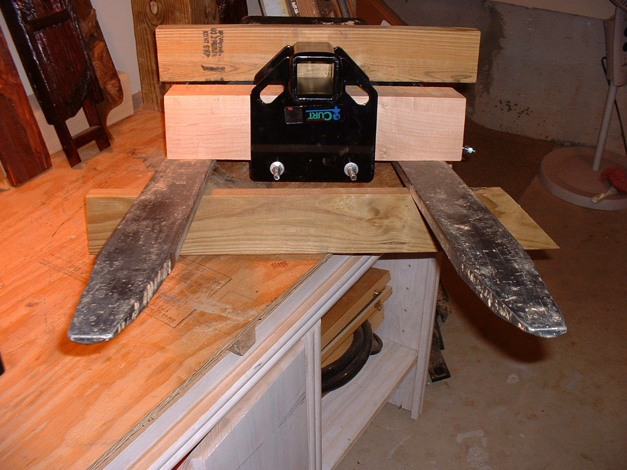

This is the start of a multi ripper attachment I am working on. I will be using the forks on my PT along with a 2 inch hitch setup. Not sure how well this will turn out, but since I have no welding equipment this is how I plan to go about it.
If it takes the stress of digging around tree stumps trenching, pulling up rocks and such then I will make other interchangeable attachments for it, such as an electric winch, towing adaptor and so on. I will update when it is done.

Other parts.

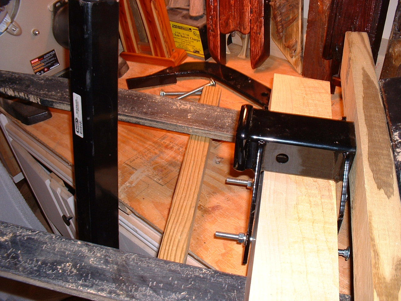

Another view.

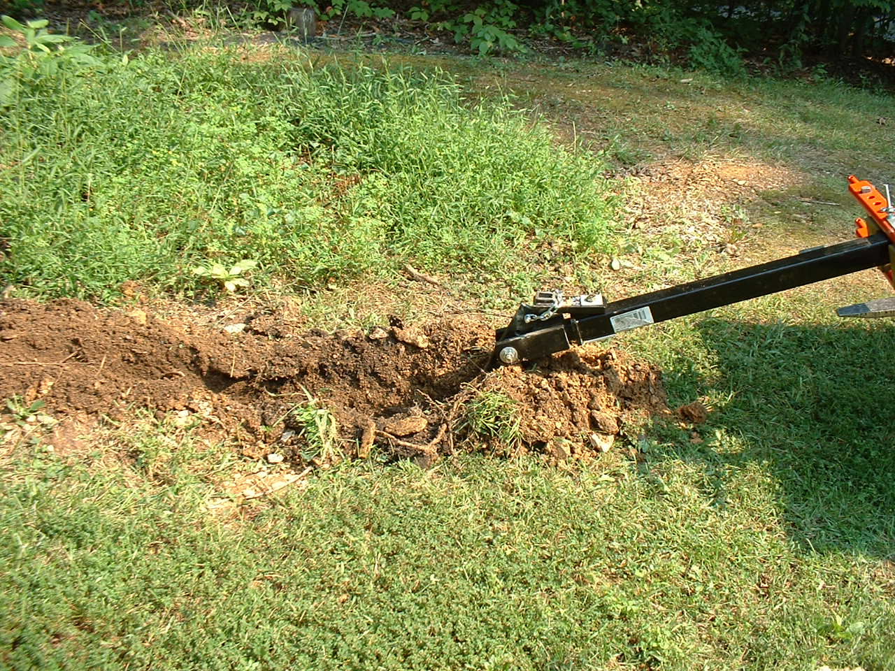

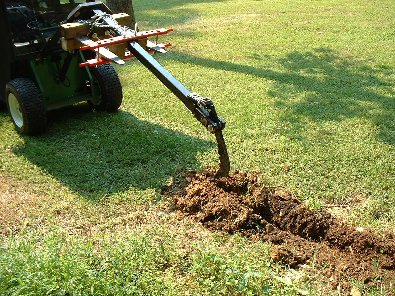

Just an update for anyone interested . I rigged my ripper attachment to the forks today, to see how strong the tube would be... plenty strong. I also ordered a shorter tube for closer work. It has a pin at the base to change to the shorter tube, and one at the front for other attachment plug in's, and a boom.
Since I don't have any welding equipment, this was the only way to test it out. I will be looking for a local welder in the next few weeks to weld this to an attachment plate with bracing. It will be great for trenchs, pulling up rocks and roots. First picture.

/ Multi ripper attachment
Making a small trench worked well.

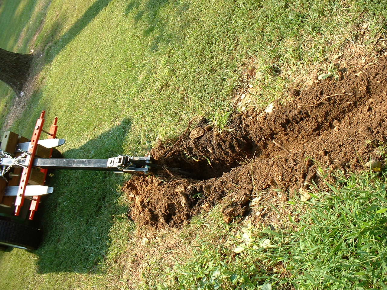

Another shot.

A little deeper.

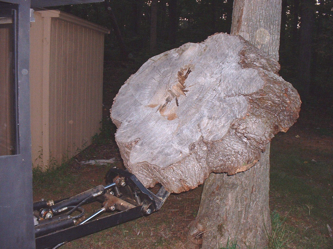

I took the truck into town and had someone help me load this 300 pound tree trunk into the back. I do rustic wood working, and plan to make a table out of this for my down stairs.
I used the PT, and forks to lift it out of the truck. I had to rest it against this tree to keep the the hydraulic bleed off from letting it down... while I took the picture. It's hard to tell from this picture the size of this thing, but I can tell you first hand it's really heavy.

Sure you could, would just be a matter of mating the right hitch tube with the right hitch elbow they make all kinds and angles. If you look at the picture on my second post of this thread you can see one setting on the work table I bought, that could be used for off set of the main tube.
You could probably use your fork like I did and mount it off to one side, but I'm not sure how strong the weld on the fork is for this kind of continued use.
As I said, I plan on having mine welded to one of my attachment plates. I bought most of my tubing, and hitches from Northern Tool.
