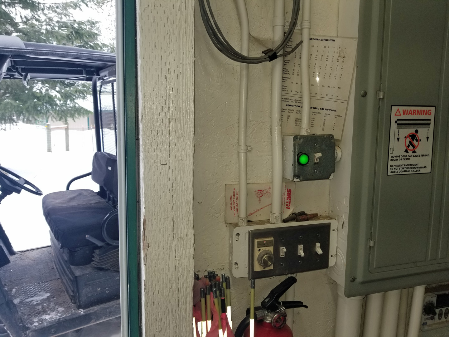

Make sure that you get a contactor with a 110v coil, many of them have a 24v coil. It's a lot easier to connect with the lights without having to get a 24v transformer.
Yes!!!! And some have a 220V coil. If you are duplicating my setup you need one with a 110V coil.
Good point Randy. I forgot to say that earlier!!! Thanks!!!

Usually just an electro-magnetic contactor and is used on large motors and fans.
It all depends on the amperage drawn.
That simple doble pole wall switch probably is adequate for most home style 220 VAC compressors.
Most toggle types will handle 15 amps per side, some rated at 20.

Amperage alone doesn't guarantee best service when it comes to motors that surge on startup. (All 'capacitor-start', ~7x)
Look for contactors that are rated for the horsepower of your compressor. The one I recommended is rated for 5hp.
I'm foremost not an Electrician. So I relied on the expertise of my Supplier. He asked me what Compressor I was using and the motor specifics. I couldn't give him that particular information standing at his counter. He Googled it and verified he was looking at my compressor. Then he read the specs and determined the contactor I would need. In this process he discussed startup. Which went way over my head. :)
Yup, and with your setup a contactor was the way to go. I set up a cabinet shop lighting system once that used over 100 of the 8 foot high output florescent lights ... this was years ago before led lighting and ceilings too low for hid lighting... To operate with only 3 regular light switches with the use of contractors. Otherwise the wall would have had maybe 14 regular toggle switches.
My arena lights are a series of 4 - 1000 watt MH and 4 -500 watt MH lamps all 240 volt controlled by a 4 way lighting circuit. Coil voltage is 120v. All I had to do was run the control circuit to each switch like a normal 4 way circuit and use a contactor. Easy Peazy.
