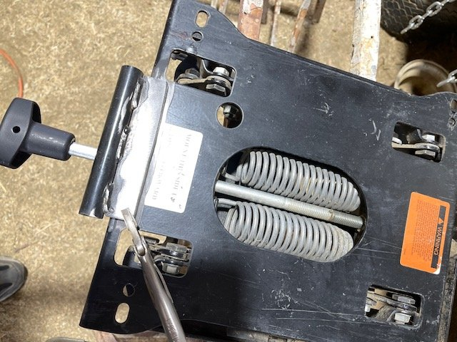

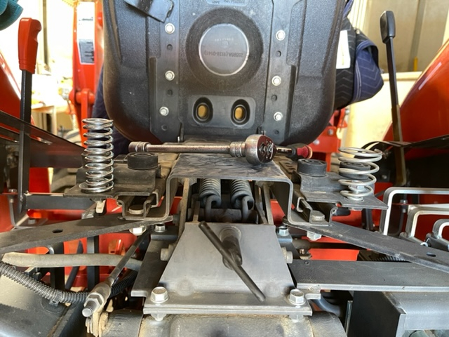

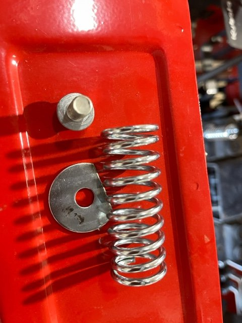

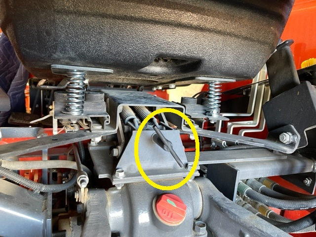

I found a seat suspension adjustment not shown in the operator manual. It is a T handle accessible from the rear of the seat. Mine was set so high that it was basically a solid seat. Had to break it loose from the paint to adjust it. While adjusting it and flipping the seat up and down I couldn't help but notice how useless the little springs were under the seat. You can compress them with one hand pressing in the seat. So I went to McMaster and ordered a couple of compression springs to try for my old back when mowing across the gopher hole patch.
Compression Spring, 2.5" Long, 1" Od, 0.76" Id
9657K32
I ground a washer down to fit in the spring. 1st picture
2nd picture new spring on the left
The last picture shows new springs installed and the seat suspension adjustment

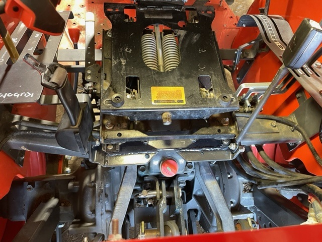

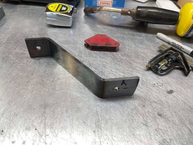

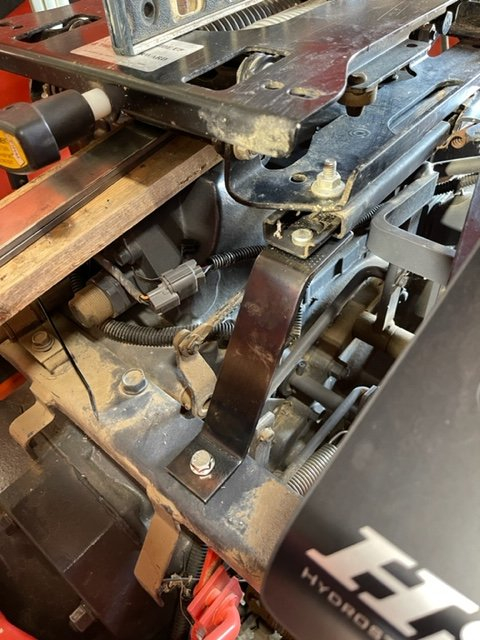

So I had some success and some failure with my ideas on the seat.
Success with the new suspension upgrade.
Failure with the swivel upgrade. I really wanted this to work. An I finally got it mocked up, took to the seat, and what do you know -
My right knee jam up against the draft control. The cab is too narrow. The rear controls too close to the seat to allow for the seat to swivel. I'll just have to live with what I got here.

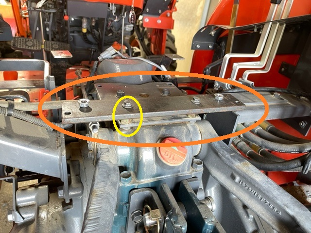

The suspension mod was a success. As I said I had a fancy suspension unit I took off a Tractor Supply seat mounted on another tractor last year. I cut, bent, and drilled 3 brackets to mount it and then cut and welded the Kubota seat hinge onto it and I'm in business again. With much better suspension and about 1 inch higher which works well for my 6ft frame. Just need to finish up with seat belt bracket attachment.

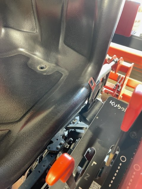

   / MX Seat

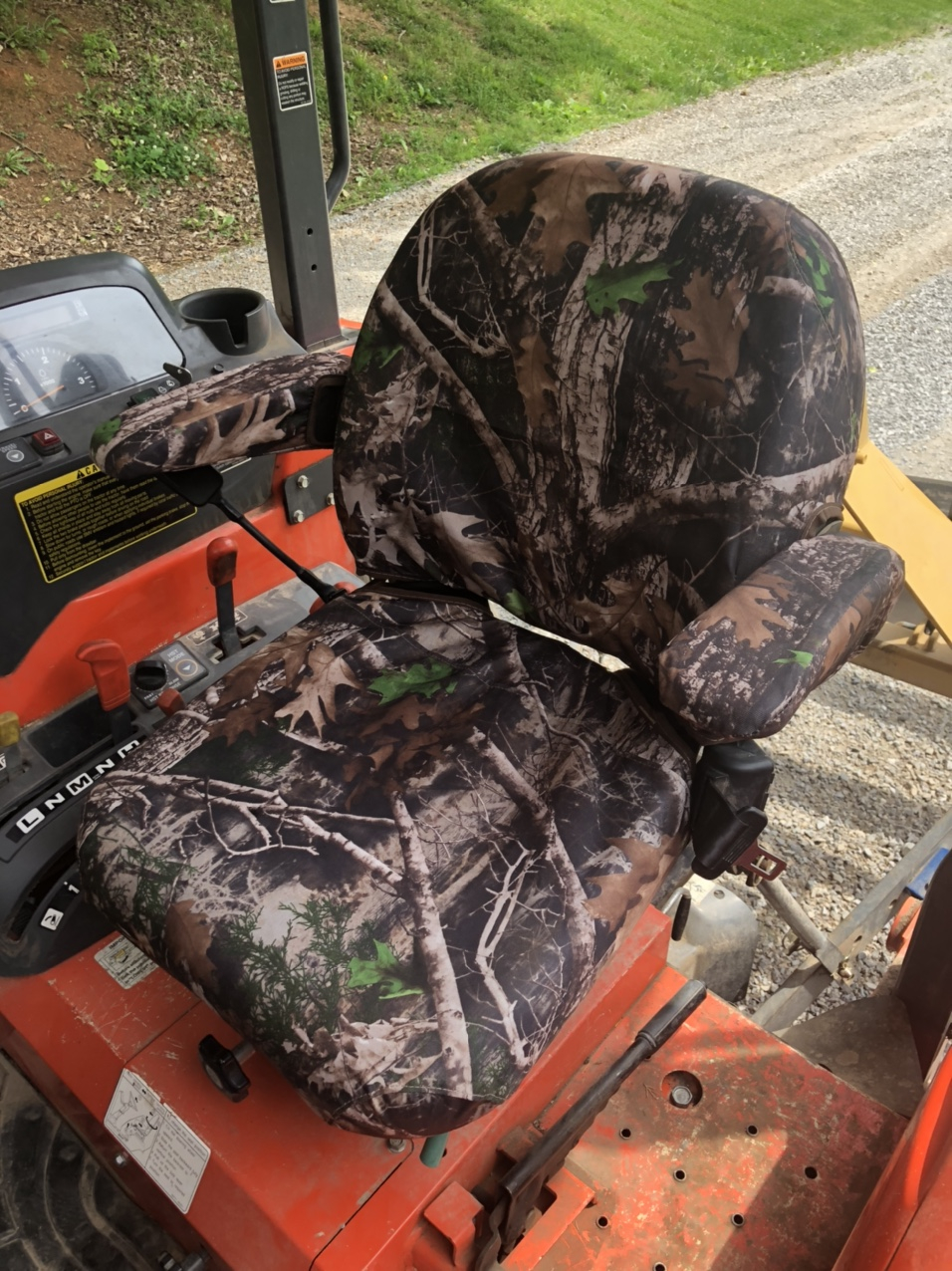

It's been awhile - the new seat suspension and height increase have been a welcome change. Today I finished up the modification by installing the seatbelt. I had just ordered some wheel spacers (a 2x3 set up from Bro-tec) to increase stability and reduce the rollover risk... then I thought well **** > I better put the seatbelt back on too.
