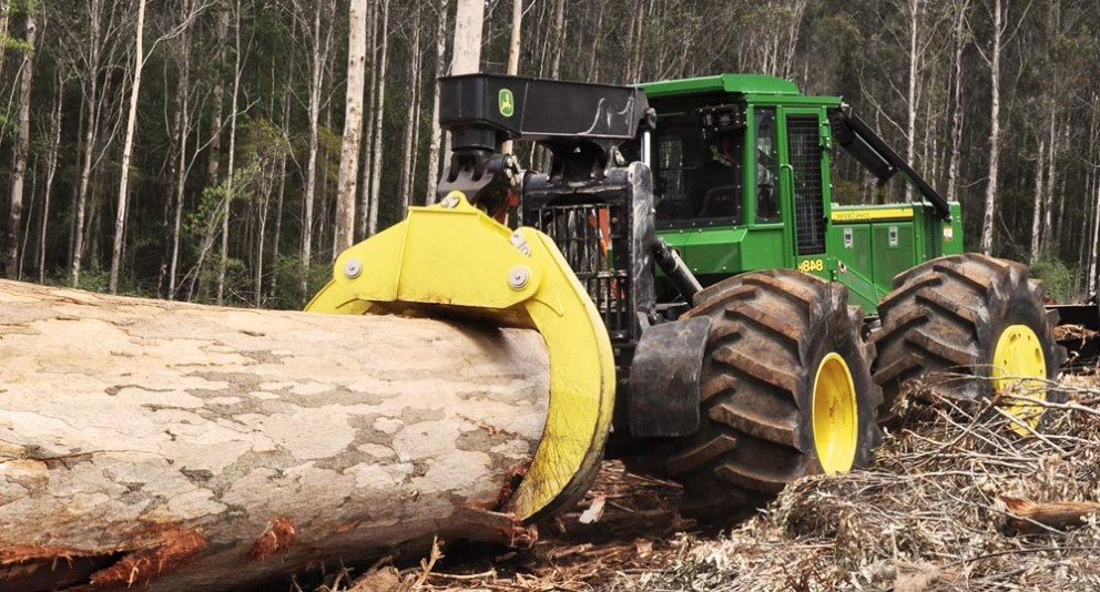

Took me all of 30 seconds to upload these. Google “logging skidders” and all you see is R-1’s on them. All I see out here are R-1s.
Besides, this is a tractor forum, not a logging skidder forum ;)
Another nice thing about R-1s is it lessens the need for chains.
You said R4s were for pavement. I guess log skidders are different in the Rocky Mountains than in your country. We have lots of rocks in the woods. But those skidder tires have thick sidewalls and are wide like R4s, not like ag tractor R1s. Most skidders do run chains.
