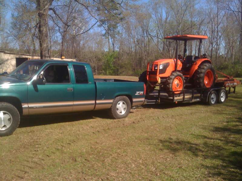

I have a 2007 m5040 its just the right size for me. Plenty of power shuttle shift and four wheel drive what else do u need

Tdcw4;
Wow that Silverado is overloaded where I come from...
Wouldn't want to get stopped by Ministry of Transport
/ MX5100 or Grand L40? #10
Maybe a bigger pickup to tow it with....:laughing:;)
