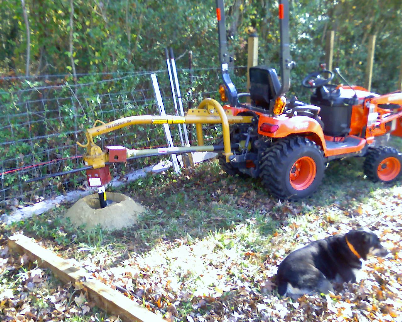

umm i cant get past 8" on my current 2 holes i have been working on. maybe ill take some vids
EDIT: maybe i am missing something or doing this wrong, the only adjustment that i have is on the lower right hand 3pt arm where it connects the the hydraulic arms of the 3pt hitch, the top part of the auger just hooks up where the normal upper link would go and is hard mounted there is not adjustment.
Pictures of your setup would really help us help you. Do you have any adjustment holes on the boom itself like mine in my picture below? I have 7 different positions to choose from. Too far to one end will cause the auger to drag on the ground while driving and too far to the other end will cause the auger to not dig very deep.
   / My 12" rankin auger sucks!!!
#15
I have only 2 holes for adjustment, the stupid thing is i have gotten it to dig a 36" hole before it just took me 20 mintues.
so i know it can go that deep, it just takes forever
