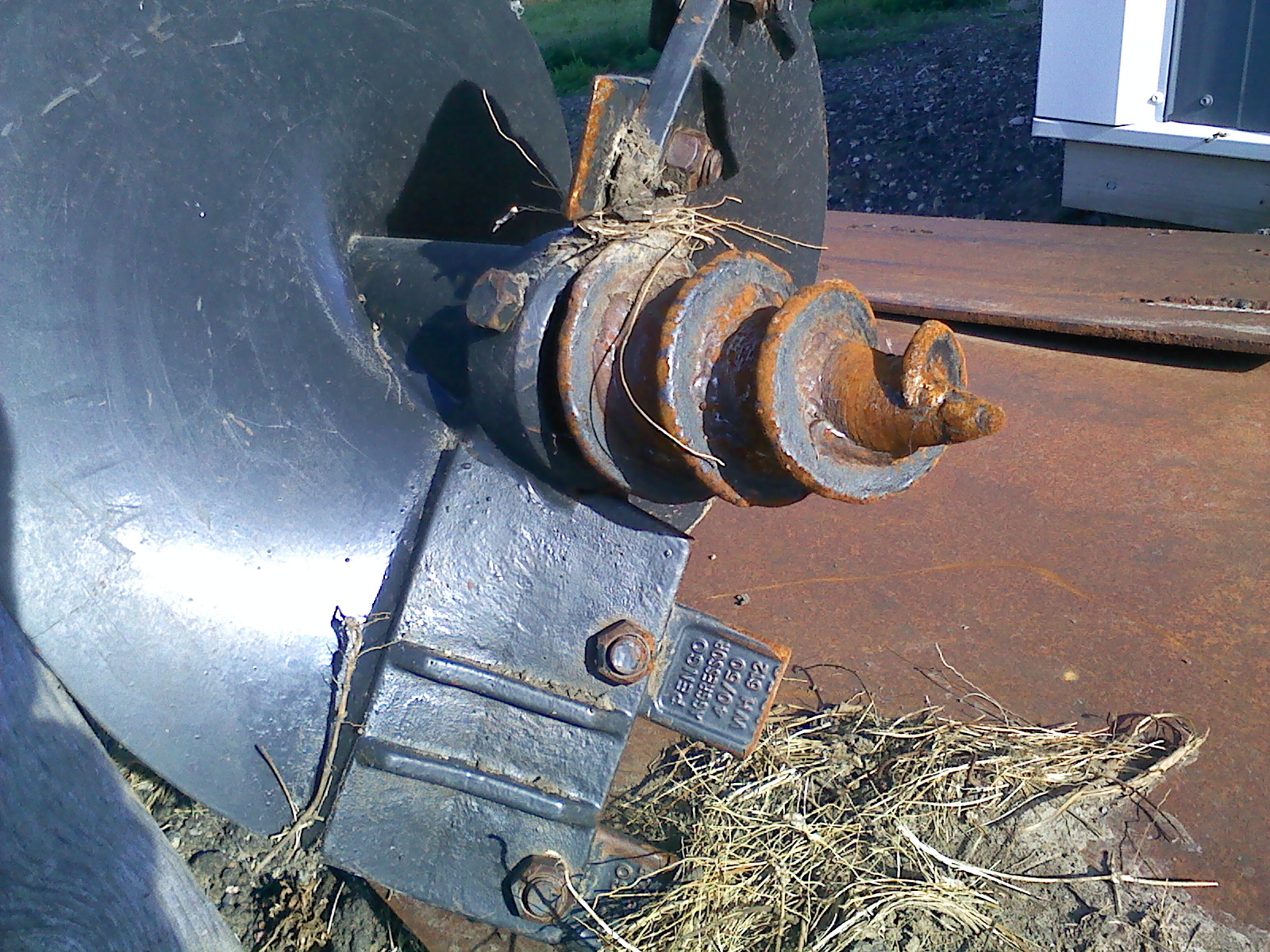

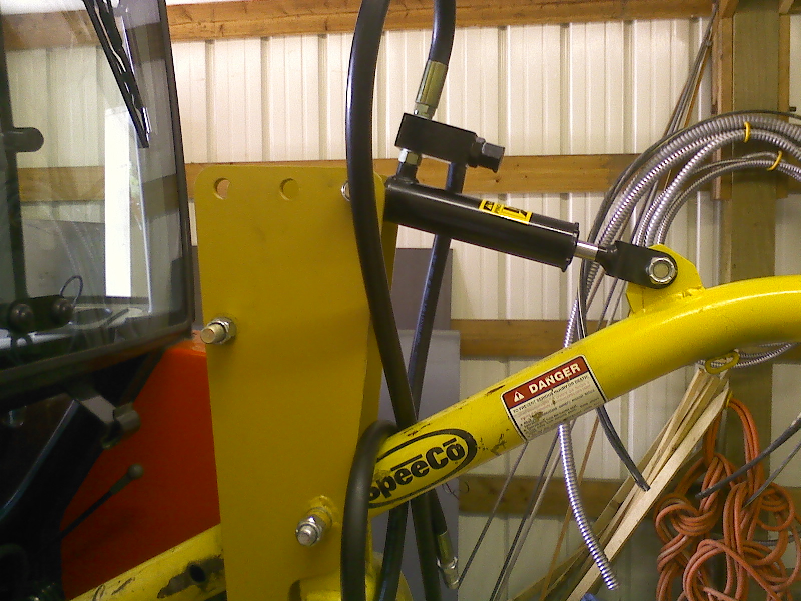

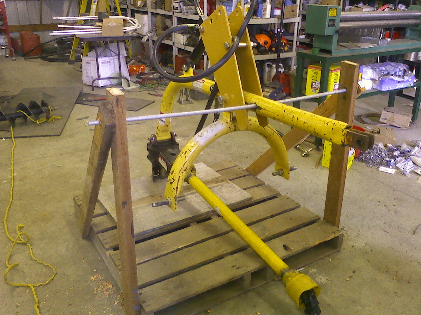

the ground in the video does not look very hard at all. I have rocky and decomposed granite soil here, and my post hole digger digs way faster then yours does. I added a hydraulic downforce kit to mine, and now its really fast. My auger has the twirly tip to it also.

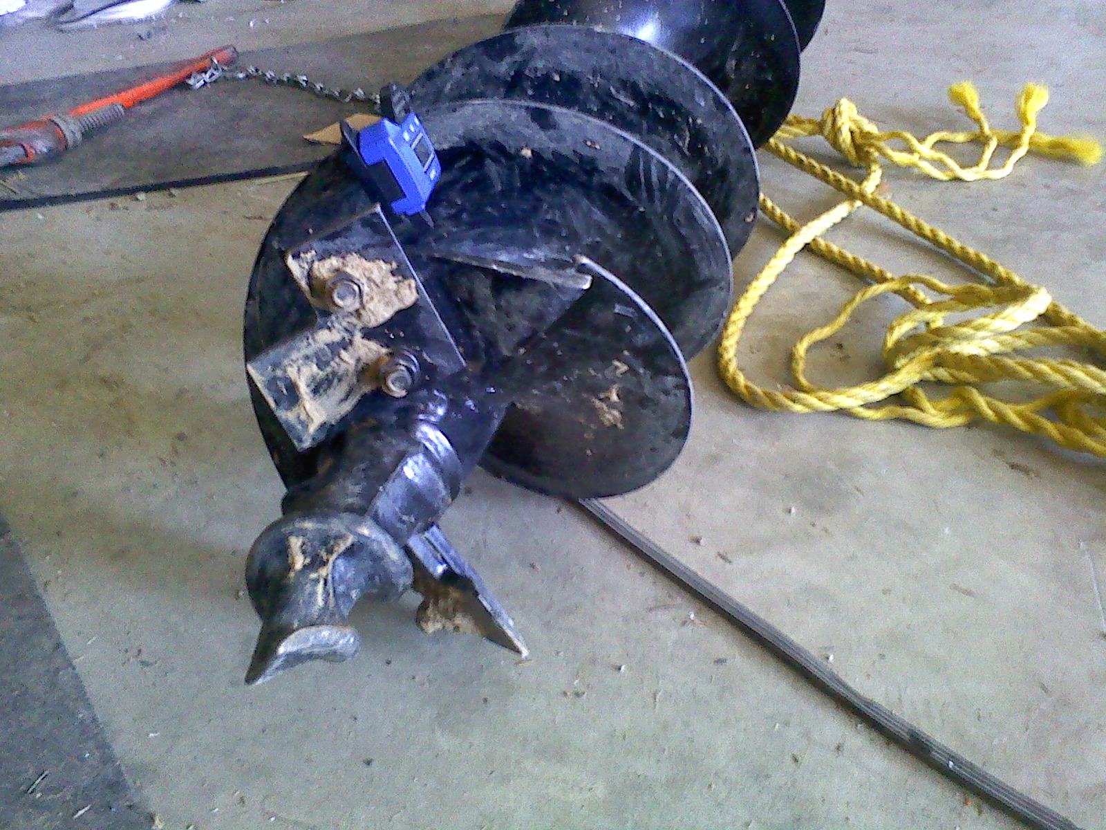

I agree with very low rpm, you have a pengo auger, those teeth flipped one way are 40 degrees and flipped over will be 50 degrees. flip all teeth to 50 * and use low rpm....I know I had the same issue. The soil will act as a plate between the outter edge of the tip the the inside of the inner tooth. this soil will pack in this area instead of funneling out the the teeth.
I local machine shop built a new tip and harded it to. made a huge difference. FYI I use a hyd loader mount PD, the 12" and 15" augers were tough getting down 3 and 4' deep. The 9" auger was no problem that deep. My experiance with my dirt.
You notice this one has a larger OD at the top next to the inner teeth.
