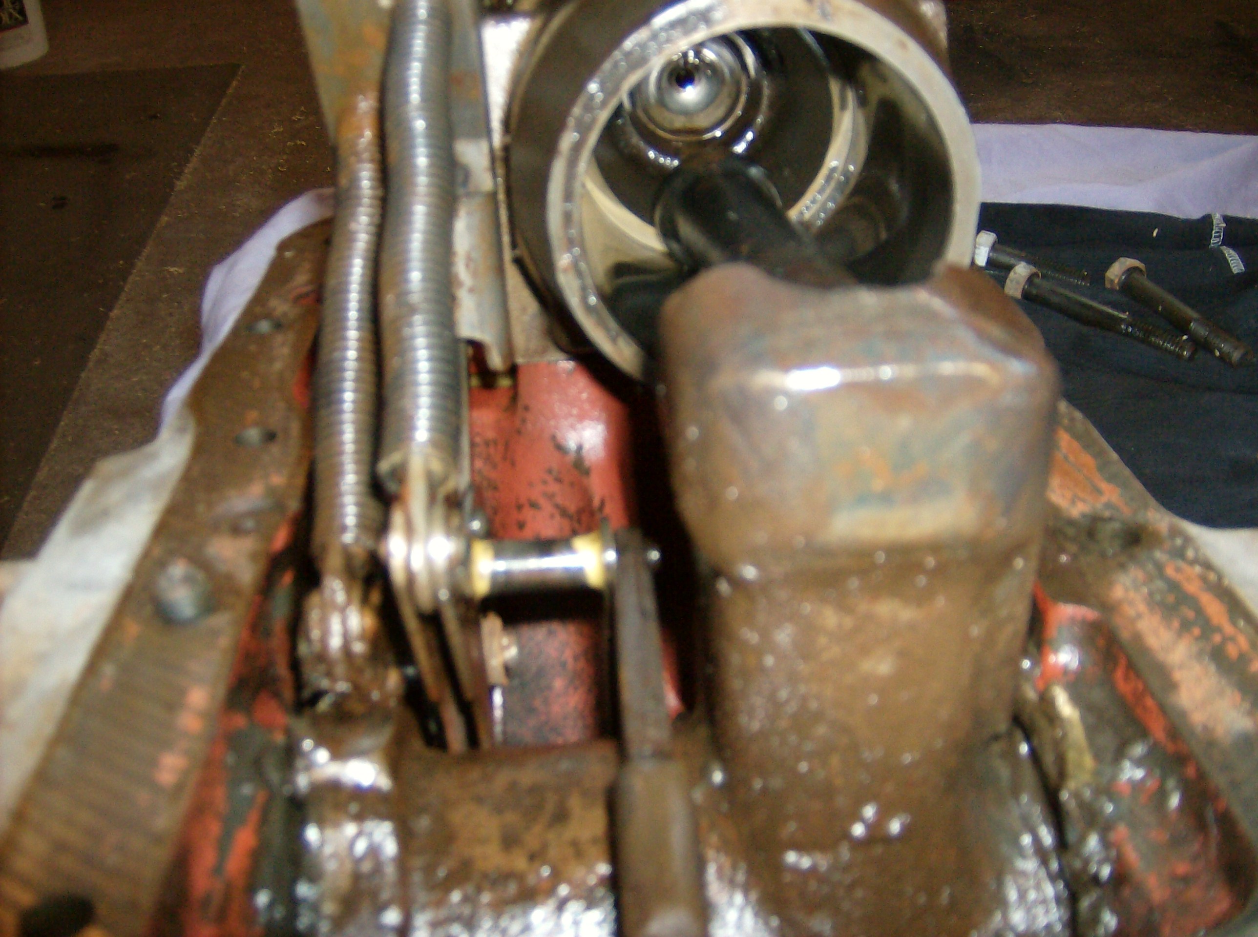

The following are pictures of my progress while working on the hydraulics of my Massey 135 tractor. Since these pictures were taken, I've removed the internal hydraulic pump and made a lot of progress towards cleaning out the sludge in both sumps.
The hydraulic top cover is a very heavy and awkward part to handle. I have an old set of bathroom scales and thought about using the engine hoist to lower it onto the scales to see just how much it really weighs. I picked it up briefly, just enough to take the weight off the chains, and I'm guessing it weighs about 150 pounds, without the lift arms attached to it.
Look forward to hearing how the internals are and whether or not you find any excess grease towards the rear of the cavity.
As you can see in the second picture, there was a considerable amount of grease buildup from the rock-shaft, which probably contributed greatly to the sludge buildup at the bottom of the transmission/axle sumps.

The previous owner(s) must have loved grease. I've spent the better part of a day doing nothing but removing grease and cleaning up the residue it leaves behind. Also, I've finished disassembling the hydraulic top cover which was a bit tricky, but overall it wasn't too bad.

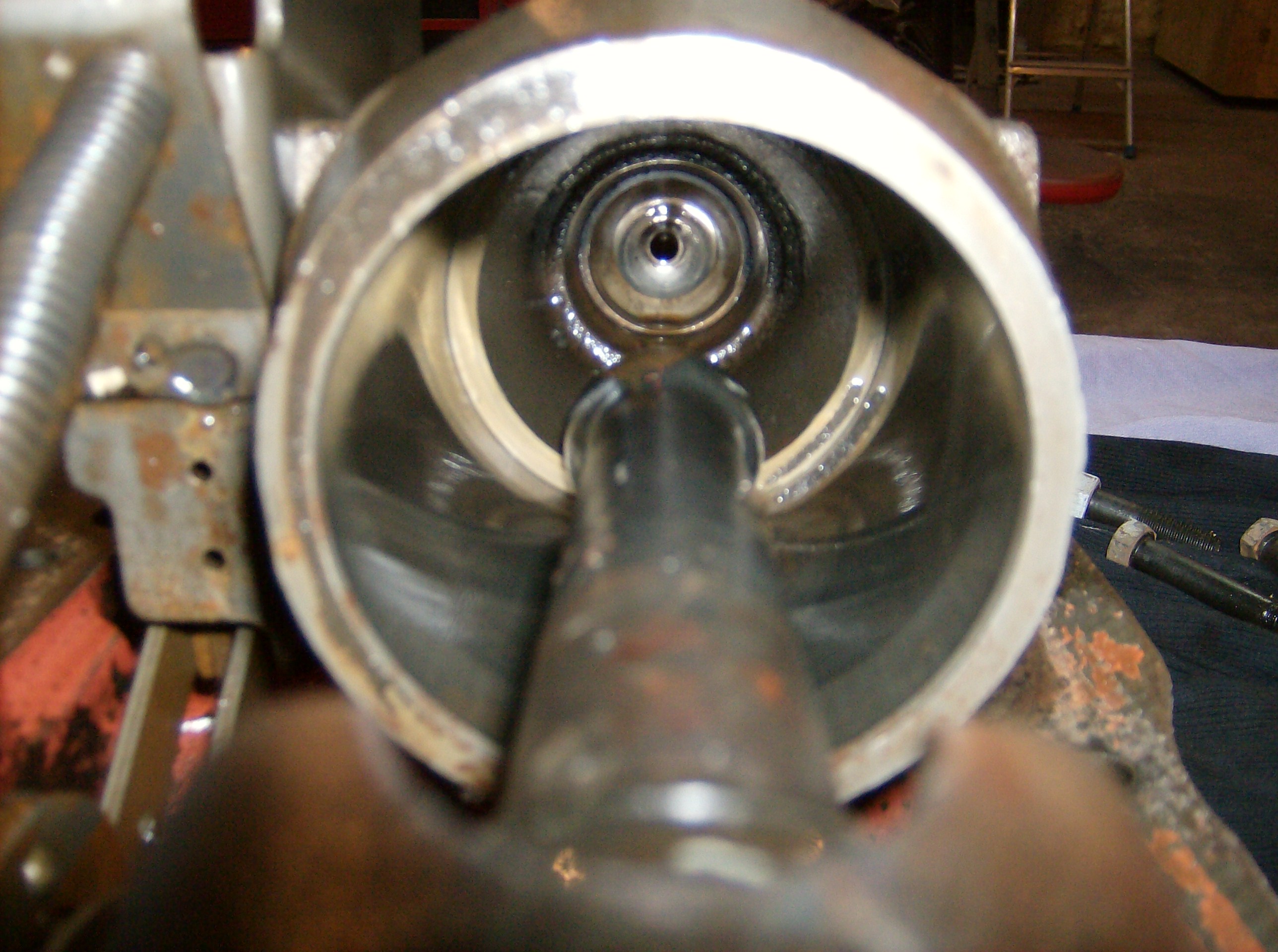

The lift piston and rod are very substantial aren't they, I was quite surprised to see traces of what appeared to be cross hatch marks on the cylinder walls of mine.
They are indeed quite substantial, especially the piston, but considering the amount of force it applies to the lift arms it only makes sense that everything has to be very strong.
The crosshatch marks are from the cylinder honing process, much the same as would be done to an engine cylinder so the rings are properly lubricated while they seat. Mine had traces of a crosshatch pattern left as well, but I plan to hone it again to break the glaze and allow the rings to re-seat. In addition, I plan to use a little valve lapping compound to seat the dog-bone push rod to the piston.
The following are pictures of my cylinder and dog-bone push rod assembly shortly after the hydraulic top cover was removed.
