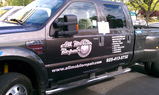

I got the logos put on today.
Brian

   / My 2008 F450 XLT 4x4 6.4L #59
Looks good Brian.
Chris
