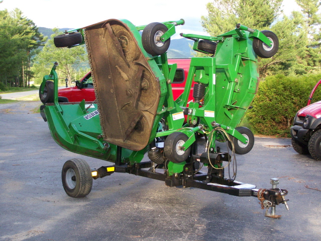

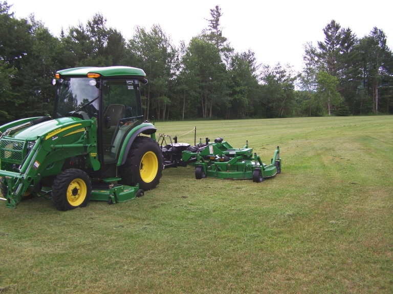

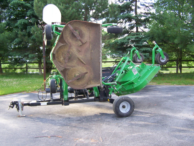

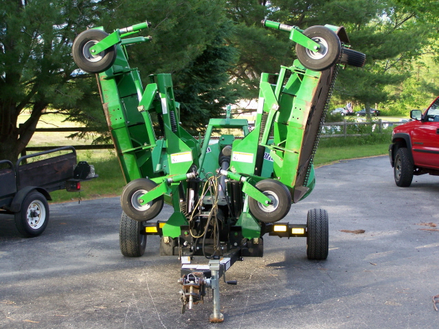

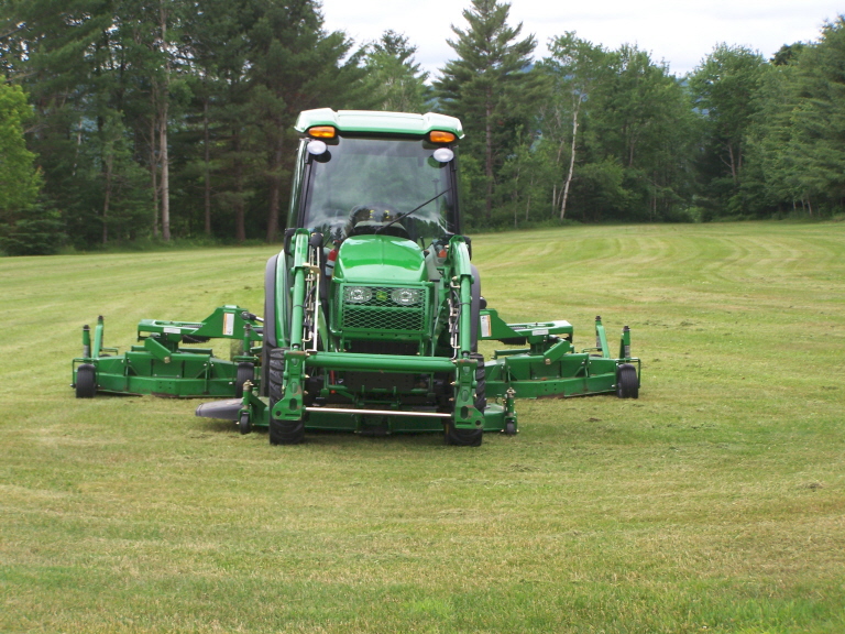

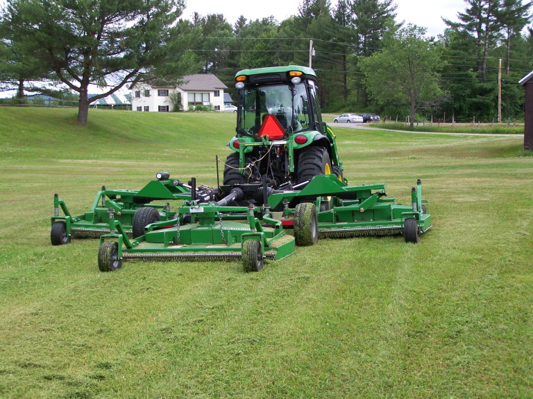

I'm always looking for ways to finish mow faster. My dealer called me and told me he head a 13' wing mower come in used and if I might be interested he'd drop it off for me to try. It ended up being a 15' (Frontier FM1015R). Had some rust on it and a couple of the tires had cracks but were holding air.
First thing when I saw it in my driveway I though "my god, this thing is huge". It was. I had already looked up the specs. It weighs 3200lbs. The operating tongue weight was fine for the 3720. Technically the transport tongue weight was a little heavy but close enough.
After I let down the wings it seemed even bigger than I thought. I moved it to the back yard and engaged the PTO then went up to PTO speed. Moving 9 blades I thought it would vibrate, etc. - It didn't. Very smooth. Cutting grass that I hadn't cut in 2 weeks I could go 3-5.5mph. Stayed around 4-4.5 most of the time. The 3720 had plenty of power except in one or two spots where the grass was particulary thick I had to slow down to maybe 3 or 3.5 for a few seconds. Holy crap I thought - a 180" cut... ;) For long wide turns it actually moved pretty well. Adjusting quickly to obstacles was possible but slow. You need to anticipate well in advance. Turning tight the unit showed a tiny bit of vibration but that was due I'm sure to the extreme angle of the drive shaft (The unit is draw bar mounted and pivots, not like 3pt mounts).
I could mow the open part of my front yard on a small hill, but I have a small square section enclosed by bushes that I just couldn't get.
My conclusion was that it was way, way too big... However had I been able to mow my entire lawn with it (I had to switch to the 72" MMM for the tight part) I might consider keeping it... ;)
It took me maybe 1/2 an hour to mow the 4-5 acres in the back part of the yard, about 1/2 or less what it normally takes me for that part.
The grass was long so I had a lot of grass poop here and there but the cut quality (The blade speed is 16,950 fpm) was pretty good except that I think the decks needed some slight adjustments.

Attached are some pics.

Pics for above...

Wow, I didn't think the 3720 had enough power to drive a mower that big. It's good to know that I could do it if I ever have to.

It actually had plenty of power. The grass was pretty tall and I only had to slow down (to 3-3.5mph) a couple of times.
