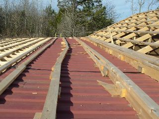

The only real ugly spot was lining up the roof line along the top of the containers. They are a long way from being flat. I placed a straight edge across the span and built up supports the length of the containers to hold up the roof and act as purlins. I figure with enough liquid nails and the weight of the roof, it wouldn't go anywhere.

The panels go on really quick with nice results. I only put in about half the screws I need to get as much done before the weather changed. This section is a 1/12 pitch 11 feet, 9 inches wide by 41 feet long.
A buddy with years of experience helped me installing the roof panels. A good tip is to clamp two 100 foot tapes to the beginning panels and measure each one you install to keep them lined up.
I was really amazed how the panels want to work apart. An eighth on an inch isn't much, but over a distance it really adds up.
Both roof lines lined up purfect using this technique with no fudging needed at the end.

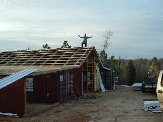

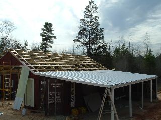

Half the roof is on and the weather is changing quickly! That's me on top after I put in the last of the screws for the day.
I really hate heights, but with the first panel in, I was able to funtion without too much trouble. I wore my sneakers, which allowed me to walk up and down the panels easily.
The pitch on the high side is 6/12 and just about the maximum for walking up and down. Length of these panels are 13'6" for a 41' run.

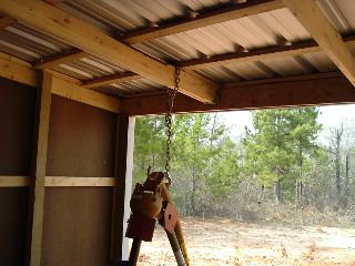

This is another view of my post hole digger that I hung from the rafters. I doubled up a pair of 2x6's with half inch plywood glued in between.
Now it's under a roof and should stay nice a dry.

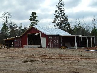

Between the rain, I managed to get the other side of the roof on.
My free help didn't show up, so I did this side by myself. It took a full day and about three hours yesterday.
The toughest part was climbing up and down the ladders getting the panels. A real suprise came when I tried to climb up the steep part after getting some panels pre-positioned. My shoes had dirt on them and my traction was non-existant. One step up and a quick slide down! No injuries, just surprised how quickly my footing was lost.
