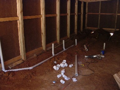

When I originally planned the barn, I wanted a semi-enclosed area with protection from the elements for non valuable items. Kind of like an open garage on the side.
I've since decided to enclose this area and create a small cabin out of it.
Measurements on the inside are 11 feet, 8 inches by 39 feet 4 inches.
It will have a bedroom, bathroom, kitchen/living room.
It took two days with shovels and picks to level it out, lay sand and dig the trenches for the sewer lines, install the pipe and rebar.

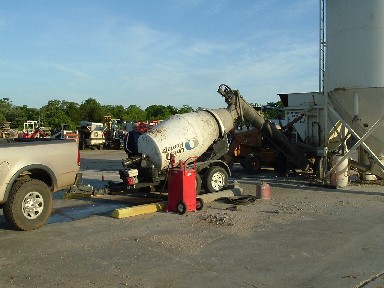

#62
Pouring concrete in a small, enclosed space makes things kind of tricky. I needed a little over 5 yards.
United Rental has one yard buggies for $82.50 a yard plus $16 a day for the trailer.

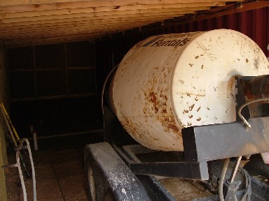

#63
It was a tite fit.

#64
This seemed to be the best solution to getting enough concrete in at one time with minimum expense.
The ceiling is a little over 7 feet in the middle.

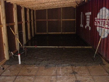

   / My Container Barn

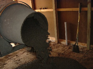

#65
I ran scree boards along the container and short ones between my exterior posts.
I capped the drain pipes and vents with red duct tape to keep out the concrete and to be visible. Two of them had to be cut a little lower to get the axle of the cement hopper over them.
Otherwise it went pretty smooth.

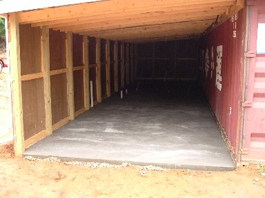

   / My Container Barn
#66
My dad would get the next load while I worked it. Each load too about one hour for him to return, which was just about enough time for me to get the last one smoothed out.
We used the left over concrete to build a step for the small barn door and fill in the space under the containers in the back. That space had snake hotel written all over it.
This is the finished floor the day after is was finished.
Now I'll start framing and seal up the front.
