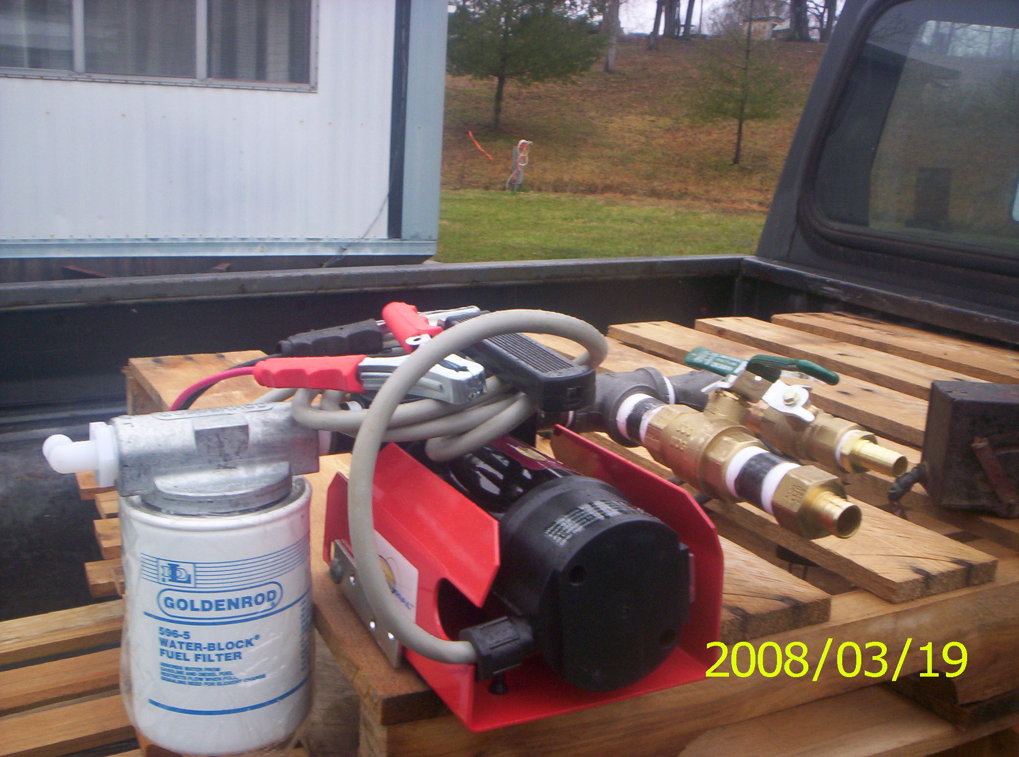

PitbullMidwest said:
LBrown, I'm trying to visualize how your setup will work once completed. Could you post a pic to help me out?
The white barb fitting goes to the hose for filling the tractor.
The first brass barb fitting goes to a hose that attaches to the brass barb fitting on the white 30 gallon storage drum.
The second brass barb fitting goes to another hose to use for pumping from one to 5 gallons cans etc and to unload a 30 gallon drum of fuel off my pick up.
pump picture

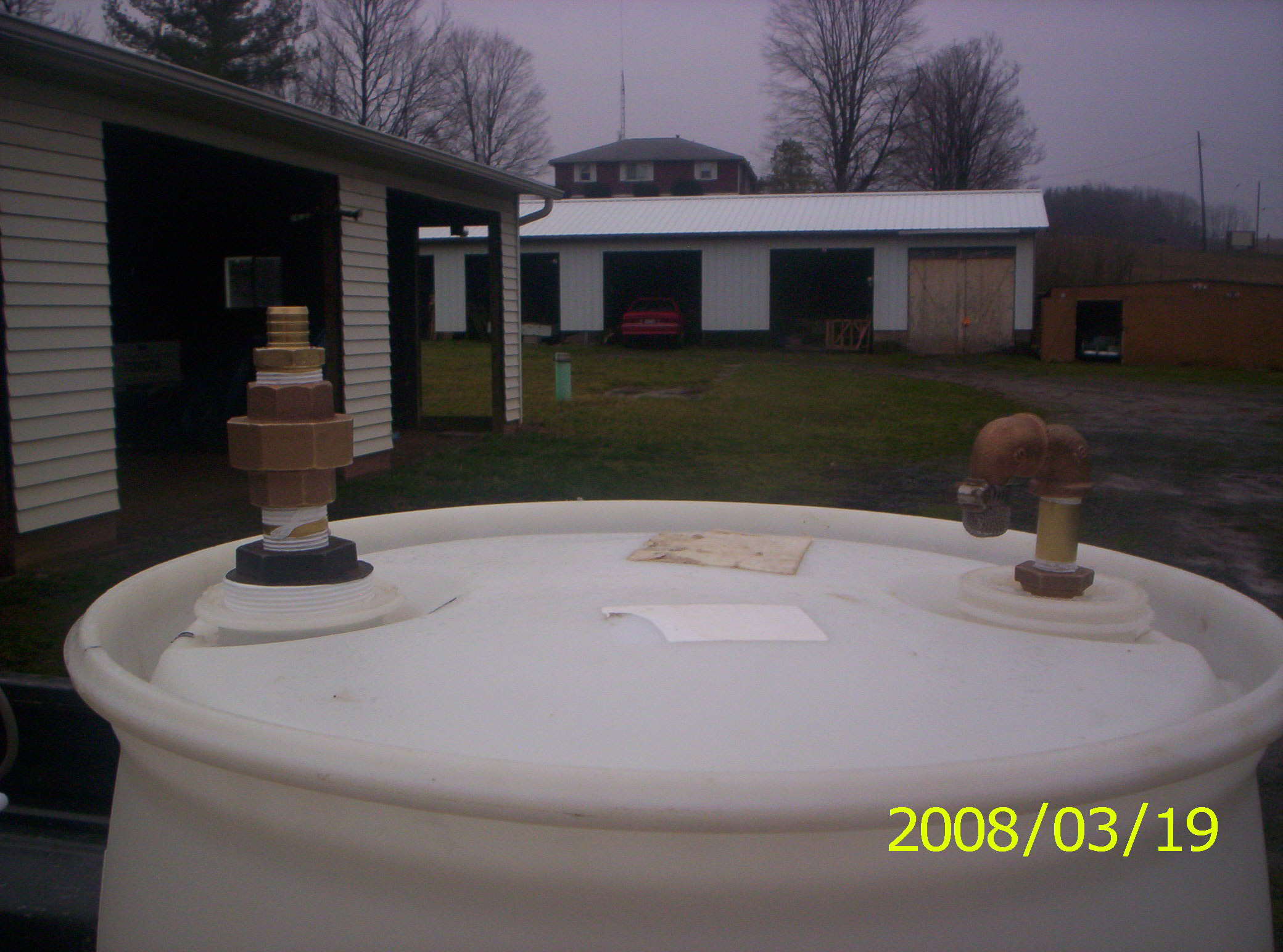

   / My Diesel Storage and Transfer Set-up #80
You have to load them from your camera to your computer first and then follow the instructions from the FAQ as follows:
"To attach a file to a new post, simply click the [Manage Attachments] button at the bottom of the post composition page, and locate the file that you want to attach from your local hard drive.
Only certain types of files may be attached: these are the valid file extensions for files to be attached to this forum: bmp doc gif jpe jpeg jpg pdf png psd txt zip.
After posting, the image attachments may display a thumbnail, depending on the forum settings. To view the contents of the attachment (if it is not already displayed) simply click the filename link that appears next to the attachment icon."
Thanks for this info.
As a result I was able to post the 3 pictures of my set up.
One thing I noticed is when i click on the file link in the post to view the picture the picture is very large and sort of distorted.
Is there any way to resize them when posting?
To those of you who have viewed my pictures how did they appear to you?
Just trying to determine if they are posting OK !
