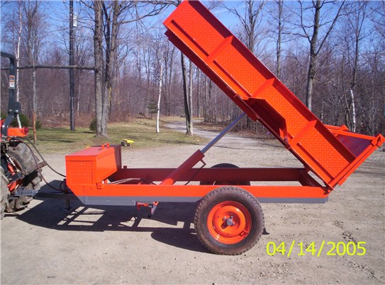

In my case at least, I would not think of buying a hoist, but making my own smaller version. I don't know why I have my cylinder mounted so it pushes back, never considered turning it around till I saw your video. It looks like your way works well, and pushes up, closer to the front of the trailer. Are you happy with the way your cylinders are mounted?

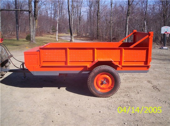

Here are pics of my trailer with a high swing tailgate. You should not have any trouble with your set up,it is similar to mine & i have had mine filled with hand picked field rocks to where no more rocks would stay on,never had any trouble dumping it.

Thanks Dirtnut, I think too I will be okay with my setup. I like the idea of your high tailgate. I also like your front toolbox. More things to think about, thanks for the pics, Greg
