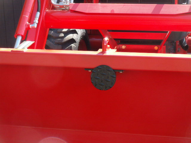

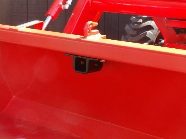

Bolted..3/8" flat stock top side of bucket for strength.

I like the underside of the bucket the best.
How do you drill mounting holes though a bucket?
Or I should say it must be a pain to drill
   / My easy FEL hitch #25
I needed a ball to move various trailers so I burned a hole through the bottom front edge of my bucket on my Kubota L2250, making sure the hole was large enough to take all size ball bolts, then welded tabs on the nuts so I could hand tighten them enough to move a trailer. Works fine, no cost.

wdchyd.
"Nice touch on the checker plate cover...."
Other cover plate..lady bent her head than leg w/arm just wasn't sexy anymore. ;) same ladies you see on mud flaps.
