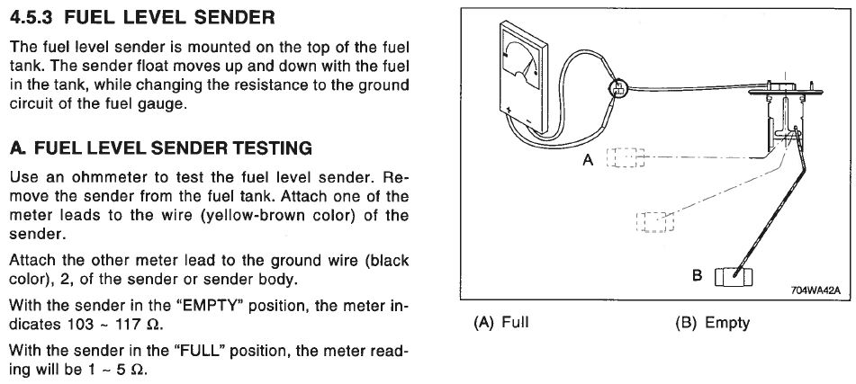

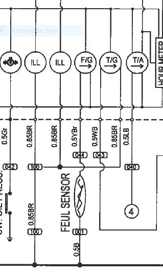

Recently I had my first two problems with my Bobcat
first was a hydraulic leak on the FEL loader joystick control valve, which when I have more time I will detail completely, but for now on to my second more pressing issue
During the summer I started a dirt moving project and used a tank full of fuel.
It seemed to go down at its normal rate, when I felt like it was due for a fill up I went and purchased my normal 5 gallons
I put it in, and started the tractor and to my surprise I still had an empty tank on the gauge.
Again I used (by hours what I assumed would be about 5 gallons) filled up my can again, and she is still showing empty
Anyone have similar issues, and know where I should start in troubleshooting it?
