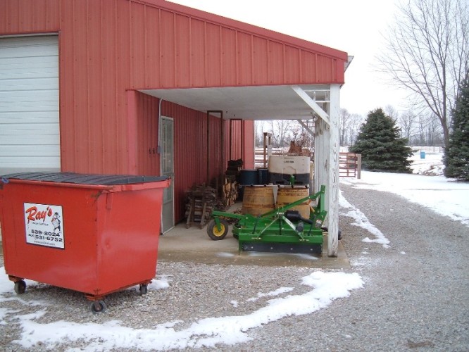

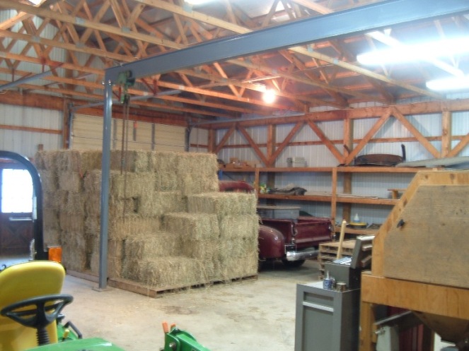

I agree with some of the others that 14' clear height would be good. Mine is 12' and some of the hay wagons have been stacked to high to fit. Also I used to have a gooseneck horse trailer that wouldn't clear with a standard sized rooftop HVAC. I would make sure that at least one bay was long enough for your longest trailer with tow vehicle attached.
My "bridge crane" is home made, but I find it pretty handy for my car hobby.
The lean-to is handy for storage especially when implements are wet/snow covered/muddy. Keeps some of the dirt out of the barn.
