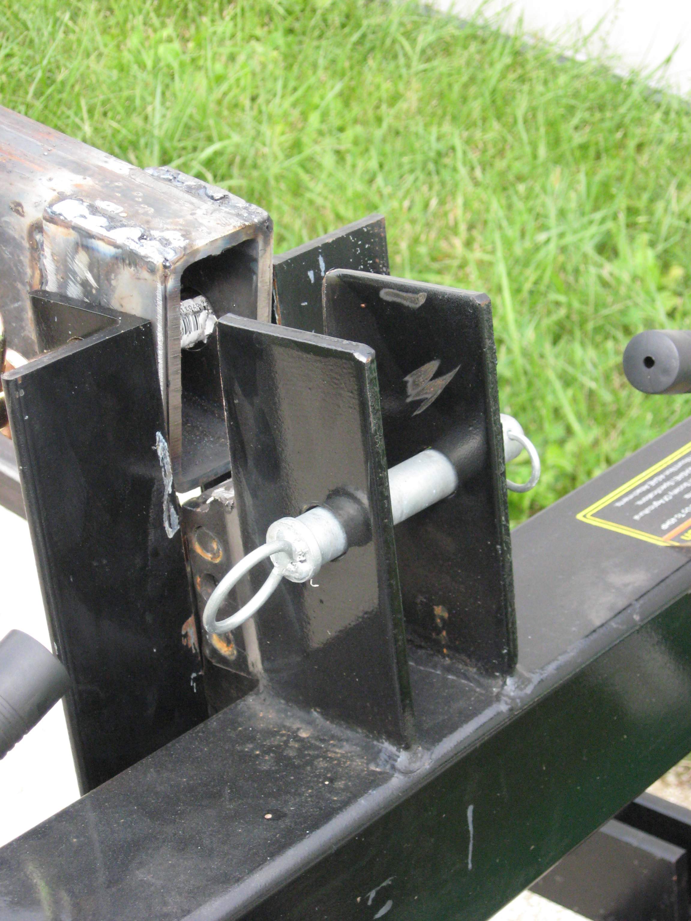

"Go to hook up again and it appears that top bolt/bushing is just a little too far back! When hitch is lifted and bushing slides down the top hook ramp it gets part way and the front edge of the "A" frame jams up against the bolts on the top hook. Won't let hitch come up far enough to let the pins engage top and bottom. Arrrgh! "
I had the same problems. I modded mine by cutting notches out of the upper hook brackets. I also eliminated the bolts by cutting off the ends. Once I had the hook where I needed it, I put the remainder of the bolts back in and puddle-welded the ends to keep them in place.
Finally, I bevelled the edges of the hook brackets to give a little more room at the upper attachment point.
Regular iMatch works better for me.
