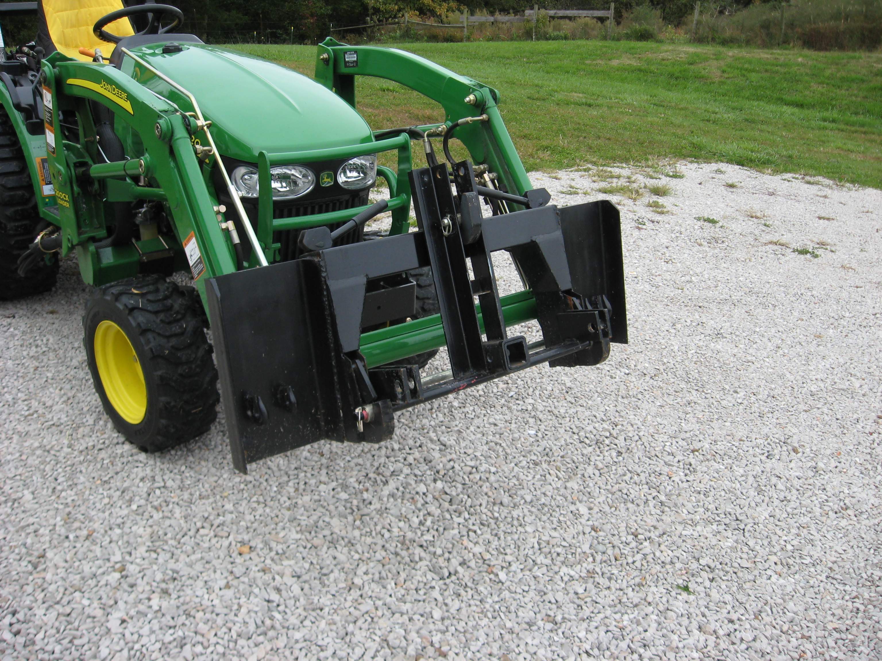

   / My Harbor Freight Quick Hitch #202
"So what do you guys do if some implements are 26.5" or 27"? Modify????"

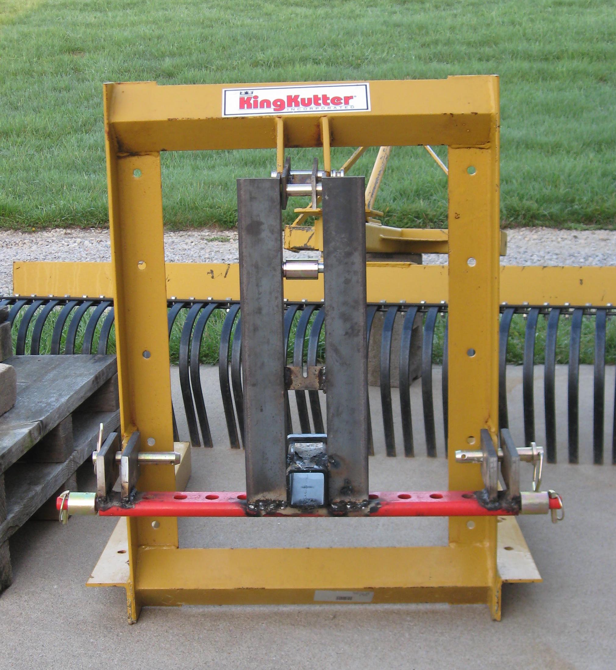

I made a combination three-point trailer hitch and quick hitch adapter for my "non-iMatch" attachments.

   / My Harbor Freight Quick Hitch #204
Runner,
You wouldn't happen to have some more pictures of your 3-pt trailer hitch and quick hitch would you?

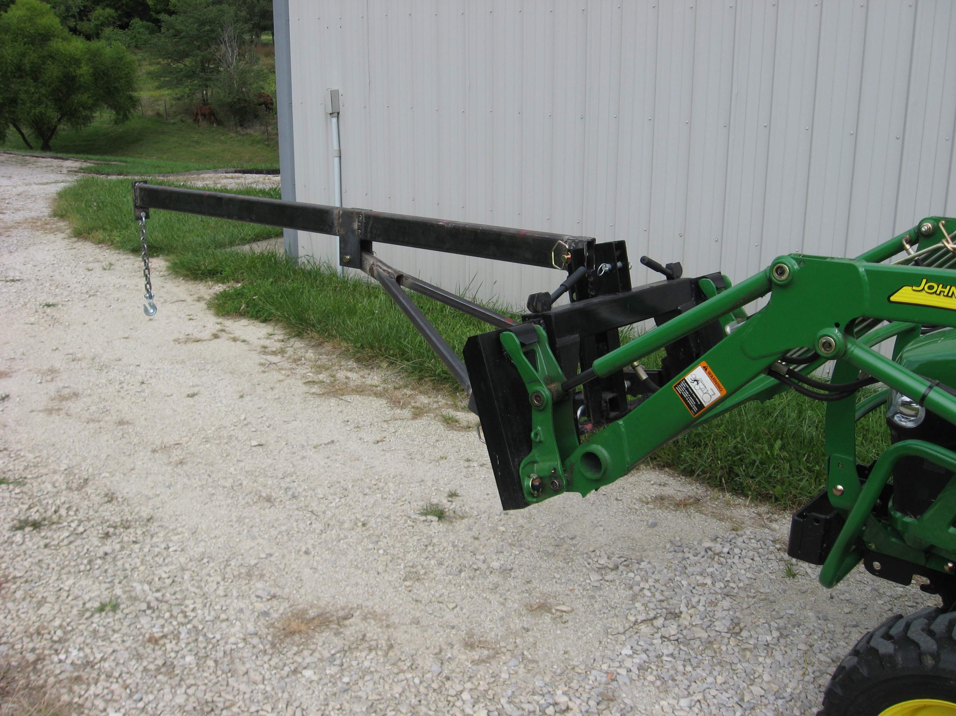

   / My Harbor Freight Quick Hitch #206

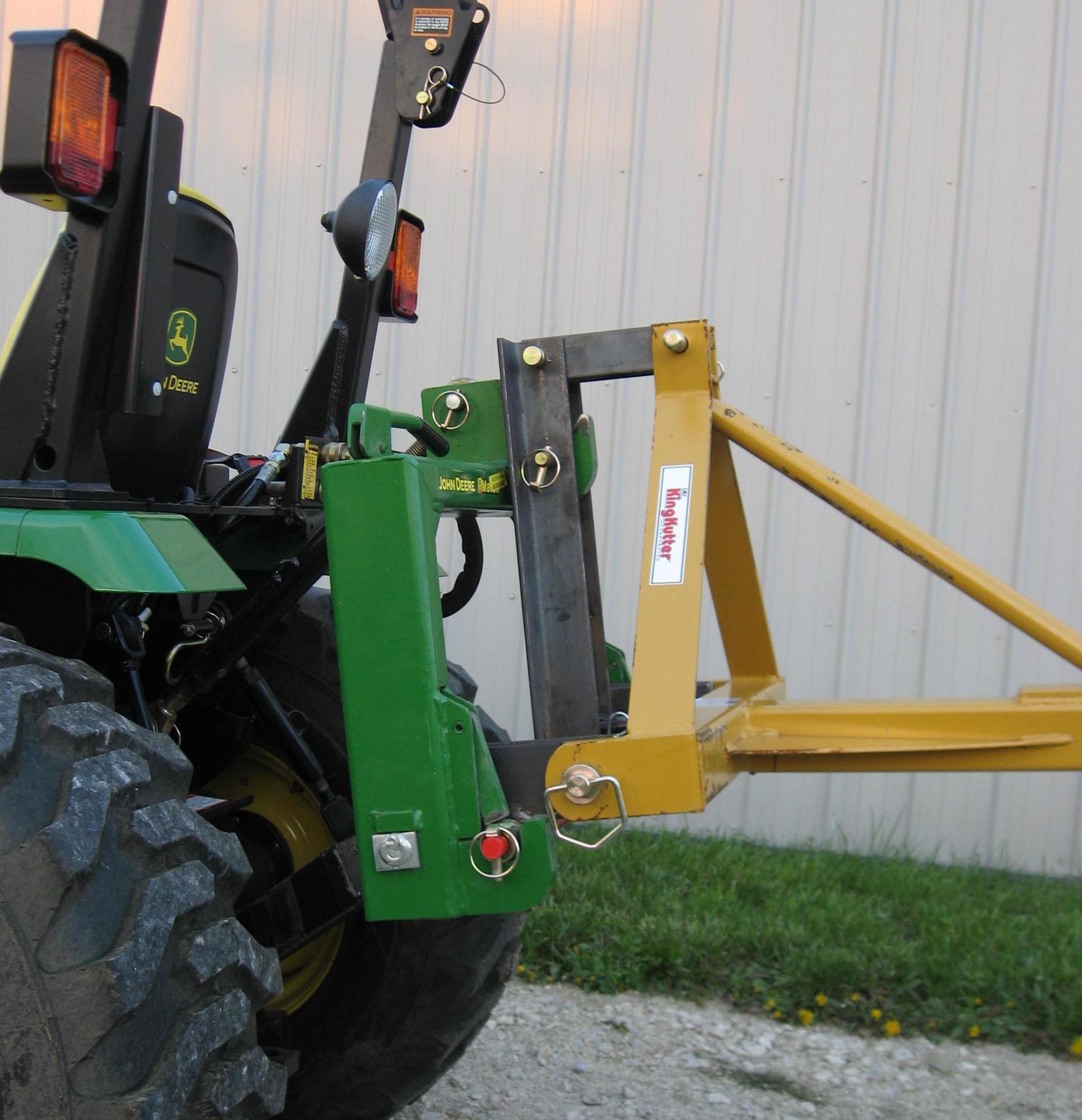

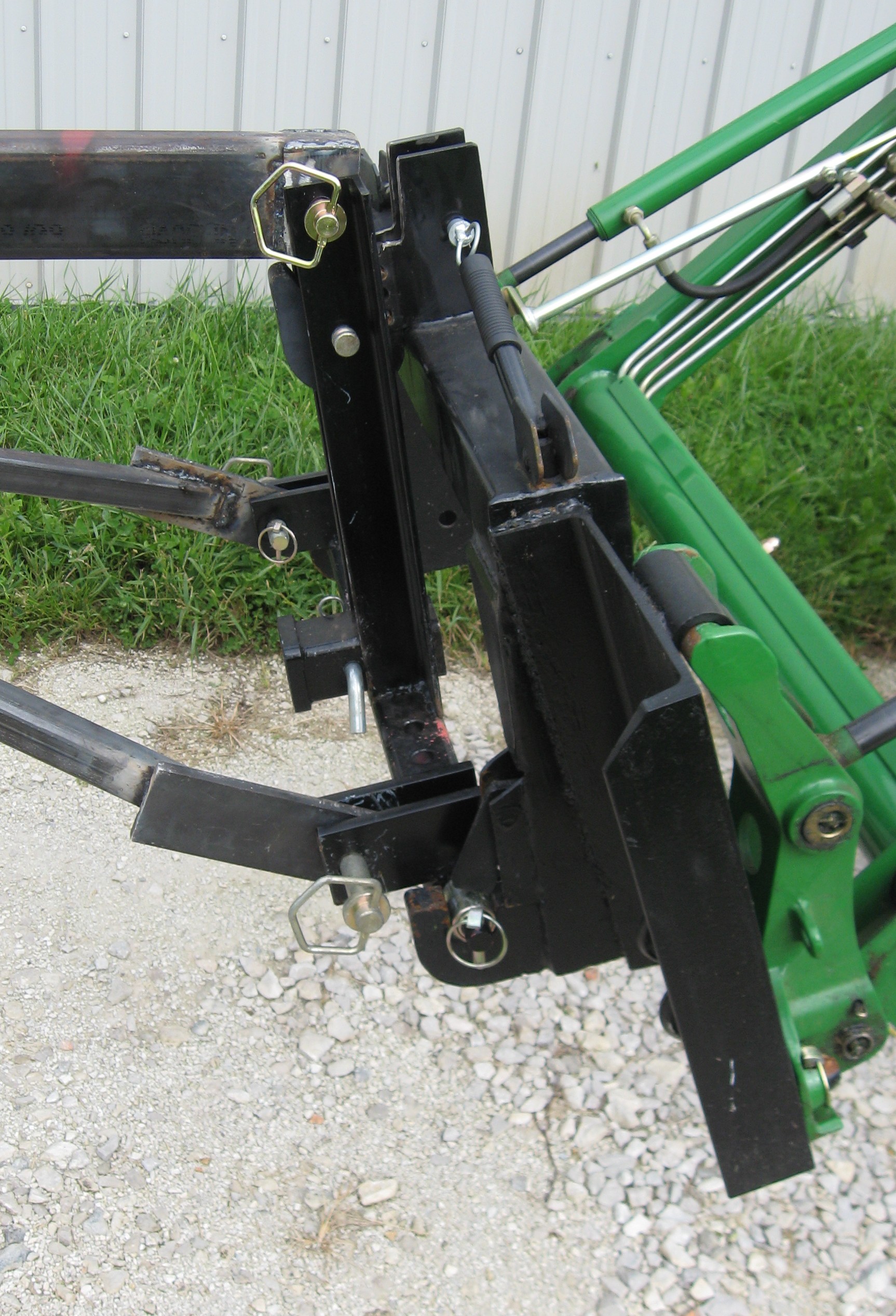

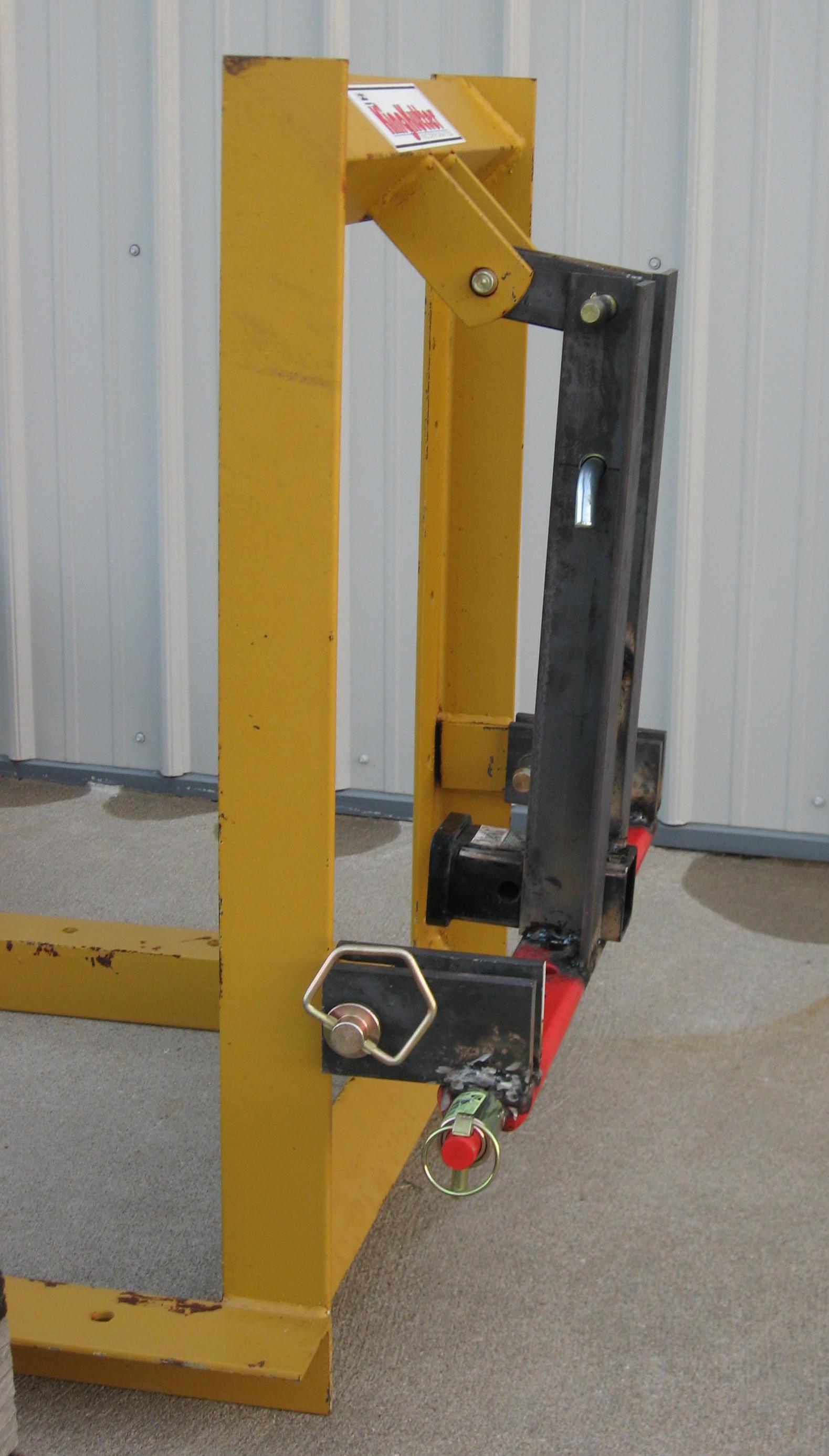

"You wouldn't happen to have some more pictures of your 3-pt trailer hitch and quick hitch would you?"
The quick hitch adapter also acts as a mount for my boom pole.
Here are a few pictures:
