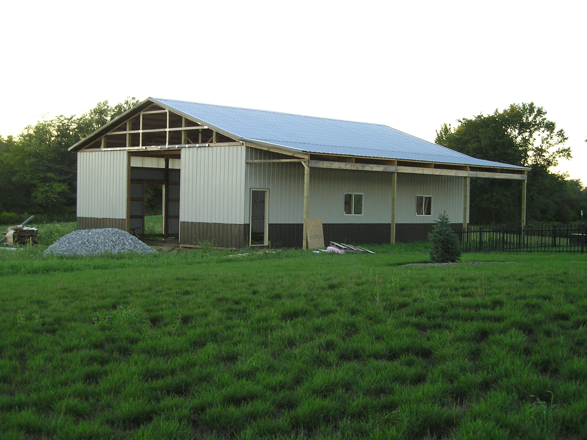

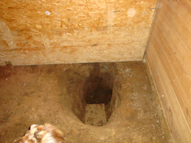

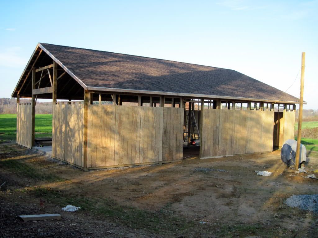

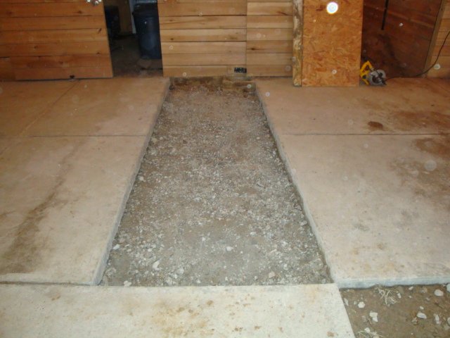

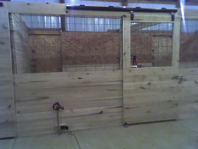

Looks like some pretty good progress. Here are a few pictures of our barn same size 36x48 with a 10' lean to. Some lessons I have learned
1. Put a water shut off to the barn.
2. If there are any Tee's in the water line make sure they are either outside or put an access to them ( I had to break up concrete in our barn and get to a tee that busted last winter, you can see the hole I dug by hand on the stall side, I rented a mini excavator for the side where the concrete was.)
3. On the stall fronts I would make an opening big enough for your bucket to get into for loading sawdust or cleaning. I only have 4' doors and it is a pain.
4. Horses will chew anything.
We had a lot of fun building ours it was a kit from Menards. We had to put up 28' 6x6 for the center posts and that was pre tractor, it would have been a big help. We used the truck and about 50' of tow strap. We have 3 stalls and one tack room on one side and hay storage on the other with a center isle.

Very nice, and thanks for the lessons. I'll try to learn from your pain. Sorry you had to deal with that broken tee. Hopefully I can avoid such problems, but I did put in a ball valve where I teed into the water supply way back at the well head just in case.

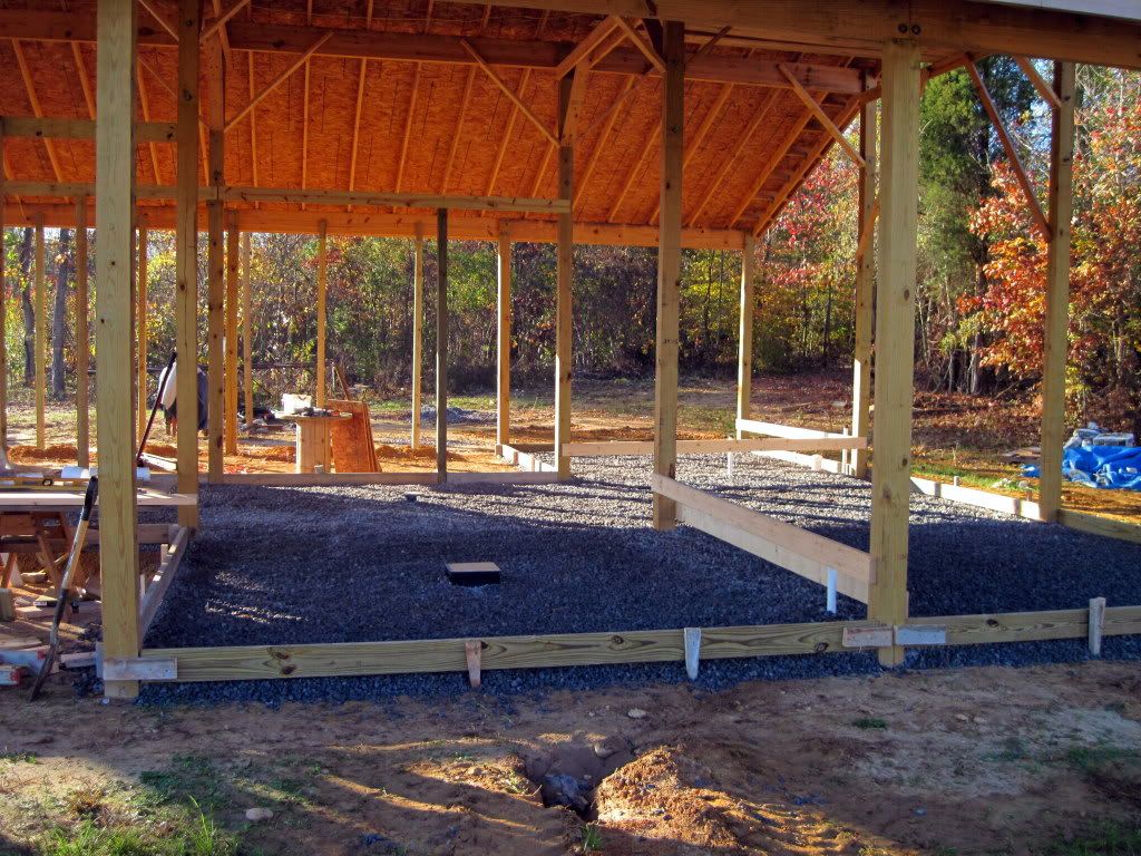

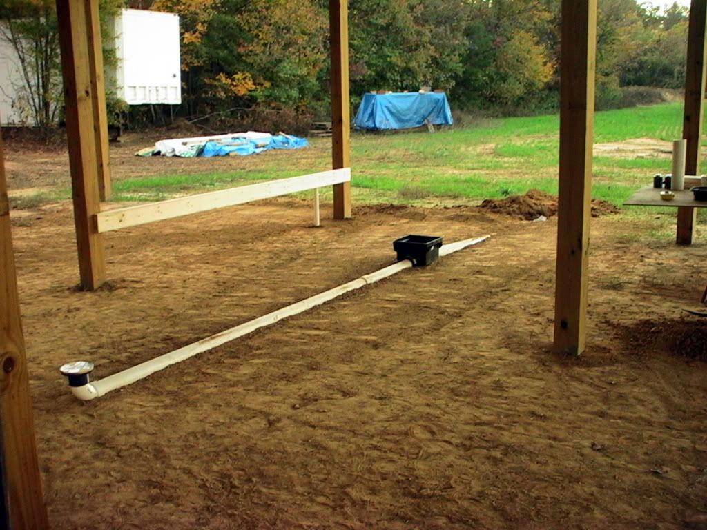

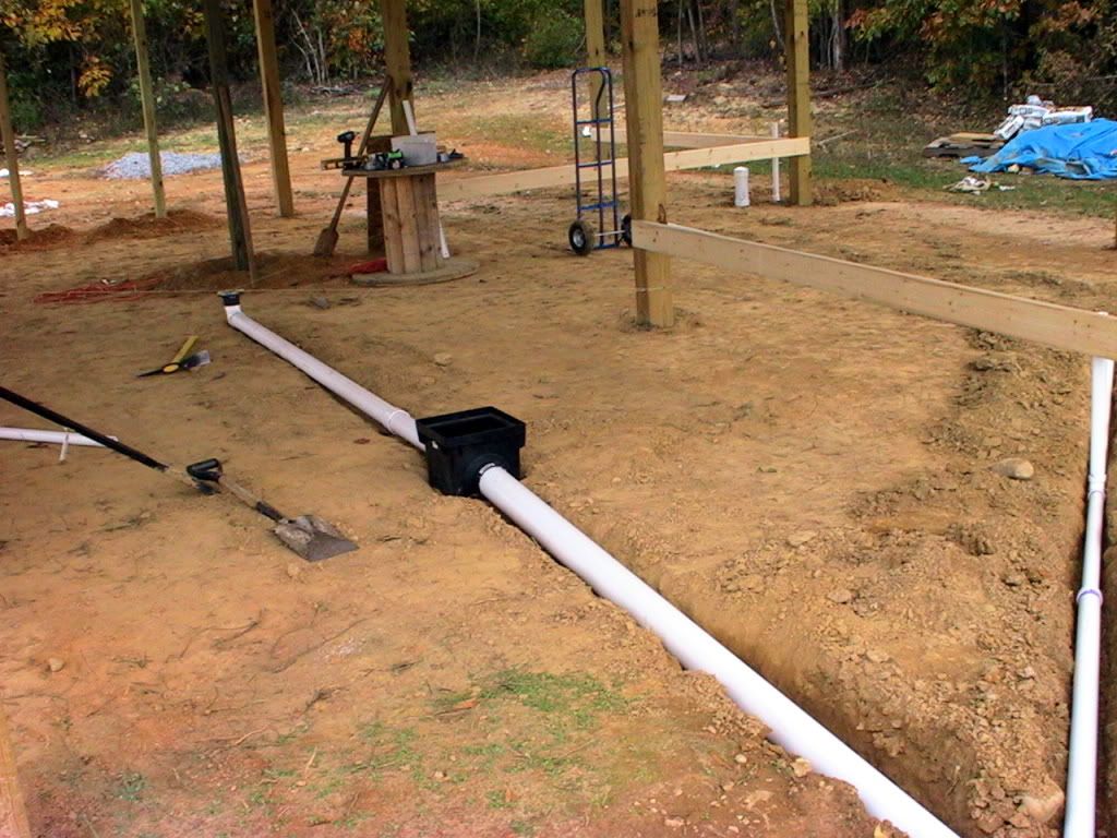

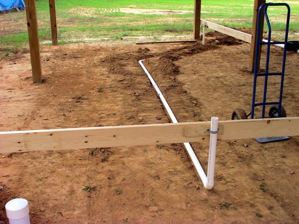

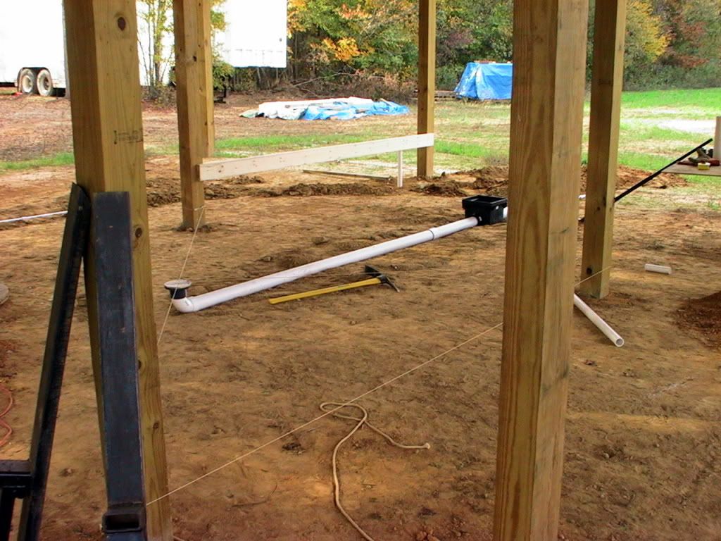

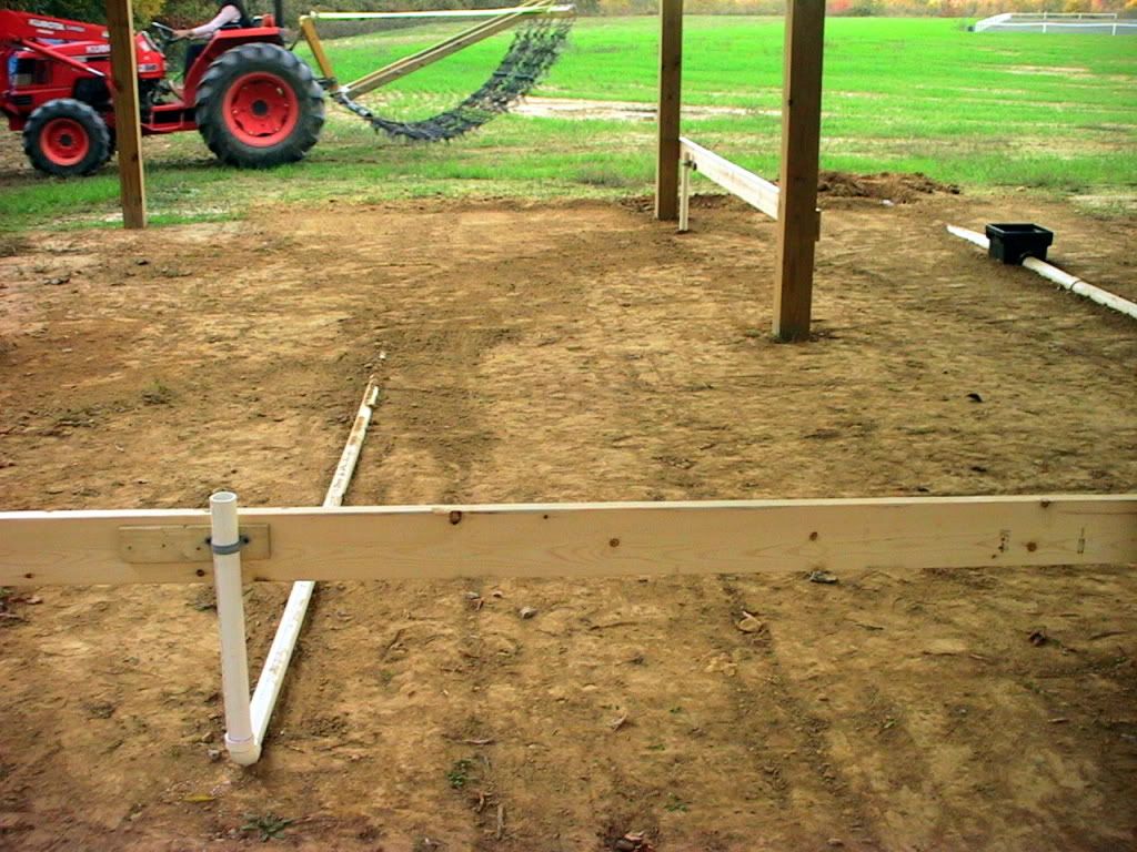

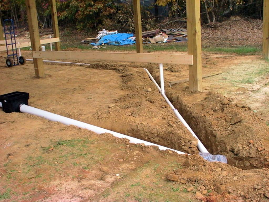

Step 7: Under-slab plumbing
Well, it's been a while since I updated my progress, so here's the latest.
Since this barn will have a concrete floor with sinks, a toilet (eventually), and a couple of floor drains, there's some plumbing to do before the slab goes down.
The tractor wasn't much help here since it's mostly just hand digging. I put in a 12" square catch basin in the wash rack with a smaller 6" round floor drain out in the aisleway nearby. I also roughed in sinks in the two tack rooms. The toilet drains into a separate system and is currently capped off underground outside of the barn. Eventually I'll install a septic system for it and hook it up.

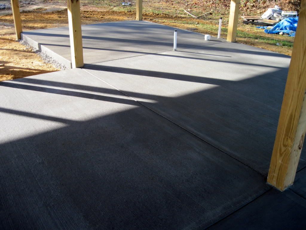

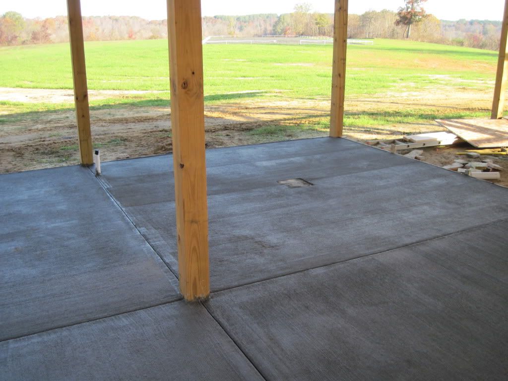

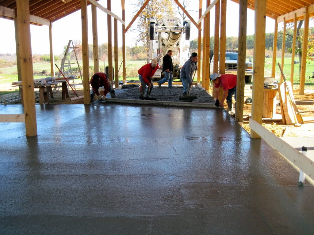

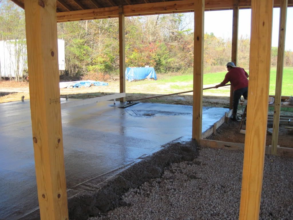

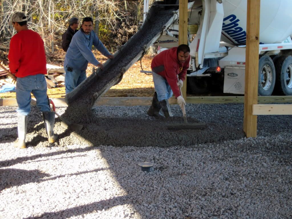

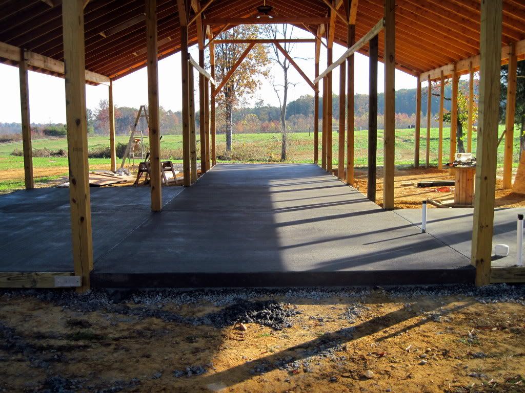

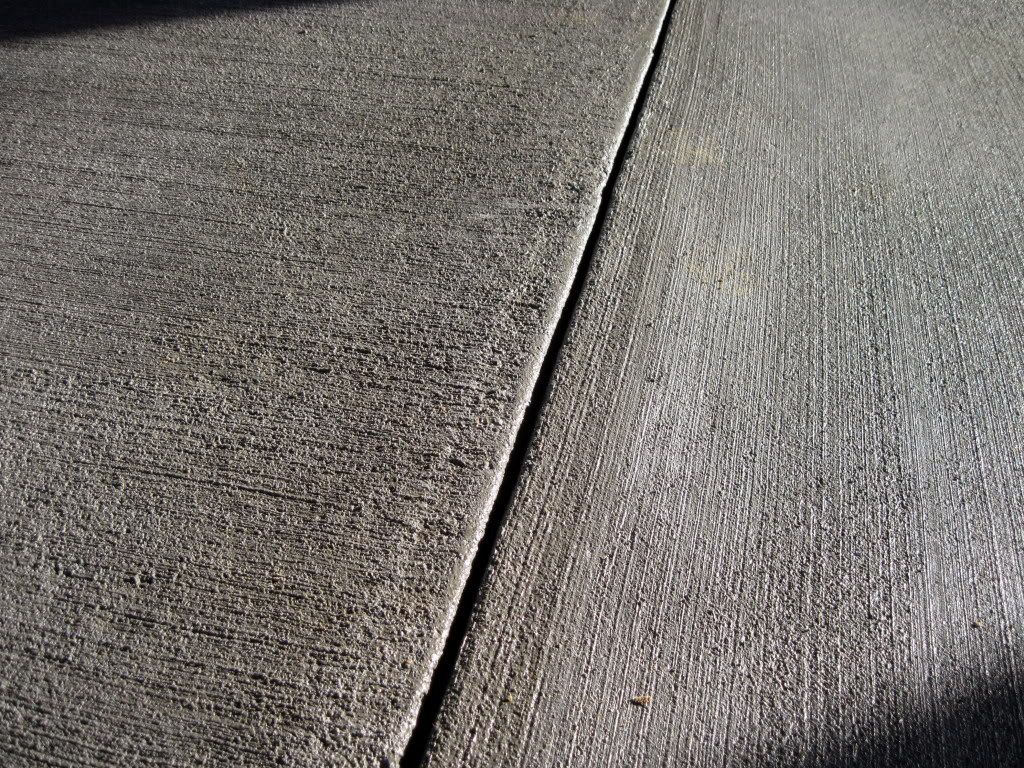

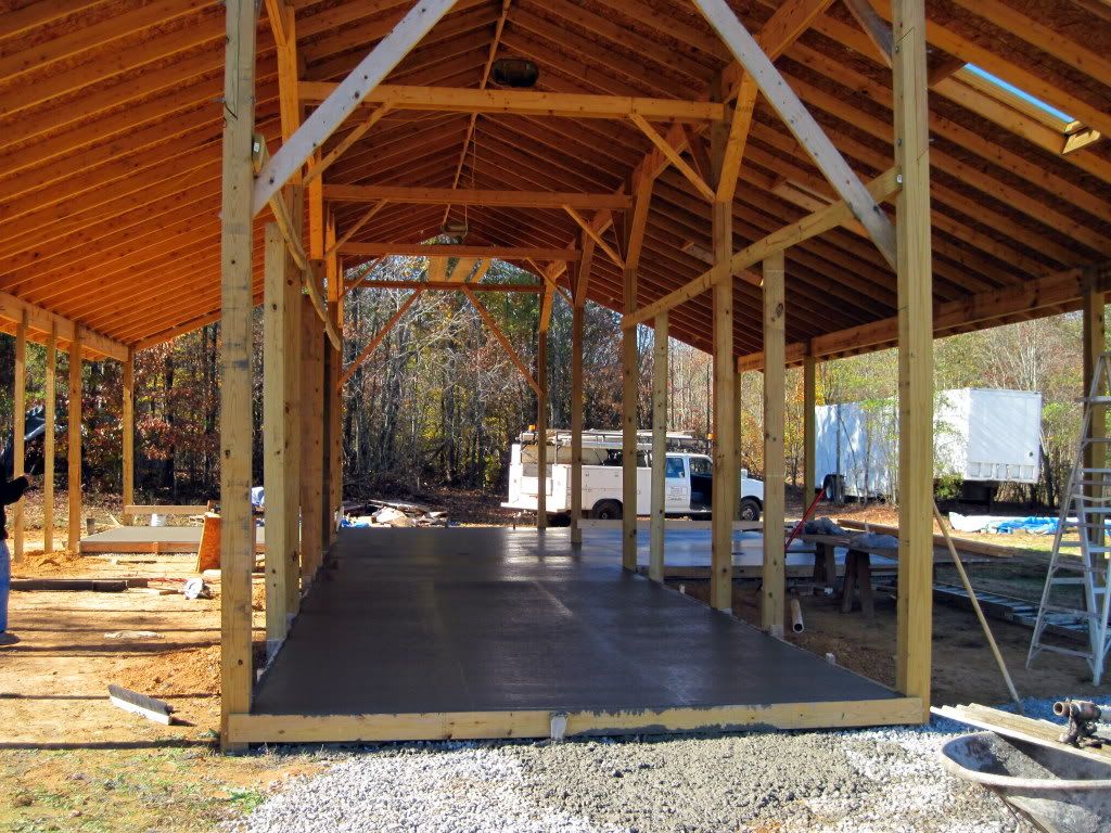

Step 8: Slab
The slab is the first step where I actually hired somebody else to do the work. With a little over 1000 square feet of concrete to spread, screed, float, and texture, I figured it was better left to the experts (and those who's backs can handle the work). I ended up putting a little over 4" of 4000psi concrete with fiber in it over a base of 4" of packed stone.
The guys did a really nice job. They made it look so easy, and did a great job of sloping down to the drains. I'm really glad I hired them to do it. The edges and joints and broom finish look really nice.

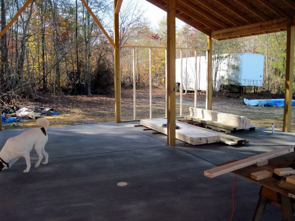

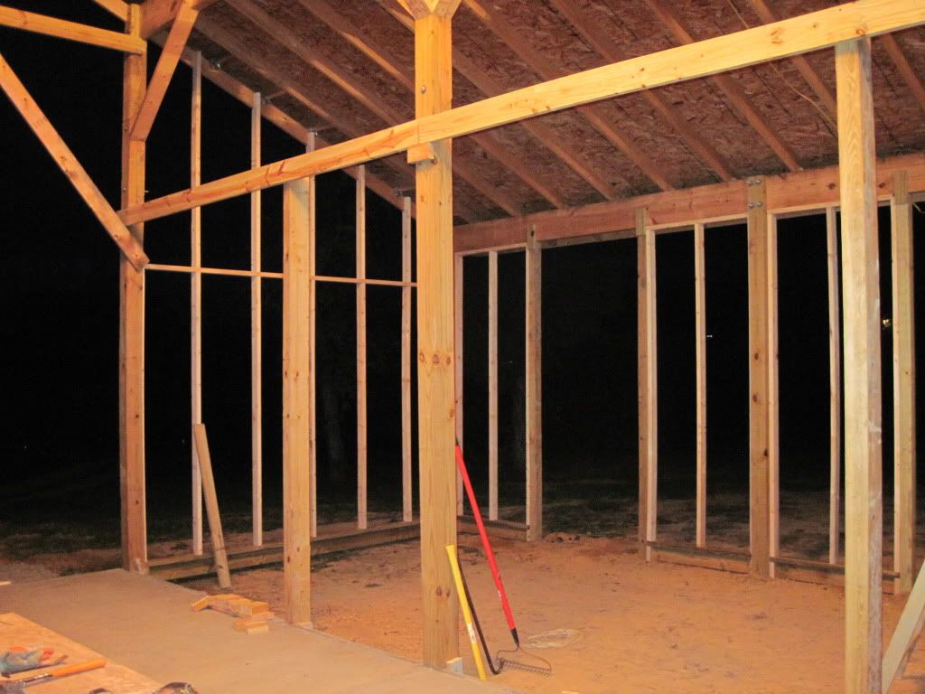

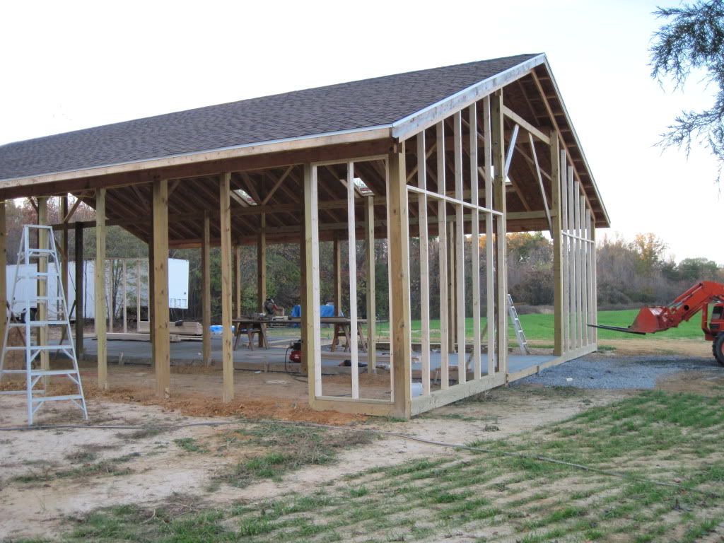

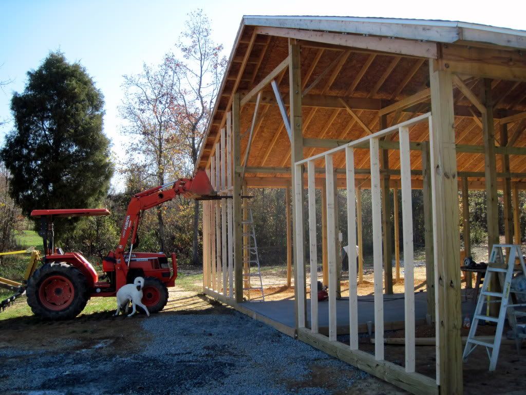

Step 9: Exterior wall framing

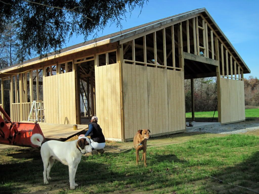

Now I'm to the point of framing the exterior walls. I'm using vertical studs flush with the outside of the posts so I can have T1-11 on the outside and horizontal T&G boards on the inside. I got a little help from the wife so far, but otherwise it's back to just me again.

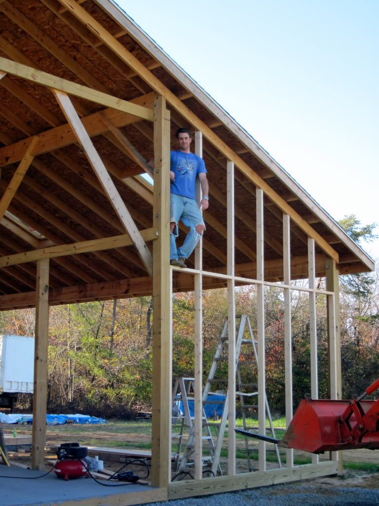

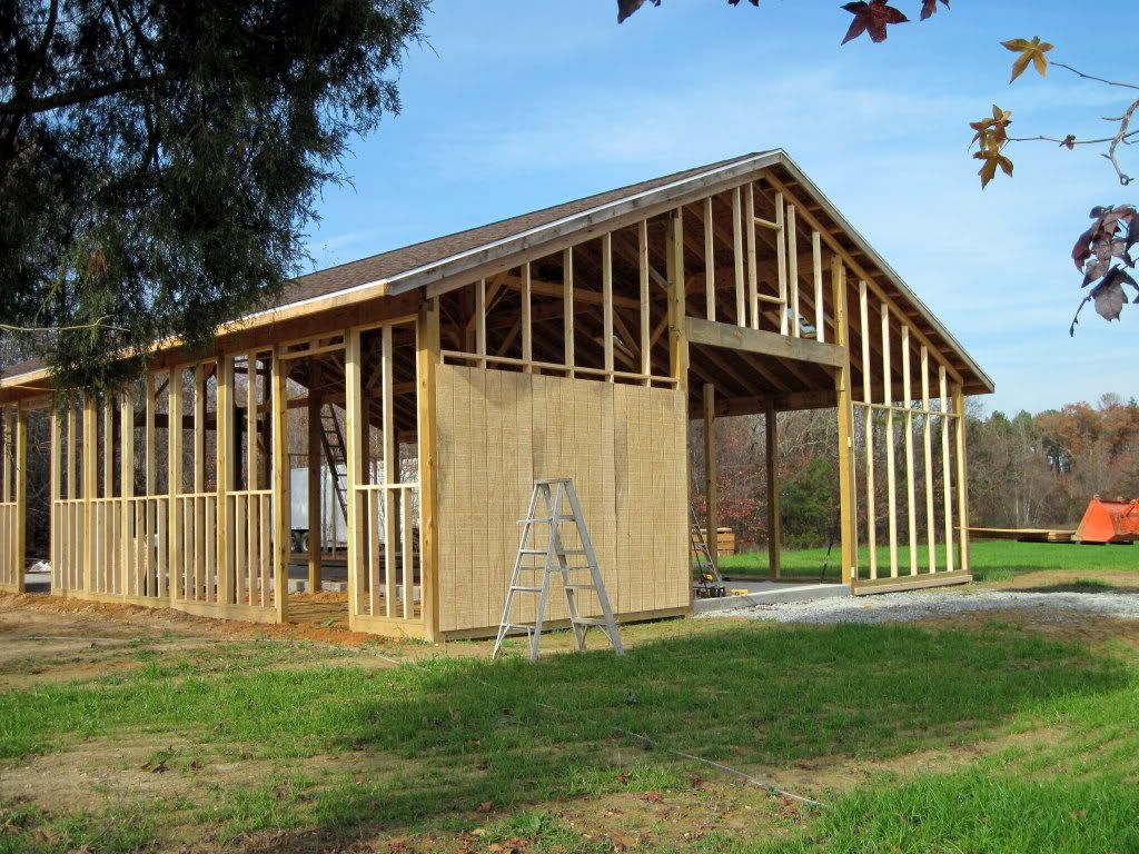

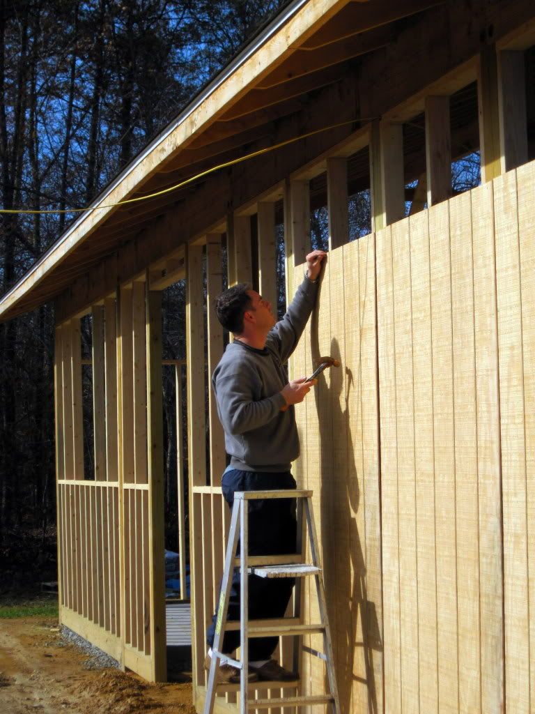

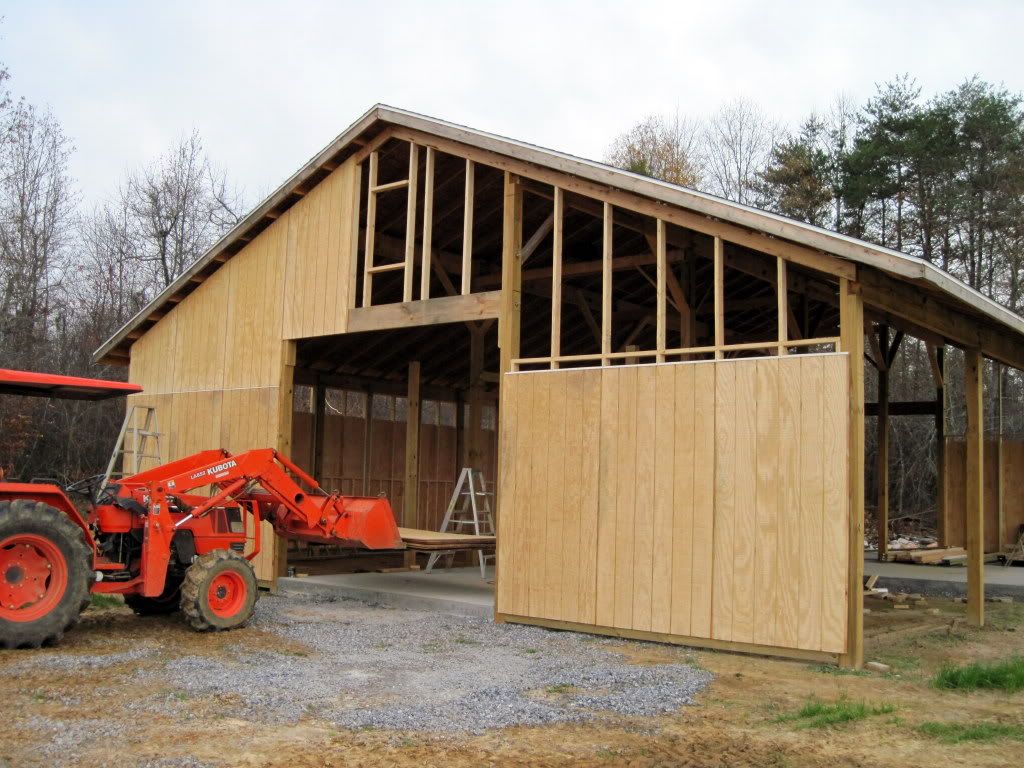

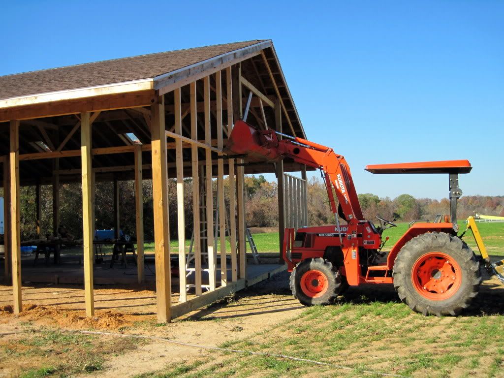

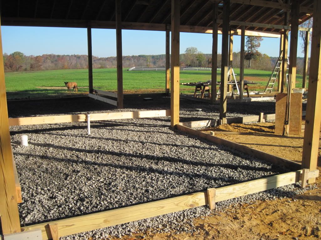

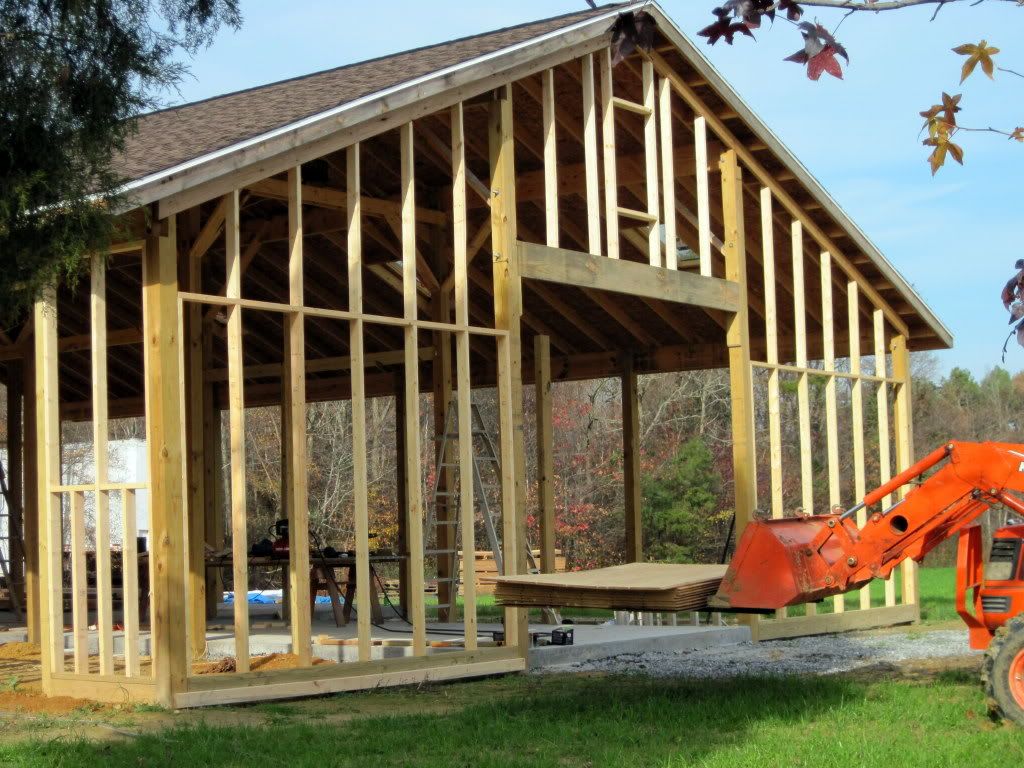

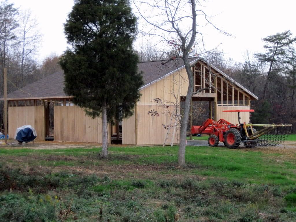

Step 10: Exterior Sheathing
Okay, so I'm not technically finished with Step 9 yet, but I have a good reason for not finishing the framing on the north side of the barn. I still have about 3" of dirt followed by 3" of rock screenings to add to the stalls to raise the floor level up closer to the aisleway. However, it's too wet and soft to bring in a dump truck, so I have to postpone that step until it dries out for a bit. Since it involves something in the neighborhood of 40,000 lbs. of material, there's no way I want to move all that in a wheelbarrow, so I want to make sure I continue to have tractor access to the stalls. Hence, I'm postponing finishing off the north wall.
In the meantime, I've gotten started on the T1-11 sheathing on the other three sides. I put a PT 2x6 as a "skirt" around the entire perimeter of the barn. The T1-11 then overlaps the top of the 2x6, leaving about 4" of PT wood between the ground and the bottom of the T1-11.
Since T1-11 is subject to rot/delamination due to water infiltration, I've been sealing all edges of the sheets with polyurethane prior to installation. I also sealed the front of the sheets near the top where the z-flashing will overlap just in case wind-driven rain gets up under there. I figure none of these areas will end up getting painted once the sheets are nailed in place, so better to do it ahead of time.
To do the upper row on the gable ends, I load a good-sized stack of T1-11 onto the bucket forks (5 or 6 sheets or more - enough that I can stand on the very edge of the stack without worrying that it's going to tip up on the other side). Then I raise it eight or ten feet in the air and use it as a work platform. It's still not trivial getting full sheets of T1-11 in place while standing on a bouncy platform, but it's a whole lot easier than trying to carry one of those sheets up a ladder.
Sorry, no action shots of the top row, but here are a few pics of my progress.
