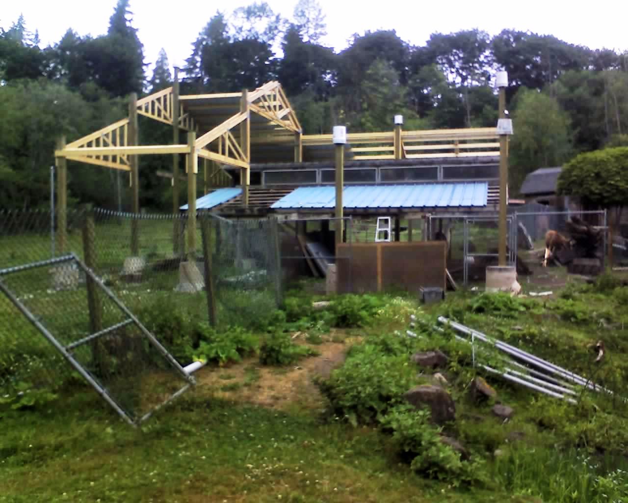

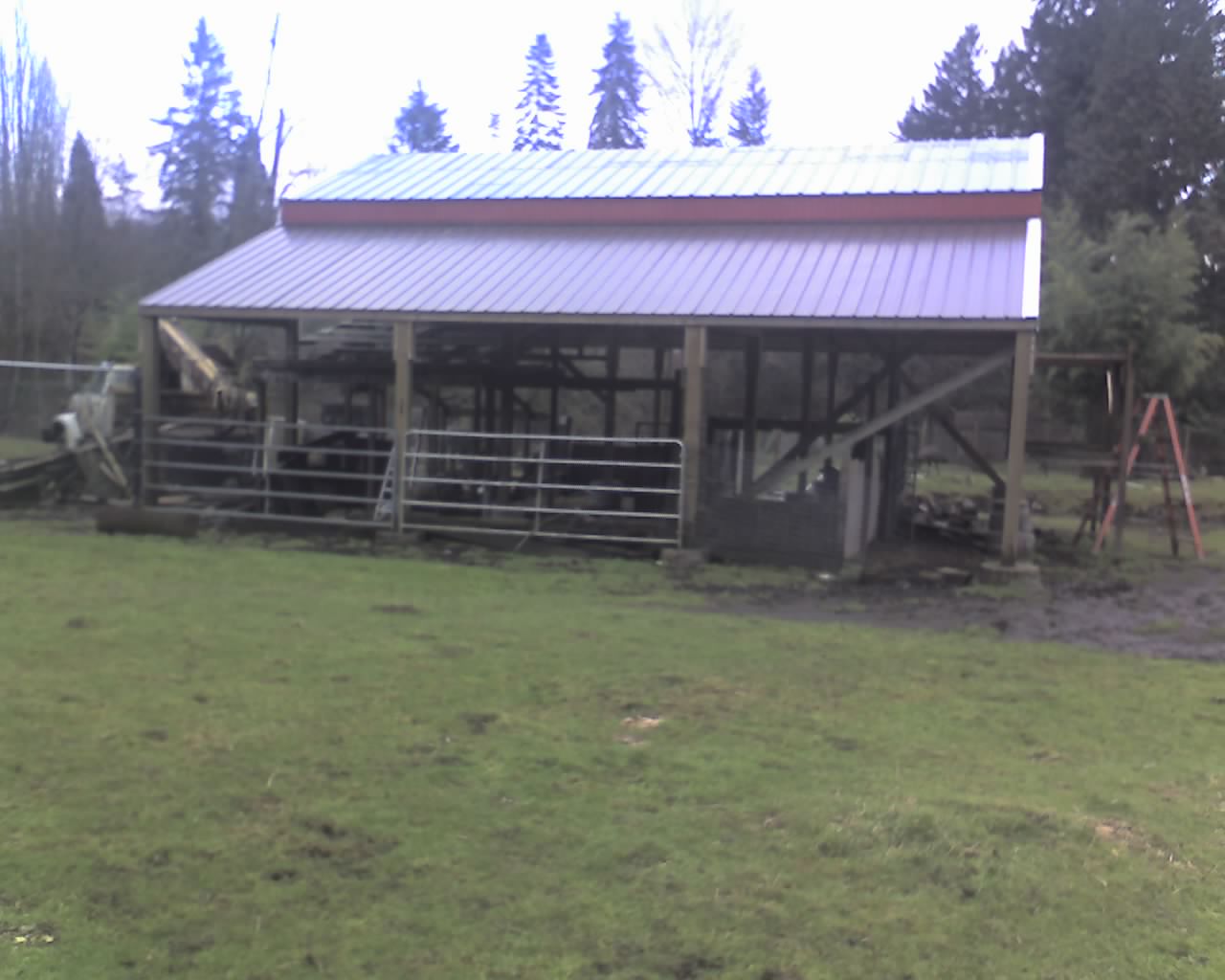

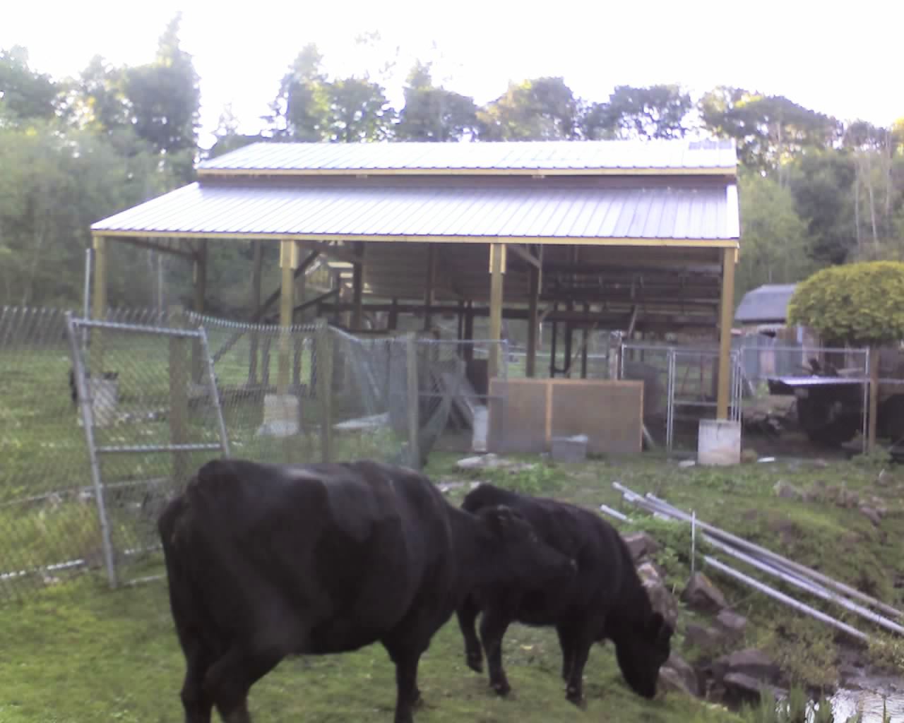

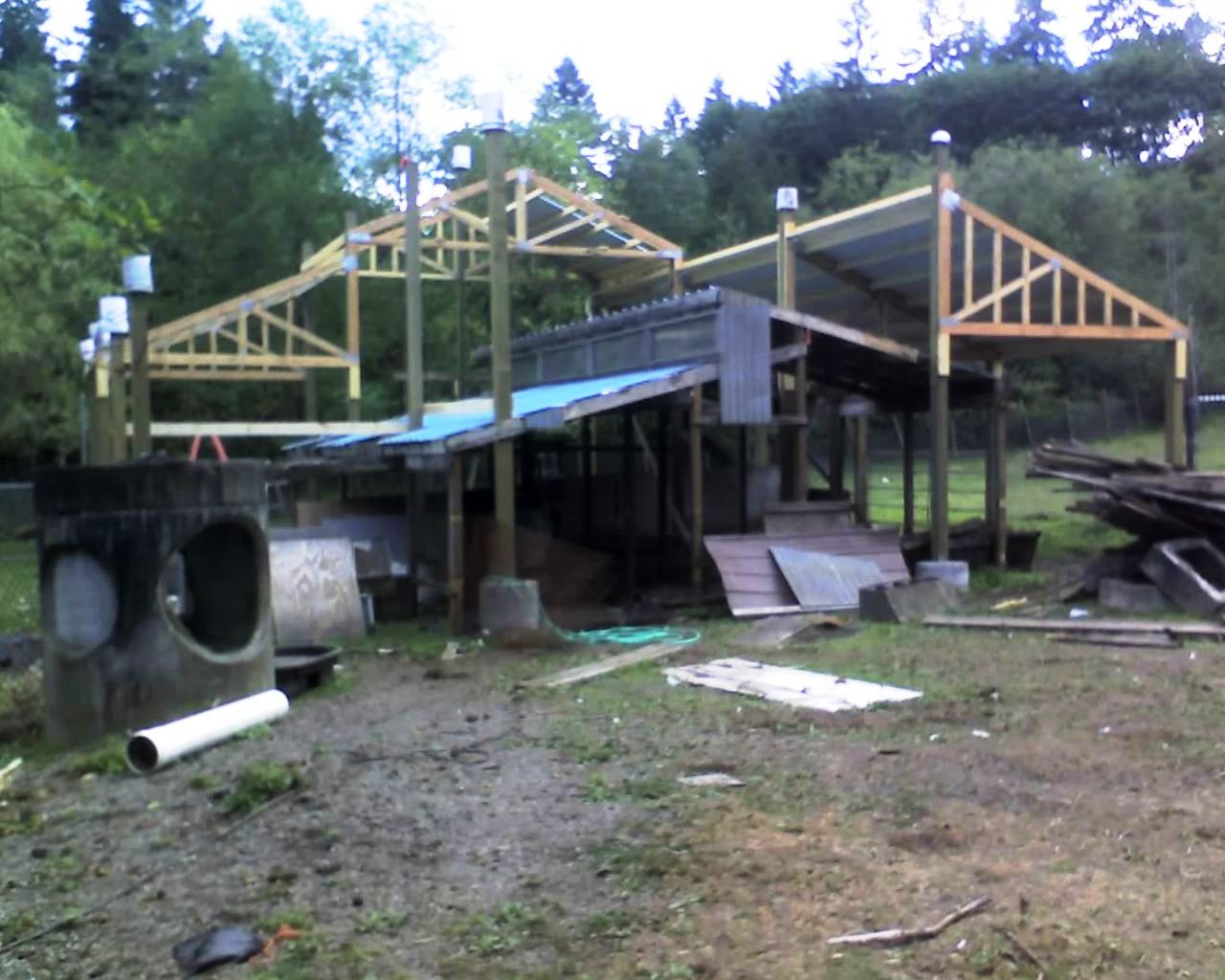

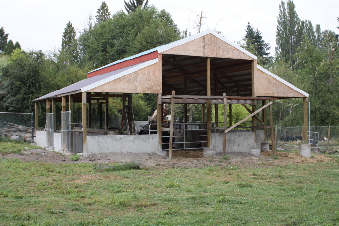

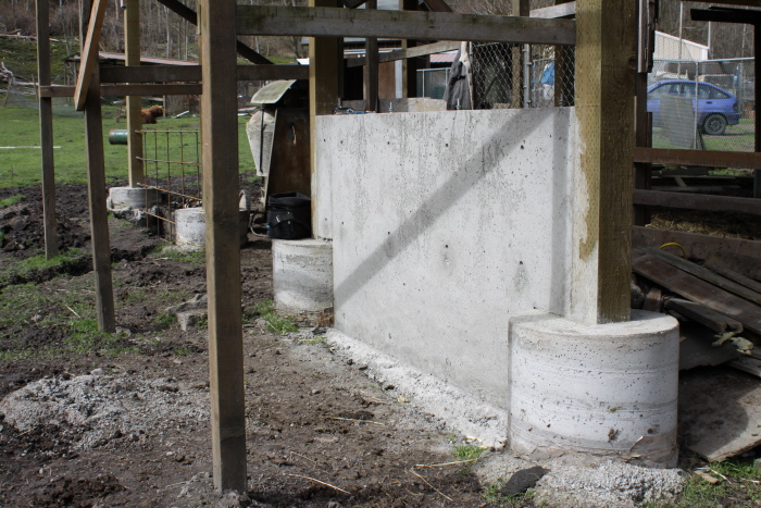

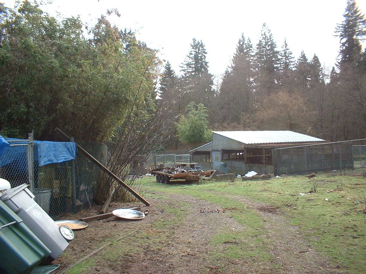

Here are some pix of the 25 year old phesant barn we've been remodeling into the new cattle barn.
Barely got the roof on the first year before the rain and snow hit.
Now 2 years and 48,000# of concrete later, we're about 1/2 way done.

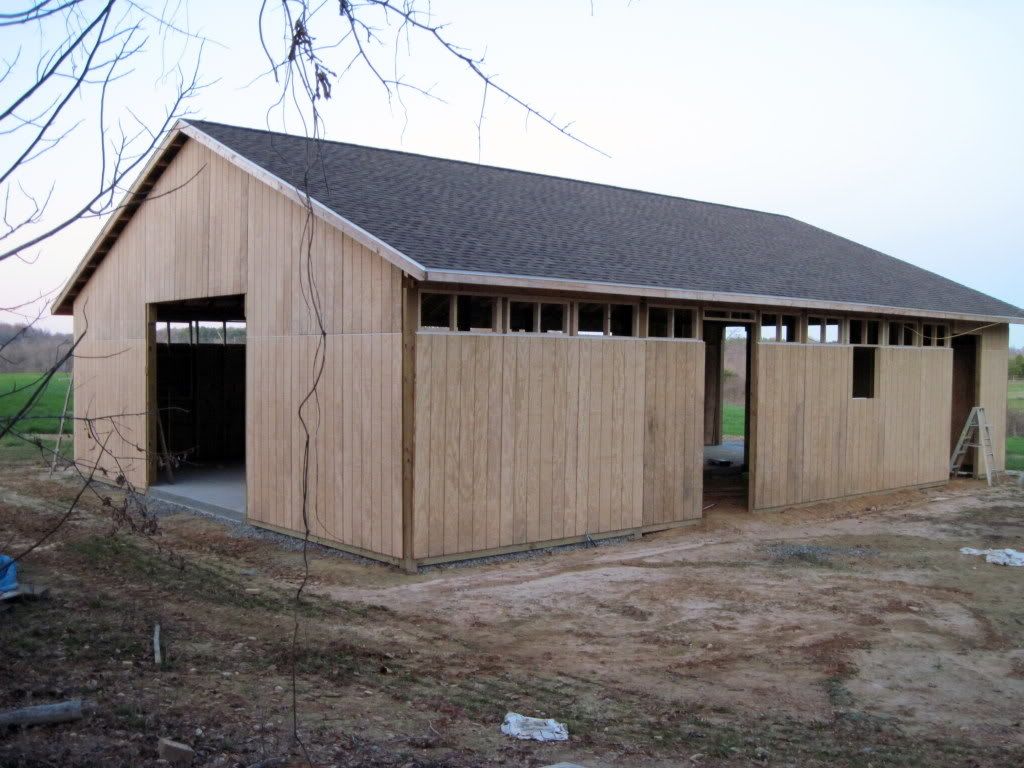

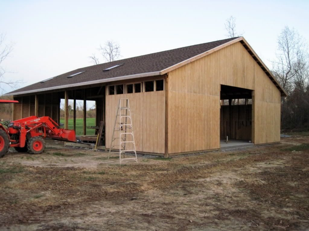

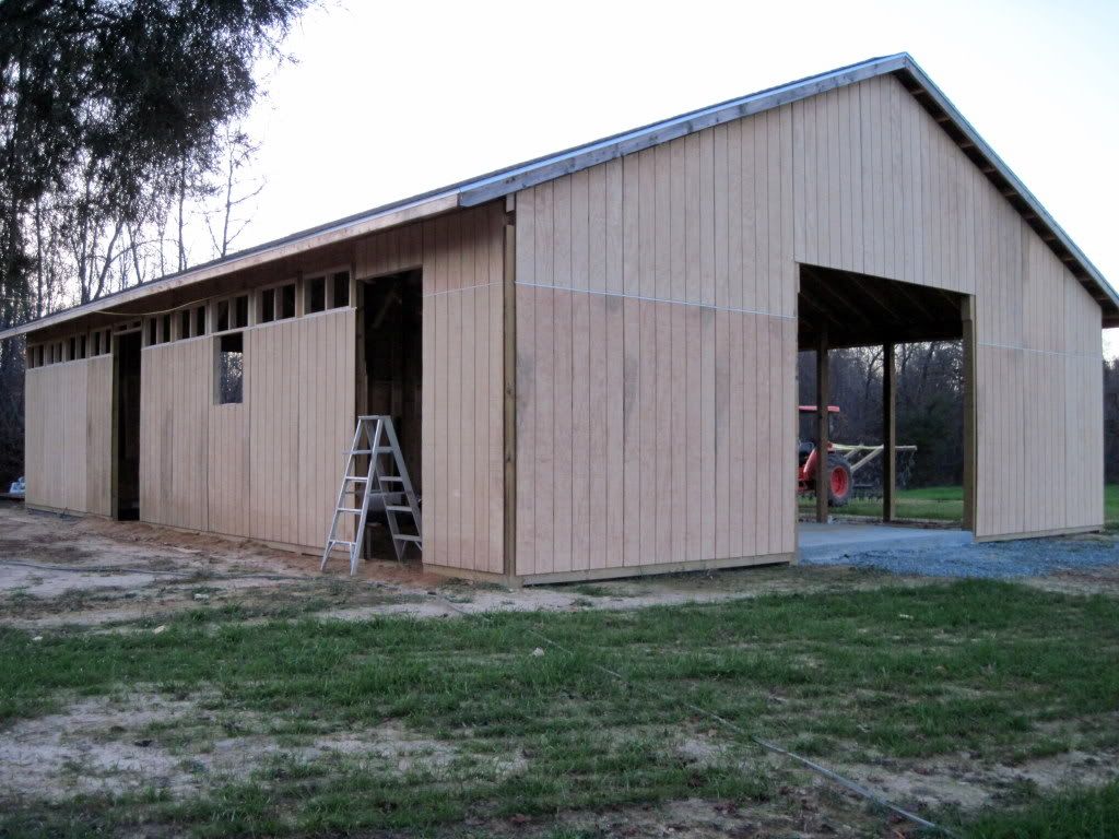

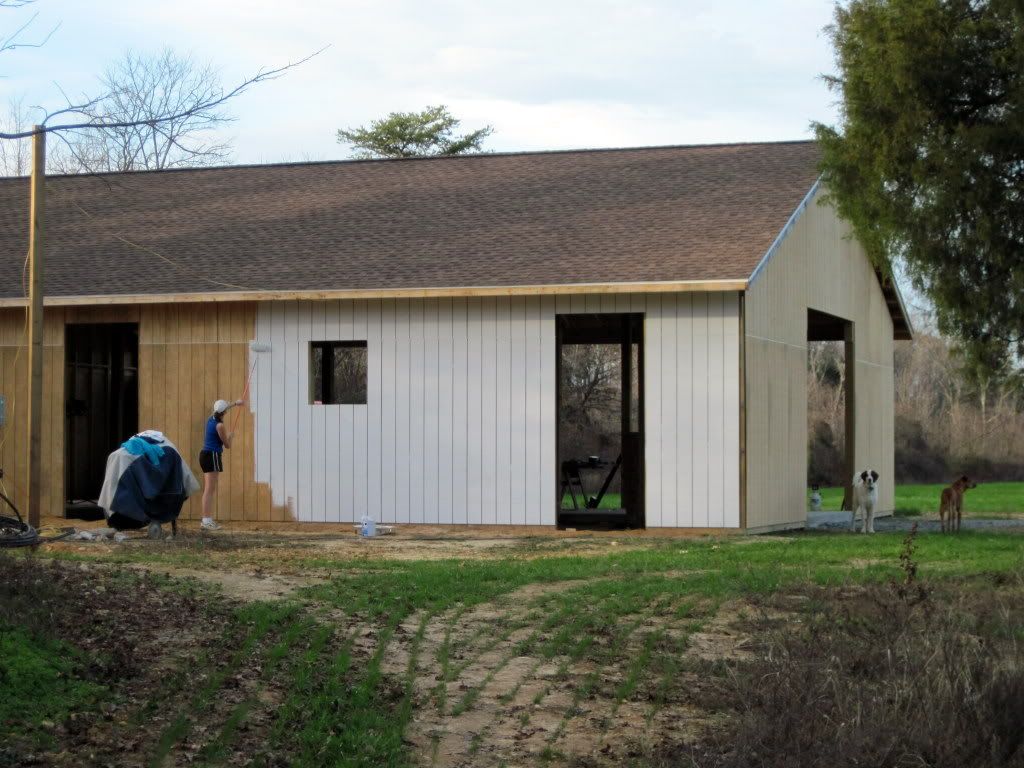

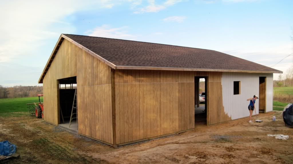

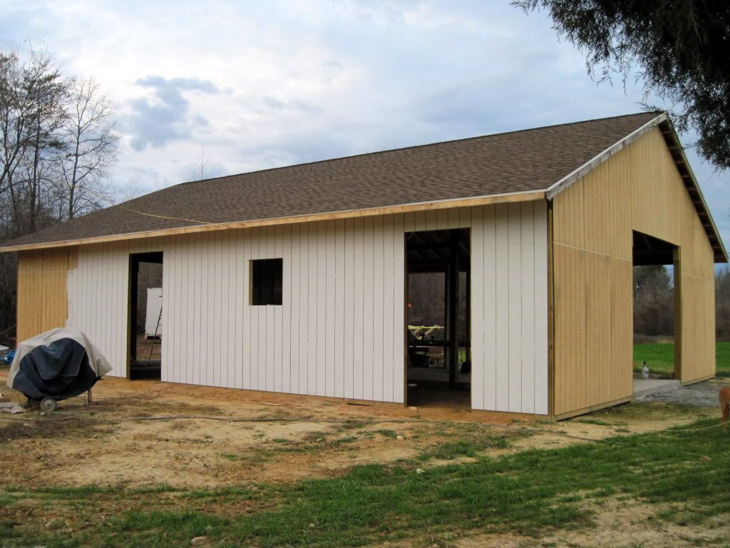

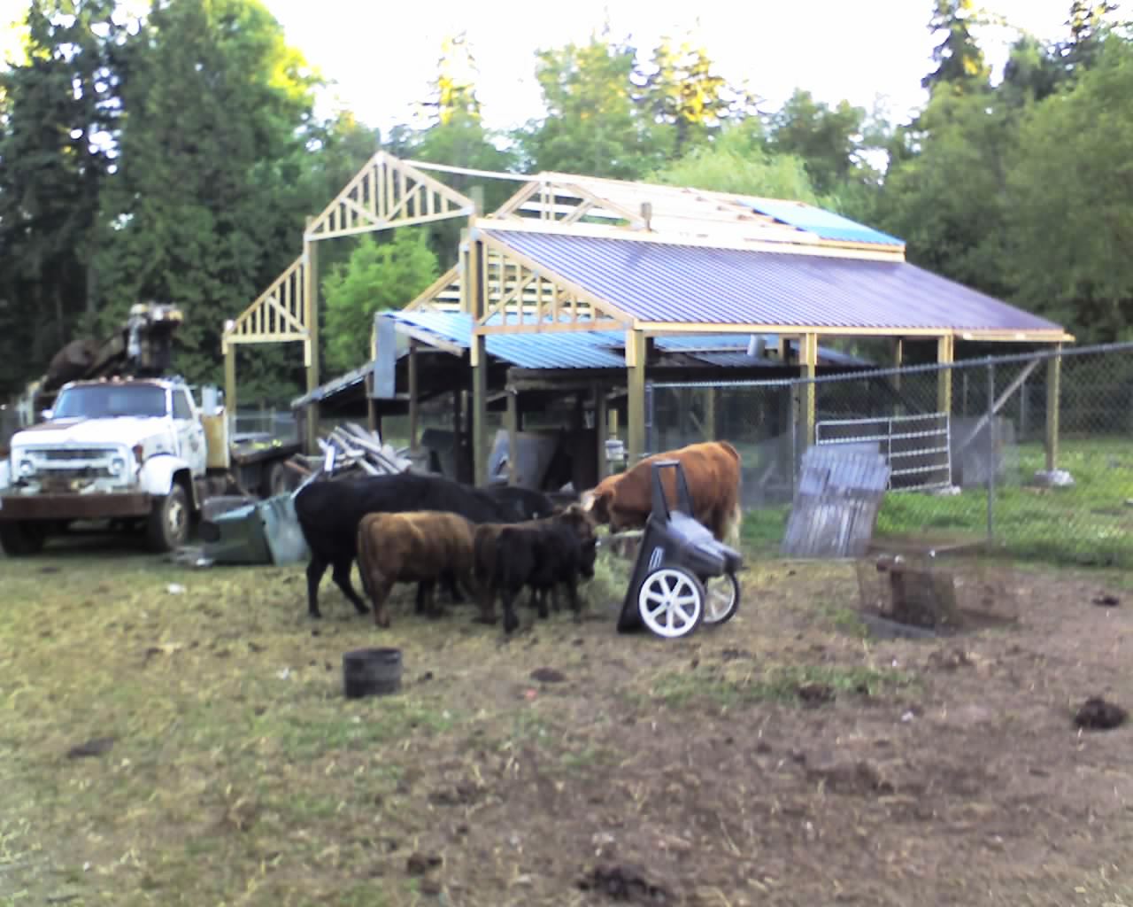

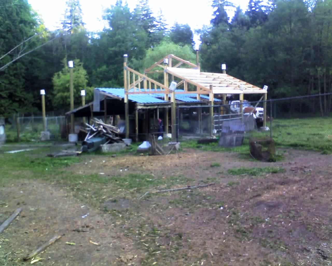

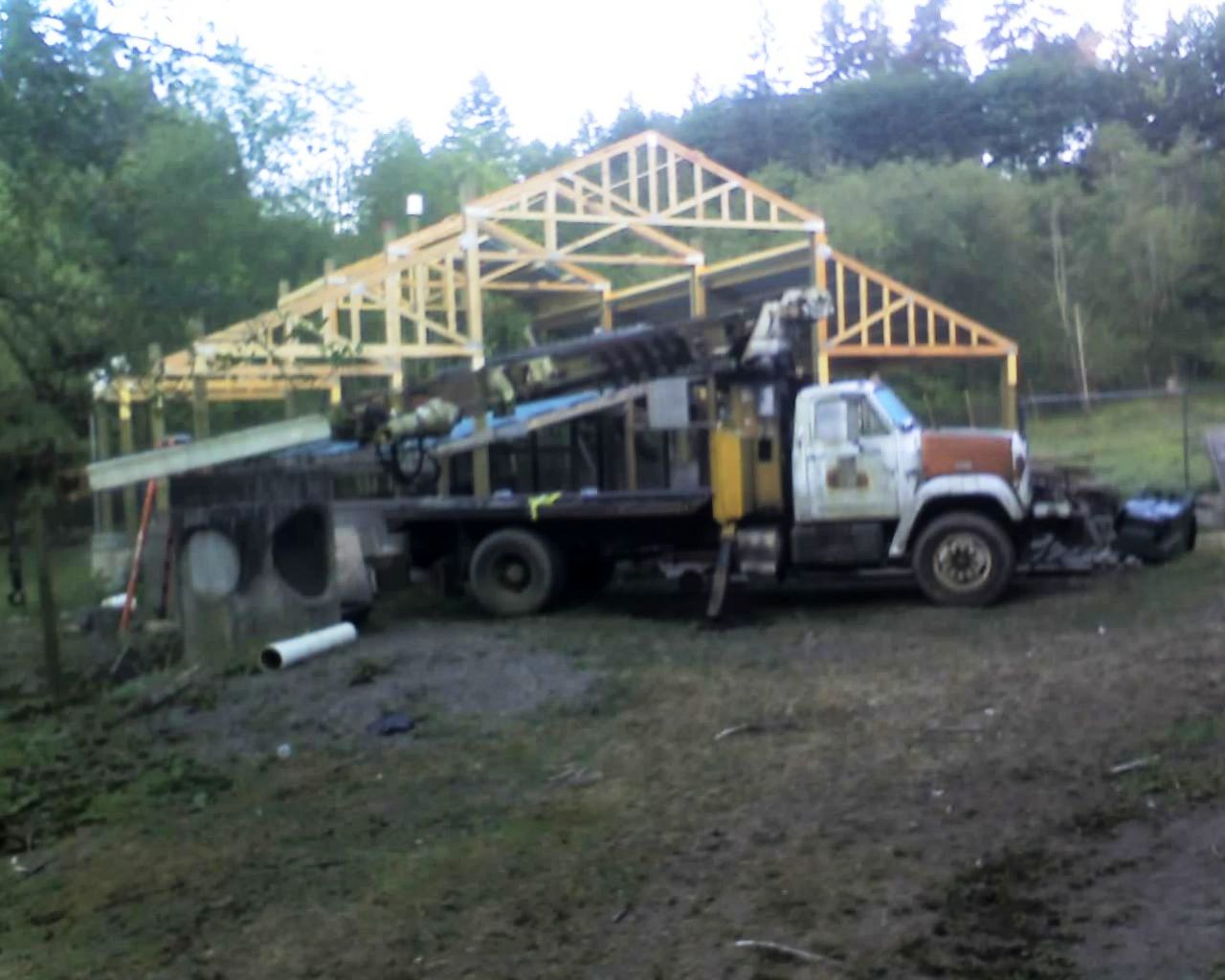

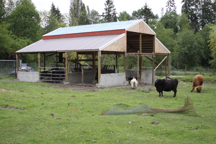

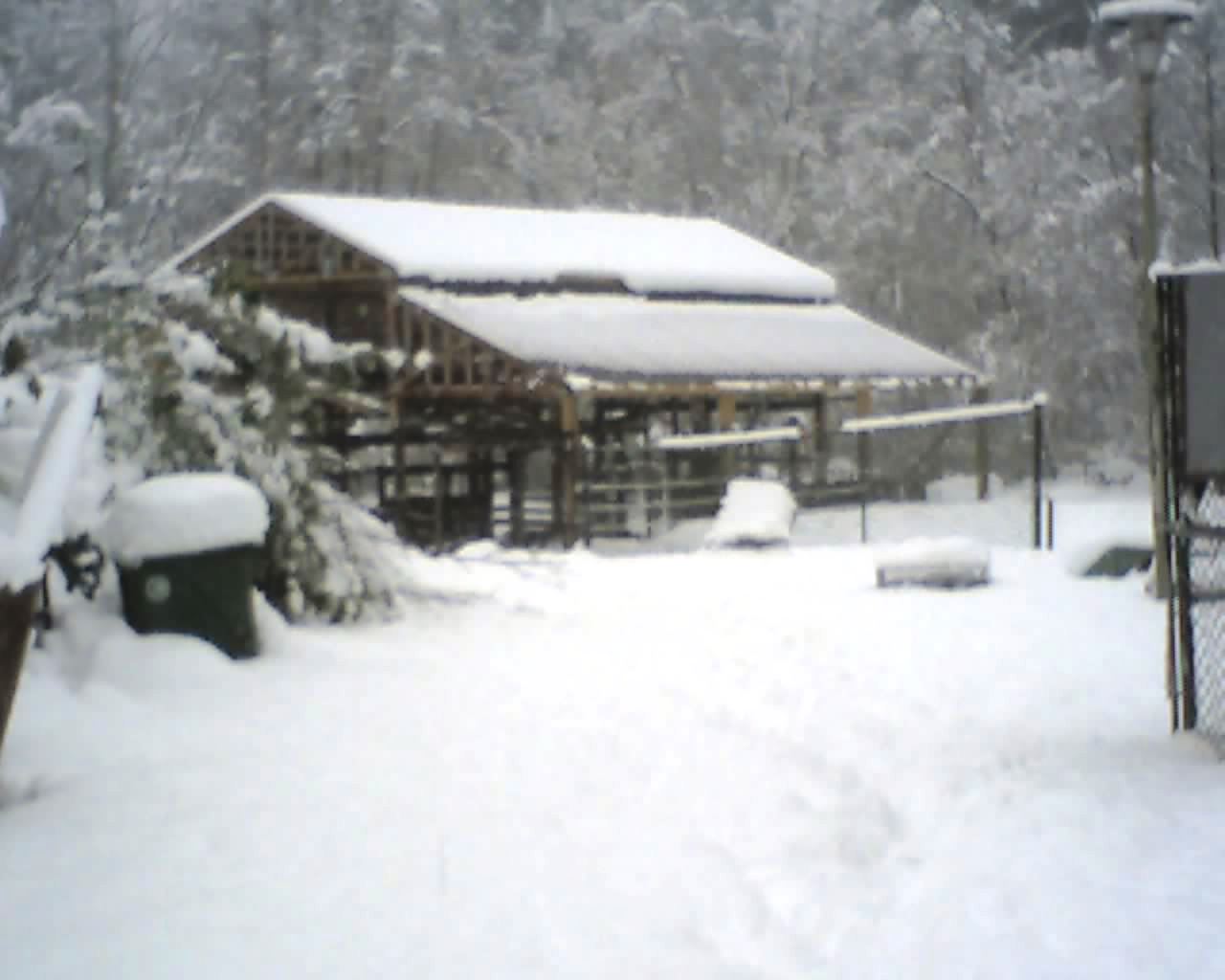

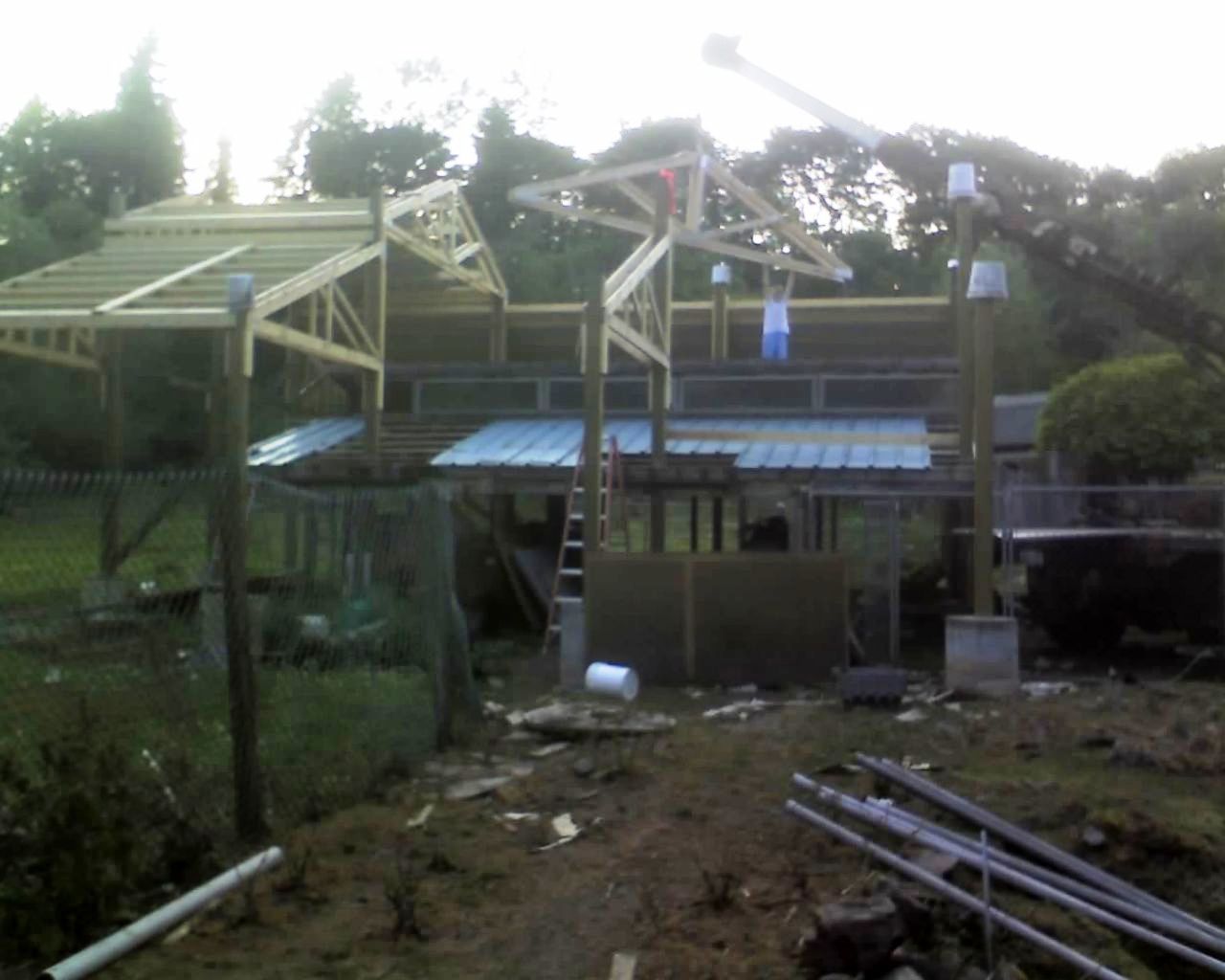

Here are some more recent pics of the progress. I've now got the sheathing completely done on three sides, and partly done on the fourth. I'm still waiting on the weather to stay dry long enough to get a load of rock screenings to finish off the horse stalls. After that, I shouldn't need to drive the tractor into the stalls anymore, so I can finish off those final walls. In the meantime, the wife has started priming the T1-11 that's already up. Hopefully we'll get enough warm, dry weather to finish the paint in the next few weeks.
I have several window openings framed out, but I still need to cut out the holes and install the windows. It's a little tricky installing windows in T1-11. At this point I'm planning to just nail the window flanges to the outside of the T1-11, peel and stick the flashing, then cover the perimeter with some well-caulked wood trim. Anybody have any suggestions/improvements to this plan?
   / My Horse Barn in Progress #40
your build looks great!
Id suggest you get a air less sprayer it will save you in the long run save a lot of time and it gets paint in to the wood cracks with out braking your back
