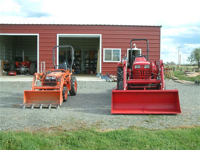

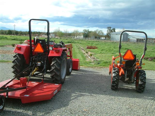

The 5525 is the big red tractor shown next to the 2005 Kubota B7510HST (the trade-in on the 5525 deal).
