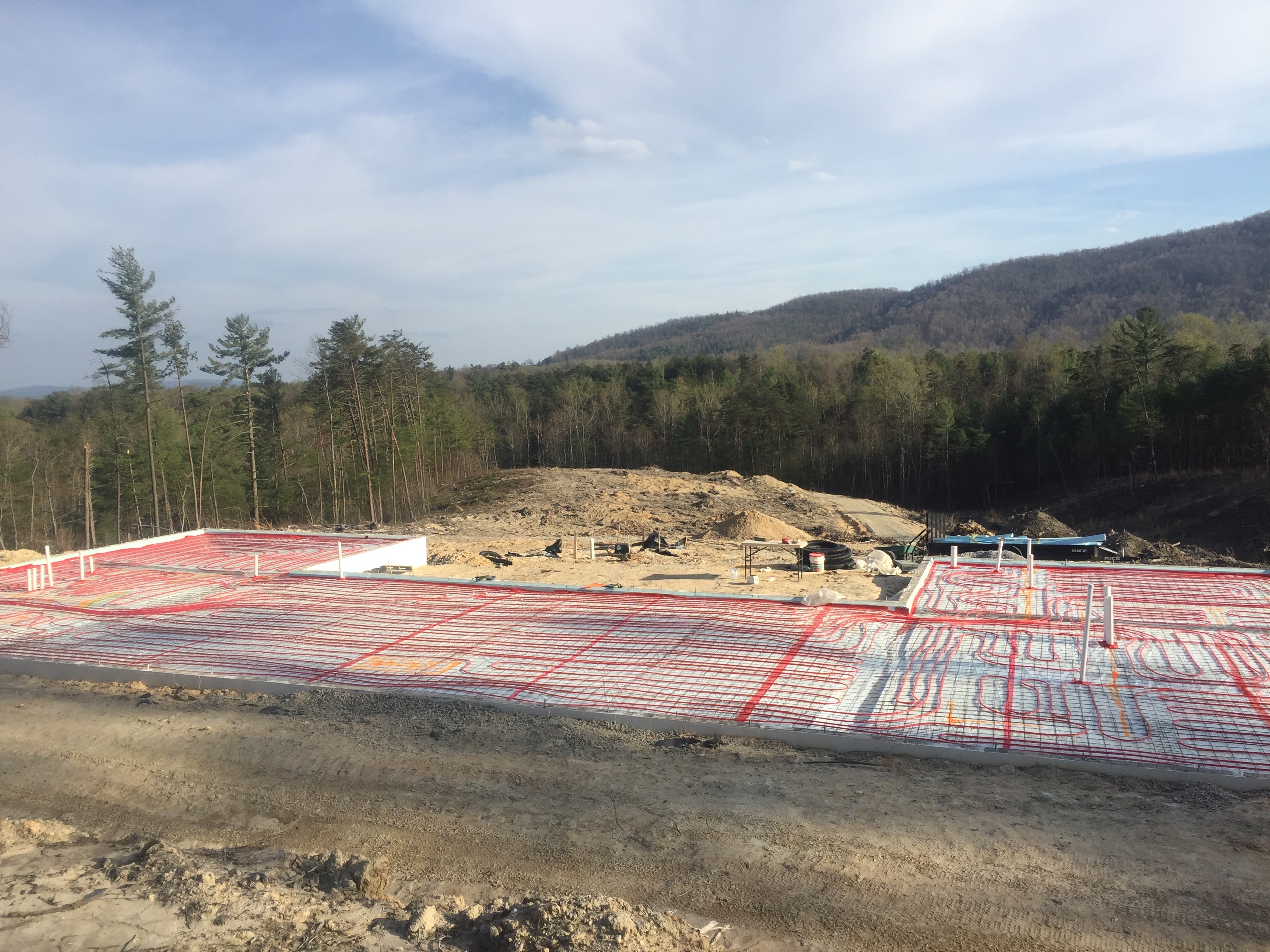

Here we are in April. cold and wet weather stalled the build for 3 full months. I had planned to be moving in by summer. We decided to rent a house near here for a year. It will give us a base of operations closer to the farm and allow us to put our house on the market sooner. This seems to be a good time to sell. The big wind storm that swept thru our area a month ago picked up all of the insulation and smashed it to bits in the trees. We spent two weekends cleaning it up. much of it was more than 1/4 mile away. Two trailer loads for the dump. We got new material delivered and about 2 weeks ago, my cement guy had his crew up here installing the insulation and the wire mesh reenforcement for the foundation. I took the week off last week and installed 3300 feet of Pex tubing. I hooked up the manifolds last night and pressurized the lines. They have held nicely. Inspection is scheduled for tomorrow morning. Right now we have a massive down pour so it should be a nice sloppy mess and basicly a shallow swimming pool that I have to drain from the foundation. We got the Well drilled a month or so back and it produces nice, abundant water....so I am told. I have not yet been able to get the temporary connection wired up for it. I'm waiting for my Excavator to come back from the shop so I can restore the hill that the well sits in. Once again, it appears that things are starting to move.
