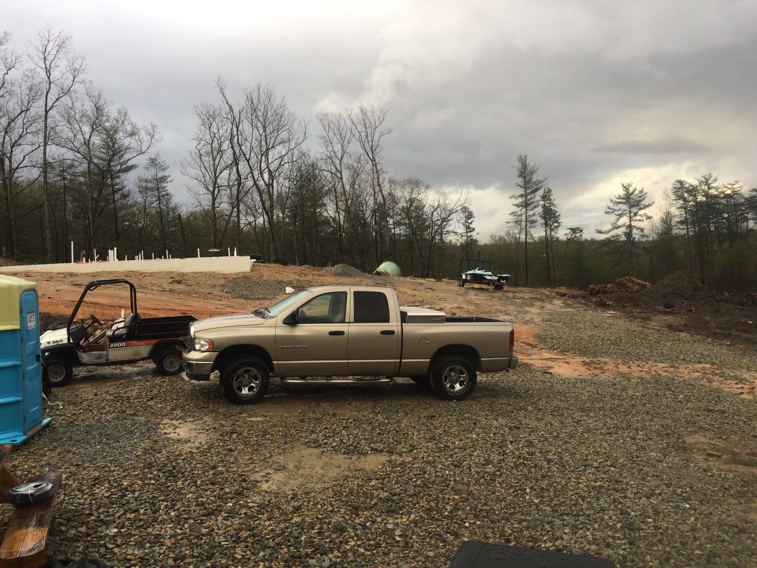

So i stepped out of my camper this morning at 7 to see this.
That is my fancy septic system. It was empty and the rain floated it like a cork. I called the installer who told me i should have put some water in it. Well now i know.

OK that settles it.
Write a book! You've got the pictures!

OUCH. I've heard of this happening, but mostly with fiberglass swimming pools. Every septic tank that I've ever seen was concrete. Seems like the installer should have either had a strong talk with you about filling it with water before he left, or he should have filled it himself. Either way, he should fix it without any additional charge.

Your guy should have given you a "heads up" on that situation for sure. He know's better and should help you out.
It's mostly dirt work & labor with a few bucks worth of PVC hopefully. I wonder if you'd be better off filling it or just putting in a quick drain to daylight in the gravel bed that I imagine it sits on? Looks like your grade would accommodate it in 40-50'.
I've heard that even concrete tanks will float..... a much worse repair. (looking on the bright side) Like you said, Forward:thumbsup:

Yea, installer should have told you about an empty septic.
