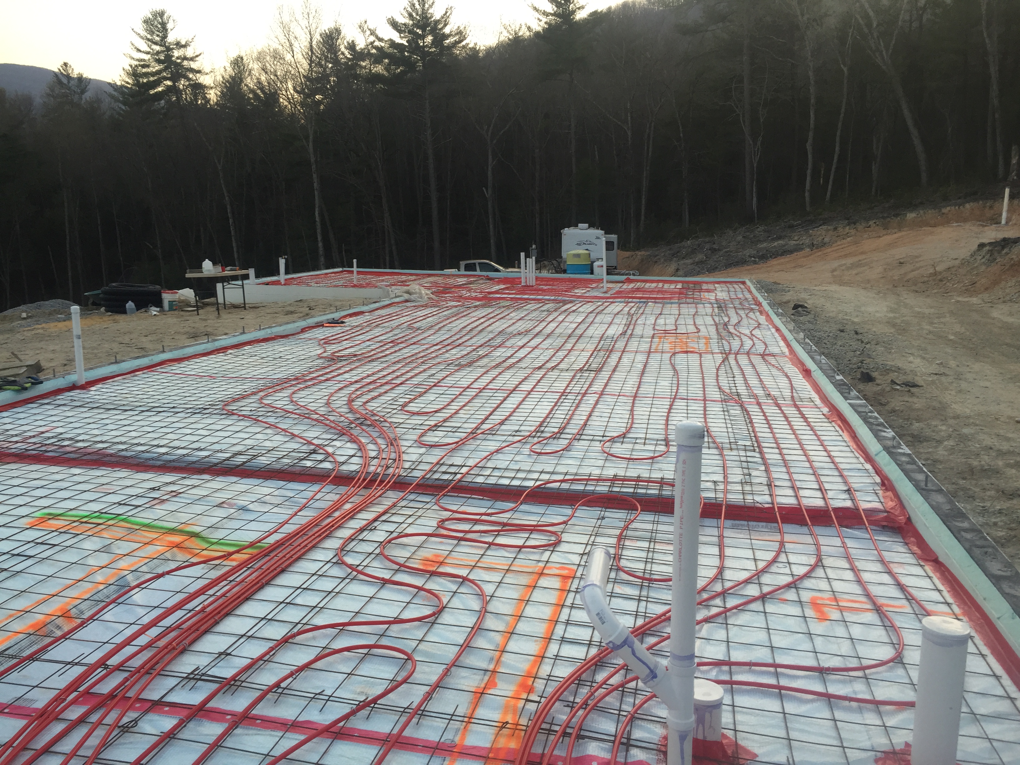

The weekend was disappointing. I appear to have lost my notebook that had all the measurements and notes for where laid the pex tubing. So I spent a fair amount of the weekend going thru photographs, marking the layout of the pipes on graph paper . Fortunately, the wire used was on a 6 inch grid, so it provides a lot of visual information as to the layout of the pipes.

I have Pex in concrete as well, and sometimes need to know where the lines are. So far I've been lucky, but always looking for some better way. One thing I've considered using is a thermal imaging camera or thermal imaging gun. That might now work so well until you heat the slab, but then again..... ??I haven't tried it. Seems like it might. Worth thinking about.

I would highly recommend construction adhesive and as few fasteners as possible into the concrete. You are just asking for it otherwise. I too have PEX in my slab and I basically only drilled in for anchors at the ends of each wall, and maybe one in the middle on long walls. The construction adhesive will hold like grim death once it is cured in a day or so. I kept a lot of photos and measurements but it is soooo easy to screw it up that you want to do as few penetrations into the slab as you can. You just need to be a little careful that you don't smear it onto finished surfaces while setting the wall.
