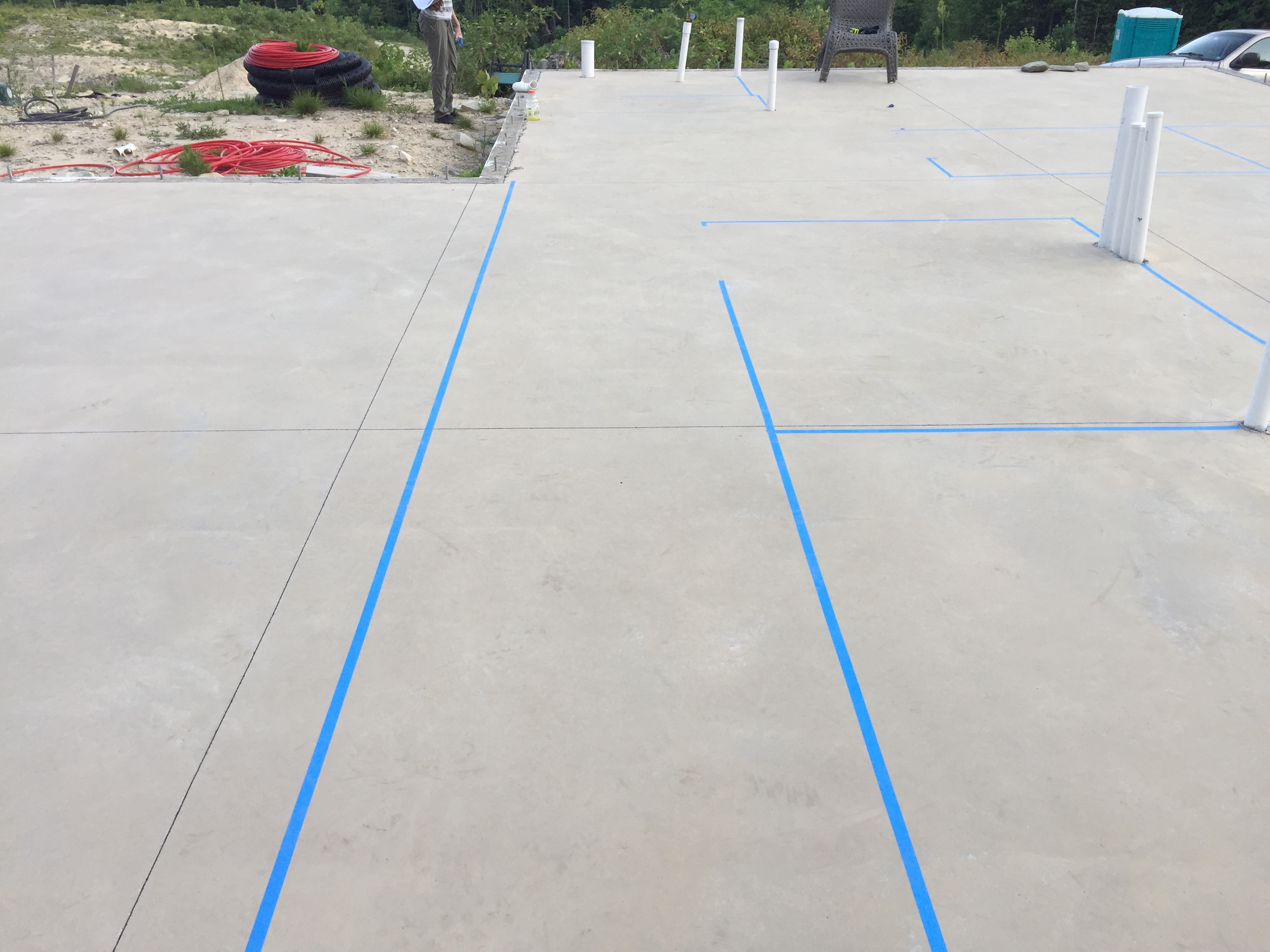

Last weekend we taped out some lines before our compressor problem.

I've never used tape to mark out a wall before. A string chalk line gives a perfectly straight line and it's a lot faster and cheaper. I always start with the exterior walls and do 12 foot sections at a time. That way it's easy for me to stand them up by myself and lock them into position.

I had the chalk string in the truck but my wife asked if we could use painters tape so she could “see” the lines of the house. She has poured over the building plans but can’t envision it when she stands on the slab. So I taped out the lines for her. As I move forward I am sure I will use chalk for some of it.

When my clients ask me where the walls are going to go, I lay down 2x4' pretty close to where they are going and then mark on them where the windows are and maybe write on the slab with a pencil what each room is going to be.
Tape sounds like a great idea, I just never thought of it or seen it done.

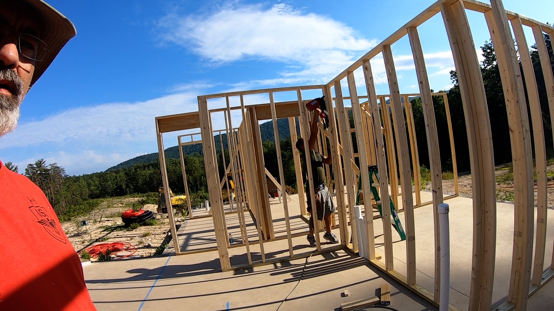

My son in law came today and I basicly stood around and watched him work. He looked thru the plans when he got to my house and asked some questions. We got to the homesite and he asked some more questions, pointed out some things that I did "diffferent". We chalked the lines, and he started rolling. It was freaking fast. He also didn't use my miter saw, but cut all the studs by hand with the skill saw.
