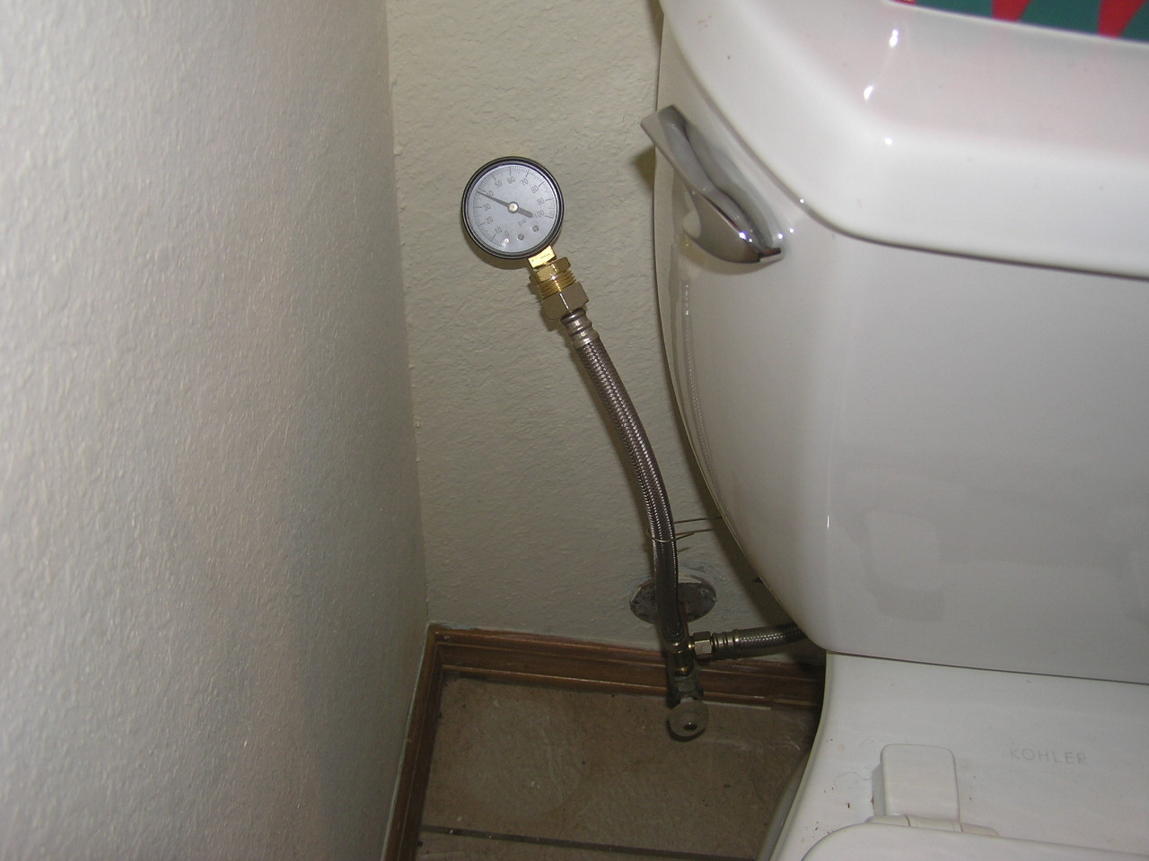

Don't forget a water pressure gauge in some easily viewed place.
This is what I did:
